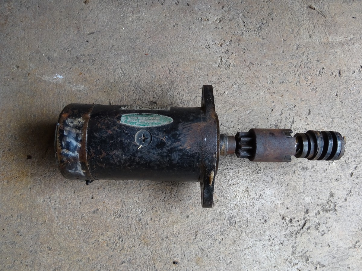

I haven't been able to drive Donkey for about a month or so as he has been having starter motor issues (been playing up for about 18mths)
I bought a spare one for $50 at a wreckers in Adelaide while there for the 2013 Nats and decided to fit it about 2 weeks ago.
Unfortunately the starter motor doesn't seem to want to spin up too well (was told it was pulled out of a 65 sedan in 1997 so may need pulling apart for a clear up maybe ??)
Anywho, I needed to get Donkey sorted ready for my roadtrip to Tamworth in 3 days time so I have done the unthinkable........
I pinched the starter motor out of the Wasp :o
I will now have to try to find someone who can rebuild old starters now as my backups all seem to be un-usable

Hi Sticky.
I've got a couple you can have a look at and see if their OK. I don't think I will need them as all my cars
have the late model starters in them. I'm going to Toowoomba next Saturday and I could drop them off on the way.
This OK with you.

Sticky.
I can drop then off to the Orphanage. As long as we are discussing the real early starter with the external Bendix drive. :|

Yeah mate the early type starter like this

Suspect starter is a no go. The terminal for the battery lead not insulated on end plate. Looks like it has
had a cold chisel applied on the main body a few times and damaged the terminal. :o Brushes not square (about 70 degrees) and if were cut to square would be undersize. Commutator leaves are damaged. Probably arcing on end and a great big short.
Number 2 starter fair. Cover for brushes not aligned correctly letting oil and junk into it. There was no split pin in the Bendix retaining nut. Brushes to a minimum. Bendix frozen on shaft. Cleaned the end plate and Bendix spiral. Like I said. Fair.
Number 3 starter good. Doesn't look like it has done much work for its age. Bendix was frozen but didn't take much to release it. Brushes are good. Still a bit of meat on them and the commutator looks good.
I've got nothing to test these properly but I'm going to drop off 2 & 3 for you to play with. I didn't bother reassembling number 1. Leaving it for another day, another time.

Can an old Lucas starter be used? Or is there anything interchangeable?

Now, if all that doesn't work, I have a bunch of them. I had 4 in a box, but then I got 2 more in my most recent aquisition. Then I opened the boxes you brought me from Davo and there were 2 in there! Thats without raiding the parts donors. ;)
Thing is, I've never managed to wear one out! Shrek's was noisy and grindy when I got him, but I just used it a lot with short paddock work, and now it spins up fine.
Luke.
Both starters look physically the same. The Isuzu Minx would have been a template for the starter on the wasp and any 3 bearing sedan. Have been looking at a Morris Minor in the past fortnight and I thought as you have. Will it fit. Looks the same. Are the bolt holes the correct distance. Is the diameter on the end plate right to fit into the engine/transmission plate. Next time I'm looking at the Morry I might start taking some measurements. Nothing short of removing it really. Although my friend might burr up a bit if I do take it off.
I may have an answer sometime this week.
