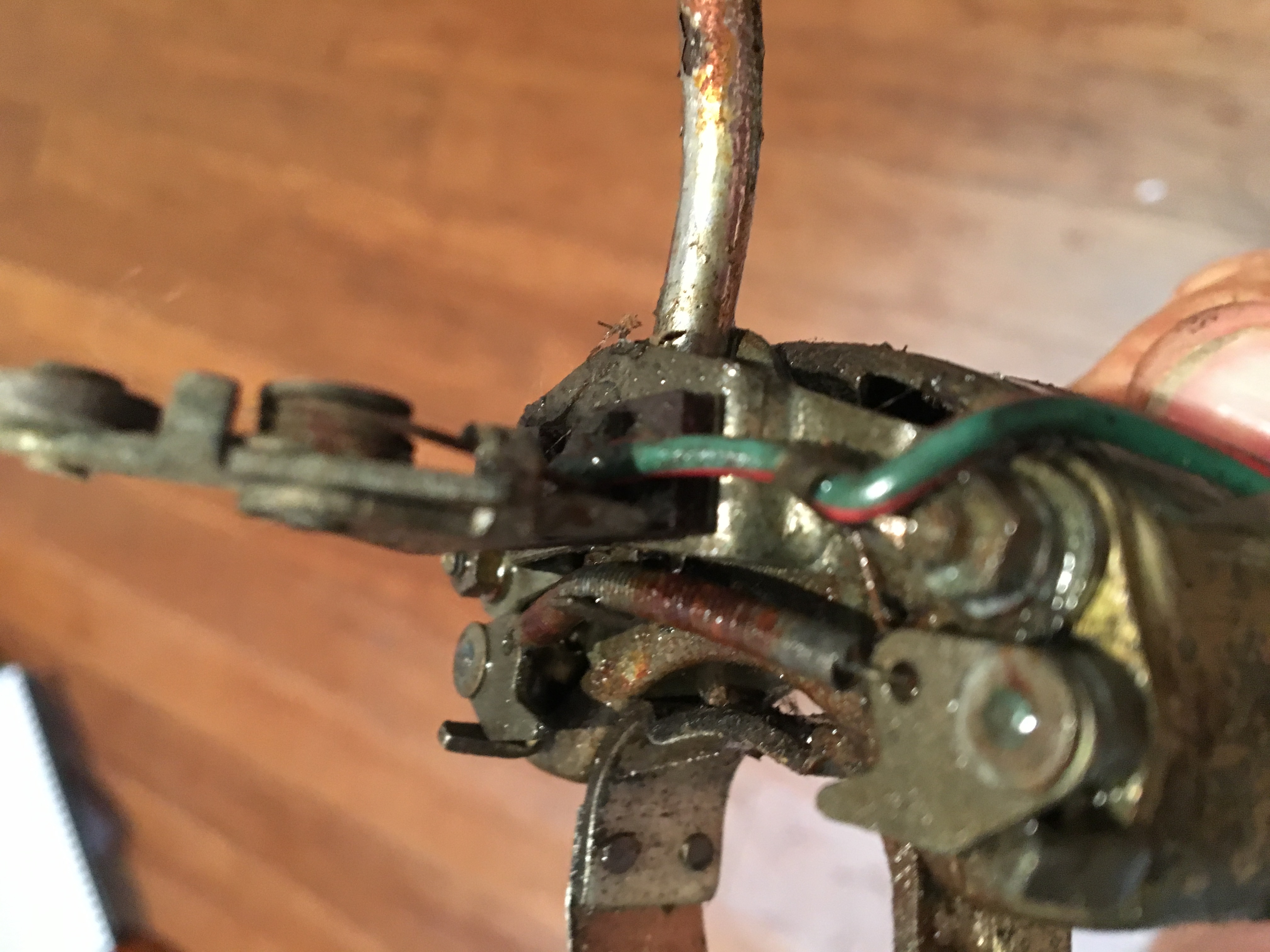

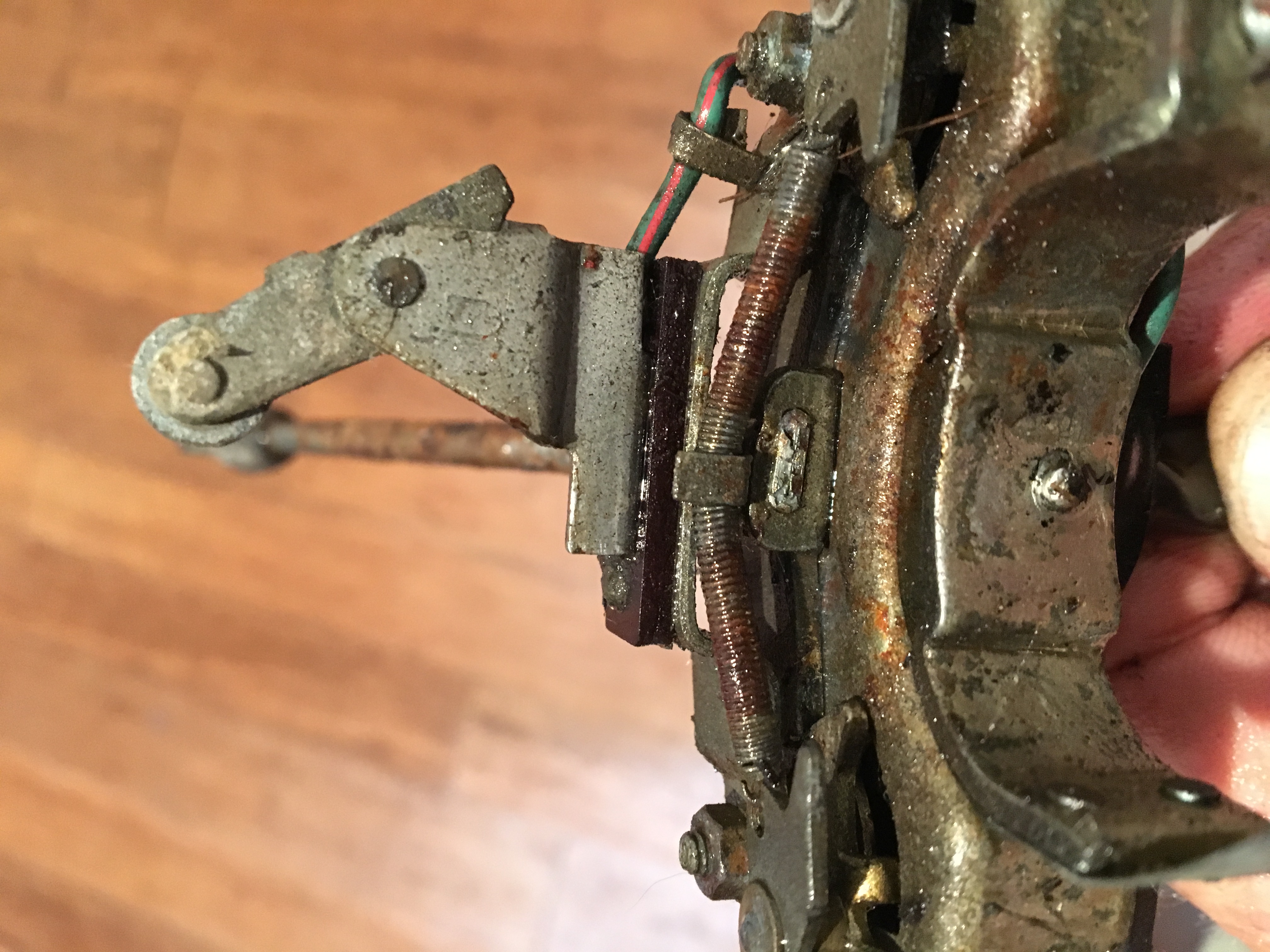

The day wasn't perfect, somehow the turn signal switch stopped working. It does not lock in turning right position. Is there some kind of spring which should keep the switch in position?
I hope it's not too difficult to fix it.

Hi this is how it should look for the blinkers. Does it make sense cheers dave
Mon Dec 04, 2017 2:26 am

My turn signal switch seemed to repair itself overnight. But I should probably clean and lubricate it a bit.

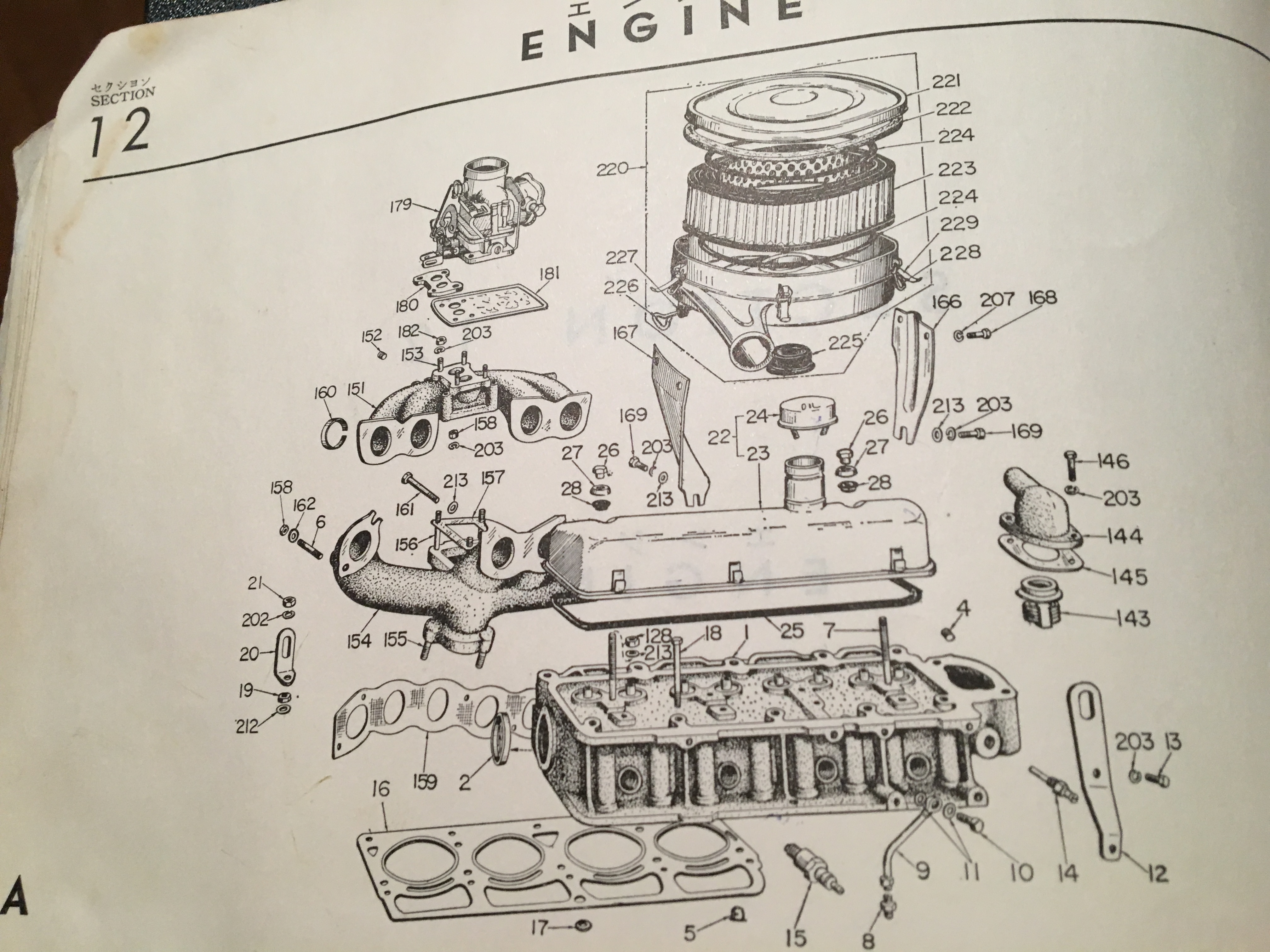

What does this lever under the air filter box do?

The lever under the air filter box simply unscrews anti clockwise to remove the air filter box from the top of the carburetor. There should also be 2 supports bolted with 2 bolts each support that will need undoing either at the filter box or where the struts bolt to the engine where there is 1 bolt each strut.
Thu Dec 14, 2017 1:34 am
Looks like this number 226 is the arm that releases the grip on the carny throat Cheers davo

Interesting is, that when I tried to start the engine yesterday, It didn't start. But when I loosened that lever, It started instantly. At the same time, the airbox cover was off. I suppose it was just a coincidence then.

You should have a earth cable from the negative terminal on the battery to item 169 in the engine picture. I cannot see it in your pic of the lever under the carburetor. If it is there tighten it up. Could be the reason why it would not start and you played with the lever and it started.
You can make a tappet cover gasket from sheet gasket material. Trace around the outside of the cover with a marking pencil. Measure the width of the old gasket and mark that width on the inside of the traced mark. Cut the inner mark first then the outer. If you cannot get the correct thickness for the gasket. Make 2 and glue them together. Or. Glue the sheets together and then trace and cut. Depends on how confident you are in making the gasket. You also may have a problem in getting a sheet material long enough. Go diagonally across the sheet.
