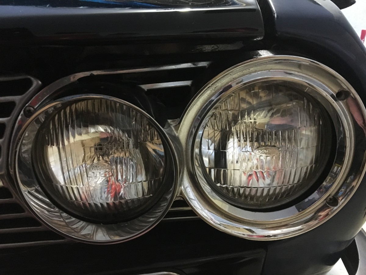

Fri Jun 08, 2018 1:38 am
Here are mine they look the same ?

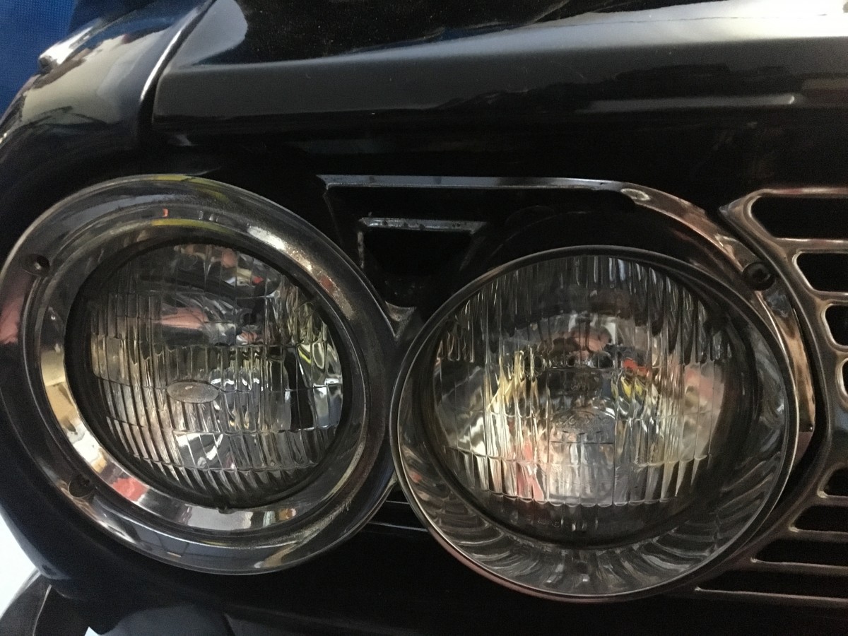

Fri Jun 08, 2018 6:51 am
The other side

Posts: 75
Location: Tallinn, Estonia
Bullitt, on your pics they are the same as my left one.
But here, on the time machine are the same as my right one.
Actually a minor difference, but still. It would be interesting to know.
