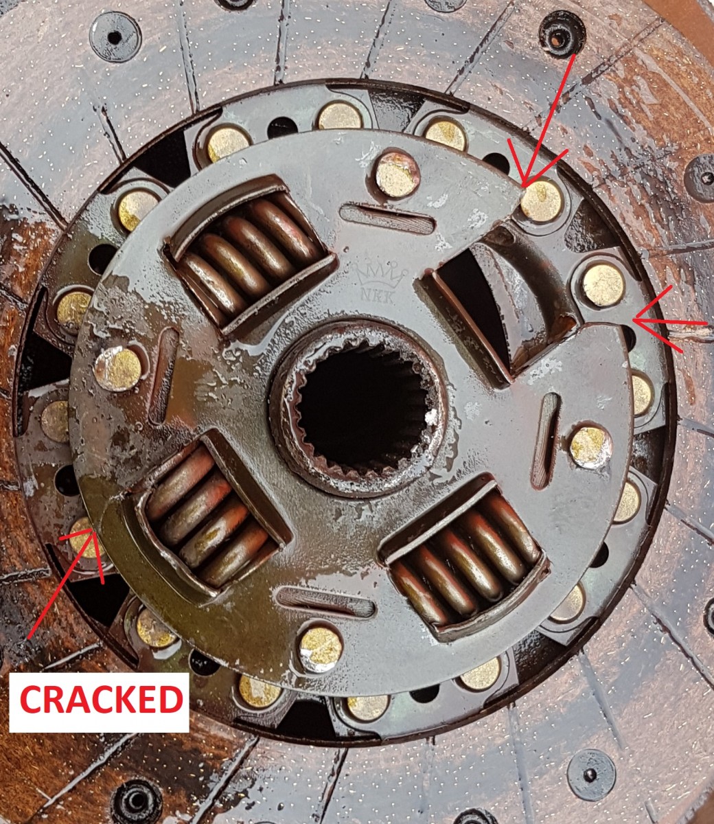

I never saw the new one, but the number was PDK42016 Kit was $165. And a bit hard to get he said.
Its not the same as a standard earlier Bellett as the internal spline count is different they told me. (Possibly Chev LUV ?)
The old one broke out one spring in the clutch plate. The whole section around the spring had apparently cracked and parted company. The one on the other side was about to go also. Fingers on the pressure plate badly worn also.
Flywheel was machined also.
see picture.

Part number is Powerdrive. According to their info the kit is to suit all Gemini with G161Z's. All KB early series, 20 to 26 4X2 and 40 to 46 4X4 with G161Z's and C190 diesel also. No listing on Chev. LUV.
However. Clutch Industries listings quote all of the above as well as Chev. LUV. and Shuttle 2.0l diesel.
Some companies from overseas that start to import and supply in Australia only look at certain models of vehicles that are current and are after a certain date. At this point they only stock the fast moving kit and the lesser models at a minimum. That is possibly the reason why it is hard to get.
I know Clutch Industries don't stock particular kits in Brisbane. But if an order is received they source the components from all over Australia and when completed send the order as a kit.
The other point is having a motor industry supplier that uses their product. e.g. Bursons and Repco. I had never heard of Powerdrive until I started to research the part number. Maybe an old company with a new name or a new International company that has started out since I left the motor industry.
This is only a touch on the parameters of "demand and supply". There can be so many reasons to manufacture and have a market available.

I had a feeling it might be Gemini although the guy said the spline count was different. Perhaps he meant compared to a usual bellett clutch plate?

Looks very much like a Gemini clutch plate to me.
It might be a different kit due to the pressure plate being a different version tho. I've seen a few with different bolt patterns.
Fri Mar 30, 2018 11:09 pm
Last time i looked at a Gemini clutch was in late 70's...... memory slightly faded these days !
If you count the splines though, according to the Clutch place, it's different to a Bellett type. And even longer that i looked at one of them.

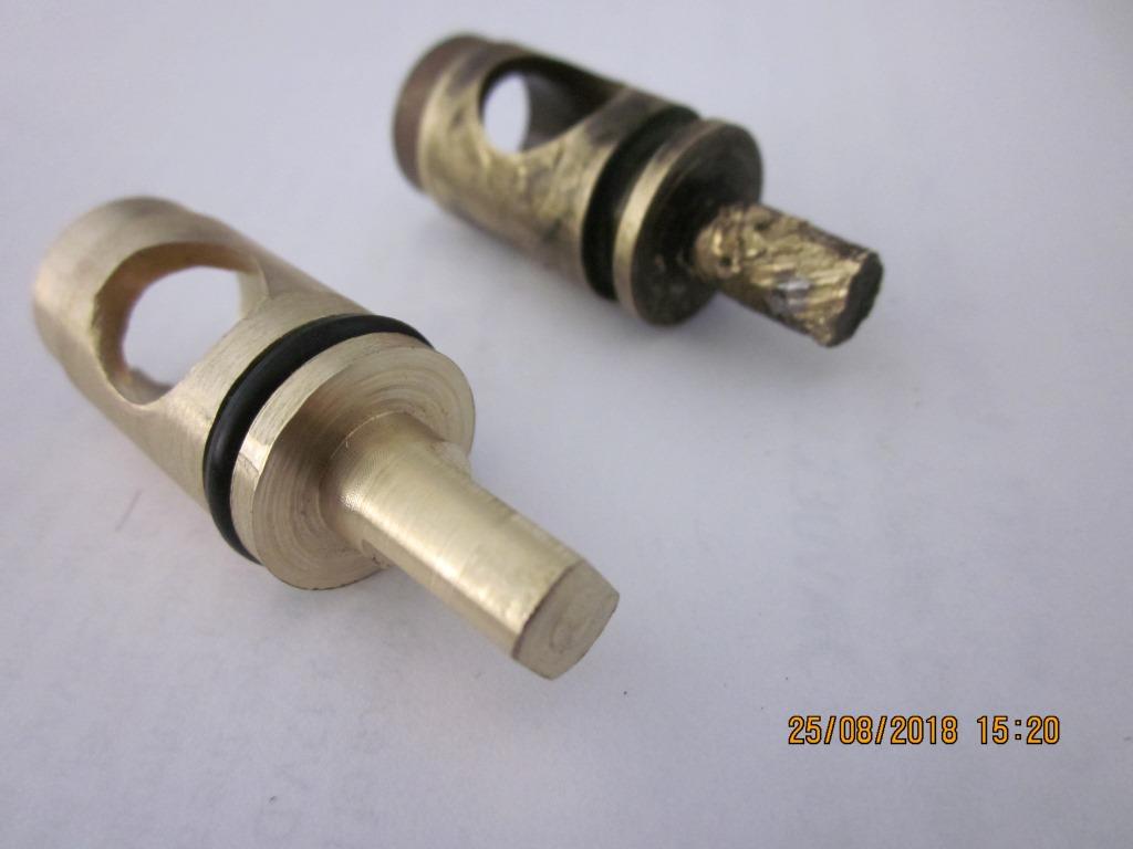

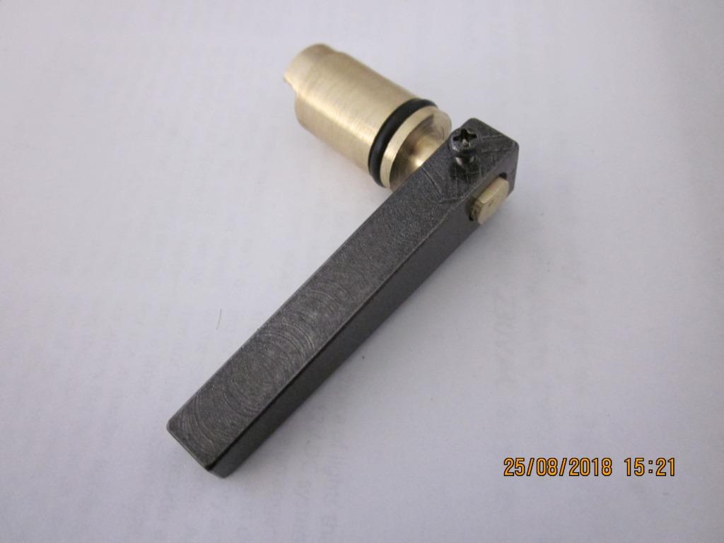

Never could get the heater to work as the tap was stuck which is pretty common in my experience. But this time, getting the old one out proved to be time consuming not to mention a crook back, while trying to work under the dash.
I eventually got it out by lightly tapping the end of the tap inwards with a small tack hammer. Just a few light blows and it started to move inwards. Then some frantic twisting/pulling with multi-grips for about half an hour and it popped it. As is usual also, the o-ring was badly cracked and worn so I went off and bought an imperial selection of O-rings finding one that fitted ok. I also tried Metric but couldn't get one that was close for some reason.
By this time the section where the handle fits (I didn't have the handle) was even more badly graunched so i decided to make a new one, since I had a bit of brass that would work. Some hours later, here it is.
Just have to put it back and try and fix the tap in the radiator. Actually there was no tap but a Nylon plug put in there with a totally different thread on it. Have to sort out something to replace it with. My question to the group, is the thread a tapered thread and size?

Have a parts listing showing that there was a change in the drain cock (tap) in May 1969. There is a packing (gasket) added to the list which gives me the impression that it is a straight thread. Also. The new cock will not fit the old radiators and vice versa. Design and manufacturer change.??

Thanks Dave. Interesting as that's what i seemed to have found. There was a Nylon screw in it with a wing nut protrusion that was forced in as i had to use pliers for every rotation to get it out. Not easy in that confined space. A thread gauge showed it to be different to the radiator thread. Rummaging around my little Bellett bits and pieces i found an old cock and it was way too loose in the radiator.
But a better thing than the Nylon one, so i wrapped many turns of Teflon plumbers tape around it and put it in. Seems oK. And hopefully stay that way?
Put in the new heater tap only to find the handle a bit long so cut a cm off. Filled it all with green rad fluid and ran the car for about 15 minutes. No leaks anywhere and NOW the heater works great. Demister works but from memory, like my old Belletts of the past, not great.

If you get an opportunity, take your old tap into a Isuzu or GMH dealer armed with these part numbers.
ISU 9214390880. GMH 94020487. for the tap. ISU 9097205570. GMH 94020125 for the packing.
Found in KB LUV with both G161 & G161Z engines. PA Florian. T series manual trans. only. UBS Jackaroo. Chev. LUV/PUP.
If not successful I know Nissan and Hyundai had plastic taps or bungs on their cars. Or your local radiator shop.

Many thanks Dave. For now I think it's OK but I was thinking to pull the radiator and having it flushed and checked etc some time. Even though all seems fine with it, no overheating, no loss of water etc.
But I will do that, check out the numbers you give at our local Bursons suppliers. What is the 'packing' a rubber washer ? The nylon one in it had a washer, rubber but needs replacing too, partly why i used the old tap i found. I tried getting that washer but couldn't.
I could also turn one up on the lathe if all else fails, but my lathe screw making abilities would be severely tested !! Probably end up with a LH thread...........

No go on the Gemini Radiator. It looks like a replacement type where they have no threaded nut to accept the tap. While I was at it I checked my PR91 convertible and it's the same. No tap. It probably would have been the same as the early models anyway.
I went into town today for hockey training and to pickup 2 vent grilles that I had at the sheet metal shop and went round to the radiator bloke and he gave me 5 taps and told me that the tap for a metal tank would most likely be the one. 12mmx1.25. The other 4 were for plastic tanks but I reckon a couple of them depending on the thread might fit. I am assuming your tanks are metal.? The sizes of the others are. 14x2.0 with an small "O" ring on the tip. 12X1.25 that fits Nissan and 2 of 15X1.5 with different lengths in the thread.
I take it that you have a thread file and there was something left of the old tap so as you may be able to measure it.

Thanks Dave for your efforts. The hole appears to be 10mm x ?? pitch. My 10mm standard tap wouldn't screw right in so i am guessign the pitch was alittle different now. At the time i just thought it was a tapered thread in the rad.
Yes it's metal. Original although possibly re-cored.

Removed a tap out of an old radiator ['66 ?] and it is a tapered fine thread. I don't have a 1/8th gas tap at all but have a
few brass fittings. The tap screws into a 1/4 - 1/8th reducing nipple very easily and tightens about a thread from the top.
Also had a Victa lawn mower tap on hand and fits nicely into the radiator. I do know that the plugs on the side of the block
for the oil gallery are 1/8th gas.
