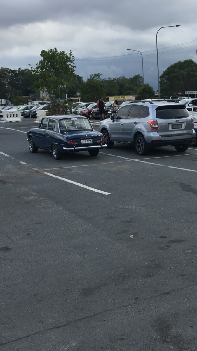

It took a long time but its on the road at last cheers and merry Xmas davo

Excellent.
looks a bit lost though next to that giant SUV.........

Looking Good Davie
Love the Venetian blind
Got to get me one....

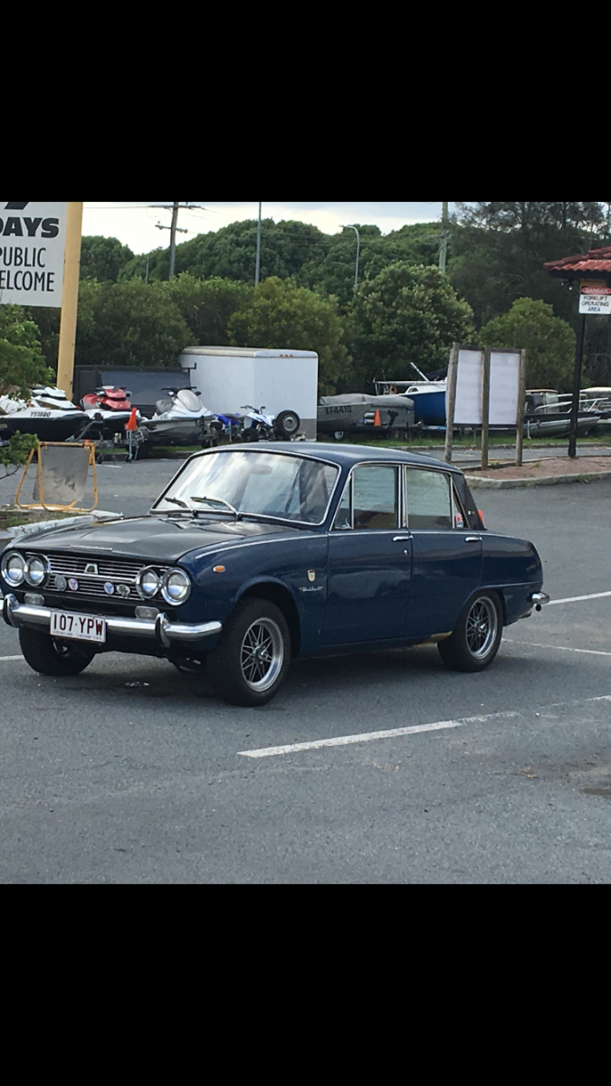

Hi guys thanks so much for all your. Encouragements it has taken too long however I got there at last funny the last bellett I actually drove was when I went to Adelaide and Dave let me drive his gt in the concourse. And that was a hoot I have the bellett bug again and now it’s on full rego can drive all the time if need be although no power steering and air and all the modern tricks makes it a concentration to steer. Ha ha it’s a long awaited experience . Here’s a full frontal shot with badges. See you on the road merry Xmas to all belletters. Cheers davo

So beautiful Davo, and great to see you out and about. Like you say, you can drive anytime, but spring and autumn suit best. Now you need to get to the Nationals so she can meet all her cousins.
