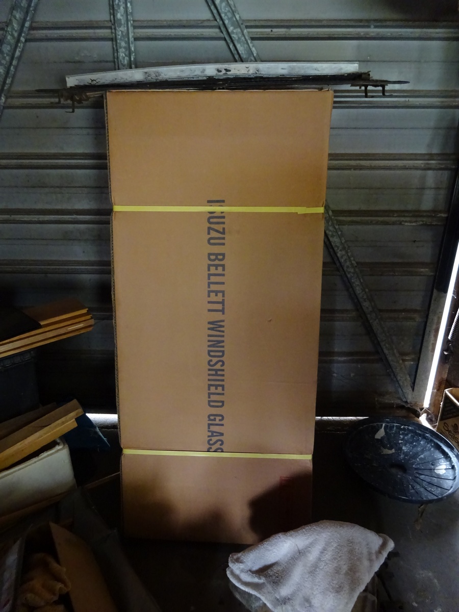

20. Brand spanking new GT Front windscreen Check (I've got 2 of them actually 8-) and before you ask the answer is "No....but thanks for asking")

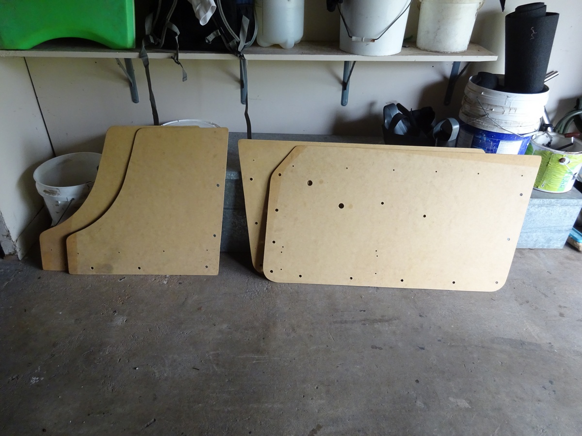

21. GT door cards ready for new trim Check (got some kick panels somewhere too)

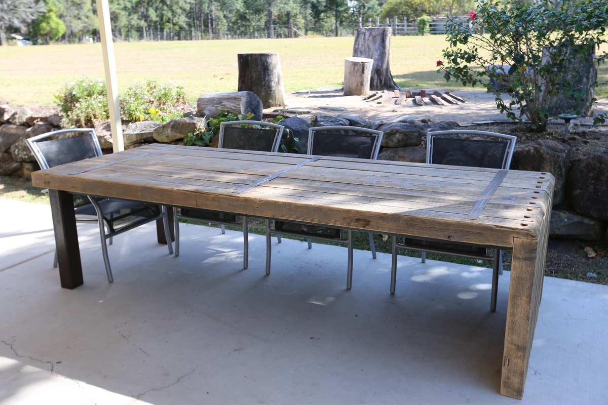

And here is another one just for Rod...... :twisted:
A recycled Steel and European Redwood outdoor table 3100L x 1270W

did you make the door cards ?
Using 3mm MDF sheet ?

I never made these ones Glenn and yes they are 3mm MDF, but I am going to use them as templates to remake some out of some 3mm fibrous plastic board specially designed for door cards.
Unless you seal pre-seal the MDF with a lacquer or something they and reline the door body with plastic they can blow out to an inch thick with first day of rainy weather (just like Donkeys door trims were when I bought him)

thanks for info. Yes, i would agree on sealing the mdf for sure. Where do you get the proper stuff from though? My Sport could do with new backing boards

In the past I've bought it of auto upholsterers for making my own door cards & padded face boards for Bar Cabinets.
Not all I have asked in the past use it though so you might have to chase around a few of them.

Liz said if you leave the recycled redwood table take what you want :o
Fri Jun 19, 2015 7:43 am
That one was made a couple of years ago but I still have enough of the same material left to make another 2 of them.....
And just to clarify for Lizzies bennifit - European Redwood is like a type of pine (bit like Baltic pine) so not even remotely red in colour at all.
But I could have one ready in a fortnight and I'll deliver on a car trailer so that I can collect payment at the same time :twisted:

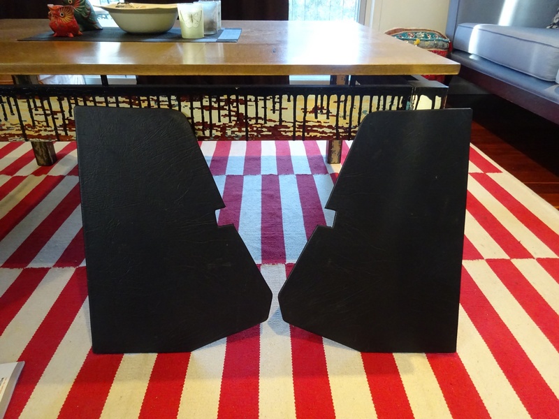

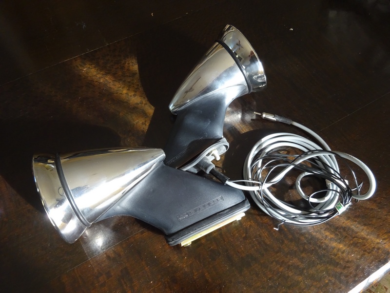

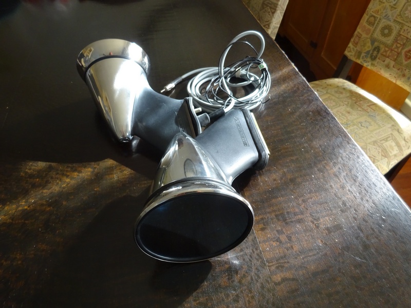

Found the kick panels + MORE parts aquired
22. Kick panels Check

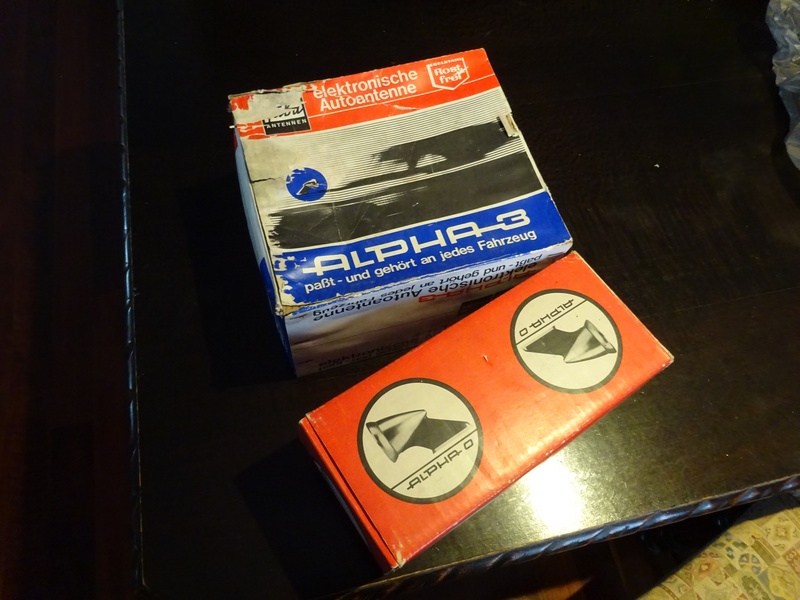

23. Fender mirrors Check (original 66/67 NOS German made "Alpha 3" with integrated radio aerial)
The mirrors are obviously not "GT" mirrors but this is of course ME building a car here so they are EXACTLY what I need, and have been looking for...... weren't cheep though at $175 (the guy was asking $290)

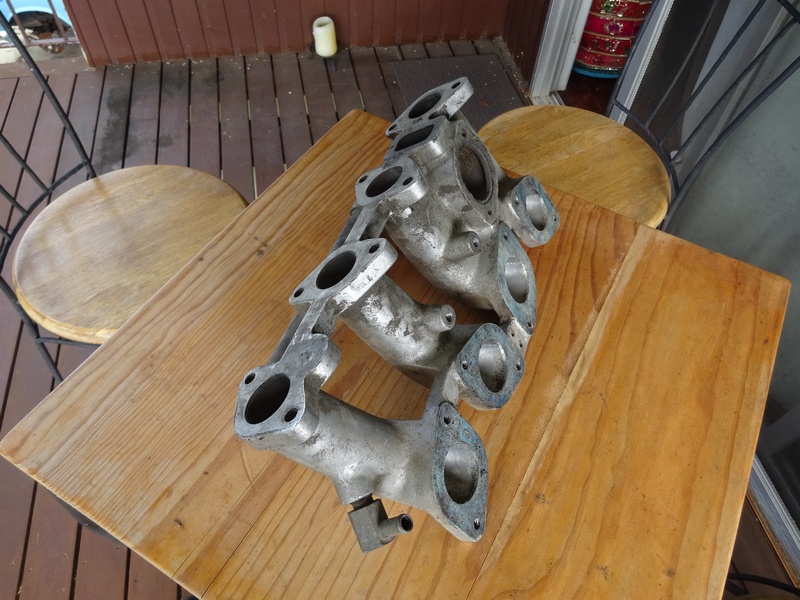

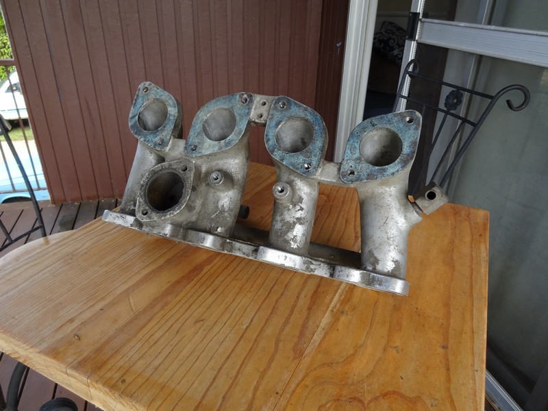

I also recently purchased a twin down draft manifold for the Gemini motor in the that's in my blue 69 sedan.
This motor will get pulled out and will go into either "Jenny" or a 67 sedan I now have (haven't decided which one yet, but which ever one gets the Gemini motor, the other will get the twincam)
The manifold will get a good clean then just need to fit a set of down drafts and I will be that much closer to getting my hoon on :twisted:
