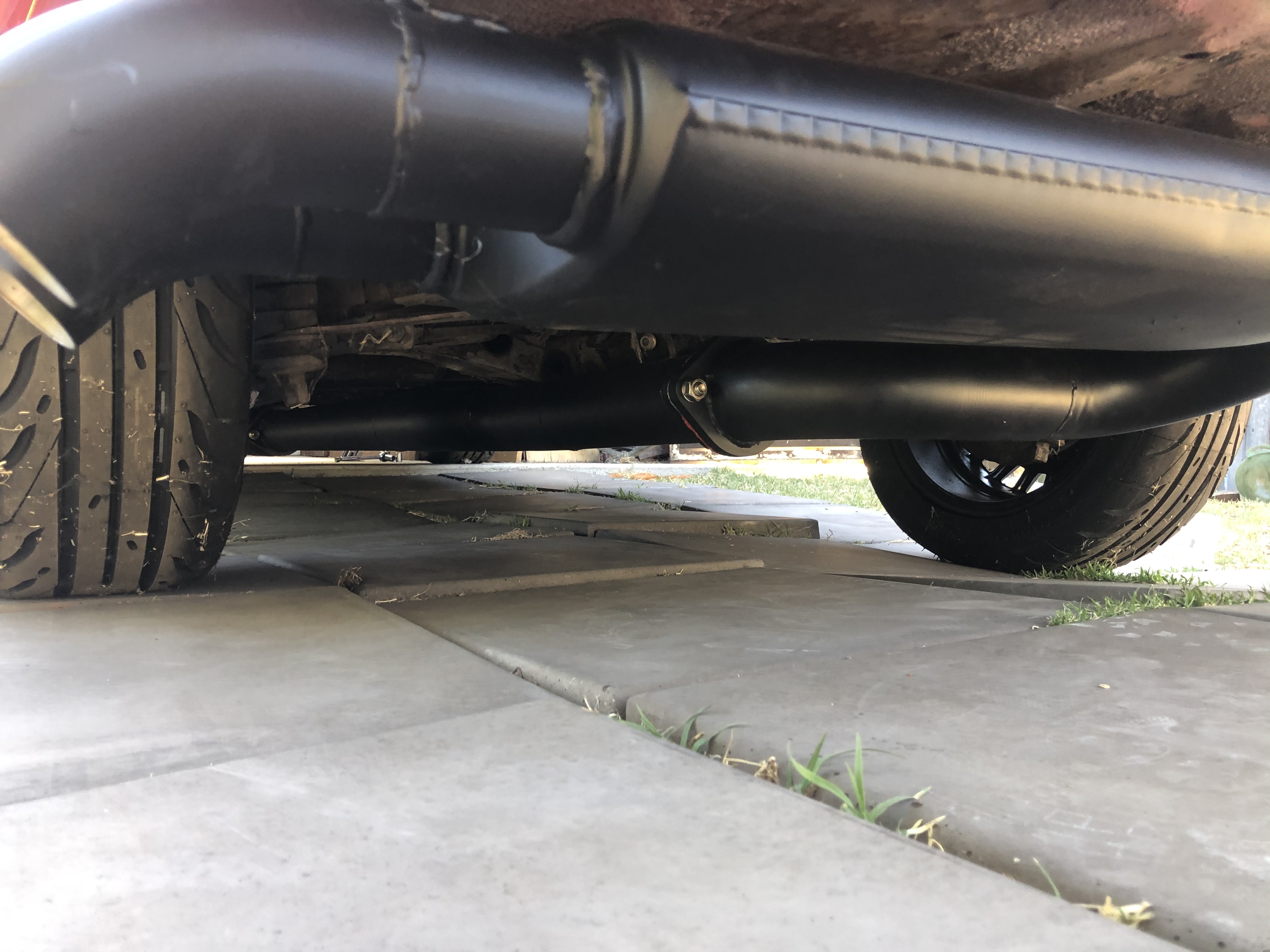

Exhaust completed.... wahoo!!!!

Ok, side outlet. That's different, that's interesting, that's noice.
I'm looking forward to seeing this car, great work mate.
