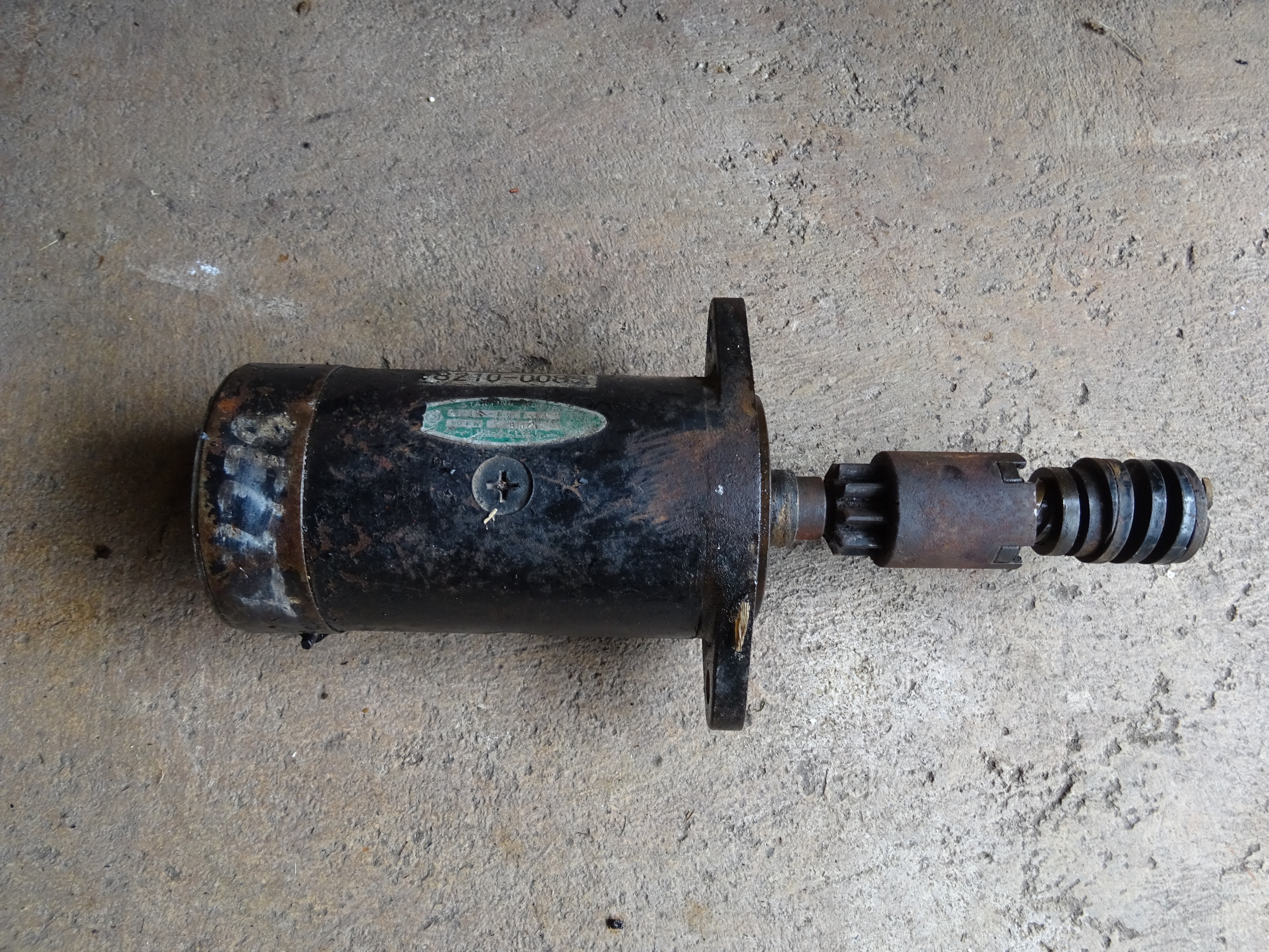

Yeah mate the early type starter like this

That's the blighter.
I have 3. One is suspect. :o Will pull it apart this arvo and check it out. :)
Will let you know.

Suspect starter is a no go. The terminal for the battery lead not insulated on end plate. Looks like it has
had a cold chisel applied on the main body a few times and damaged the terminal. :o Brushes not square (about 70 degrees) and if were cut to square would be undersize. Commutator leaves are damaged. Probably arcing on end and a great big short.
Number 2 starter fair. Cover for brushes not aligned correctly letting oil and junk into it. There was no split pin in the Bendix retaining nut. Brushes to a minimum. Bendix frozen on shaft. Cleaned the end plate and Bendix spiral. Like I said. Fair.
Number 3 starter good. Doesn't look like it has done much work for its age. Bendix was frozen but didn't take much to release it. Brushes are good. Still a bit of meat on them and the commutator looks good.
I've got nothing to test these properly but I'm going to drop off 2 & 3 for you to play with. I didn't bother reassembling number 1. Leaving it for another day, another time.
