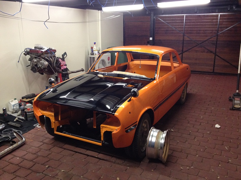

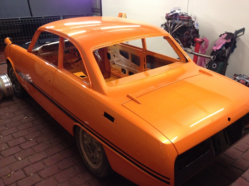

Finally brought the car home tonight from the paintshop still needs to be cut and polished so should turn out even shinier...test fitted the wing mirrors just to see how they look. Now i can start putting it back together! Hope you all like!

great job it will get better from here on... looks great waldo a bit of work ahead .....it will be worth it cheers davo
Tue Mar 27, 2012 12:34 pm
i'm guessing the radiator support is cut away due to the intercooler on the old engine?
Tue Mar 27, 2012 12:51 pm
Looks fantastic !
don't think those wheels will fit though ....

Yeah the wheels fit...just have to get new rims spun for 3 of them though ill keep the updates rolling as it progresses
