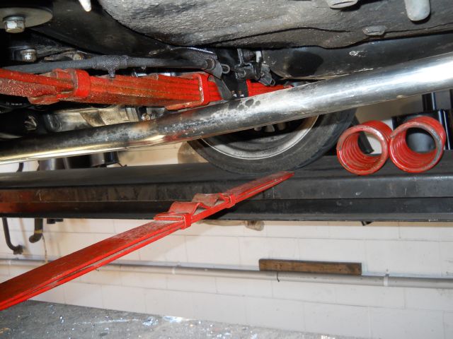

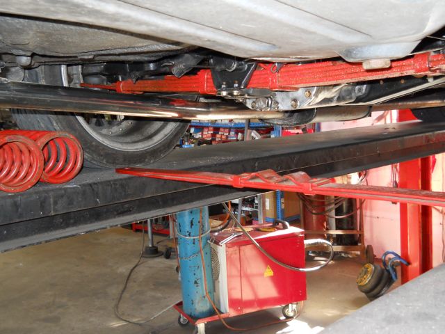

:? This suspension topic is a great read,few of you would have caught me
laying under the back end of a Bellett or two at Coona,question how many
leafs in cross spring on a GTR. As you can see when I got the Peter Lyons
GT it came with alot of parts and two cross springs,at the moment running
four leafs also have the two leaf,what would be the difference,have heard
of that Z bar on a Bellett,would need to talk to those in the know ;)
Gerry

Now we have a expert on bellett rear ends ;) Gerry has studied every one in aus and we may have proof of looking up rolies rear in the uk ? :lol: :lol:
Sun Jul 10, 2011 10:35 am
I'd imagine you're not getting a lot of body roll there Gerry? Heavy duty!
Sun Jul 10, 2011 12:39 pm
Yes Matt the car rides well and hugs corners,but pushing it on a race
track,well would have to leave that to Pinky,I've seen what happens
when they hit the gaurd rail ;) Gerry

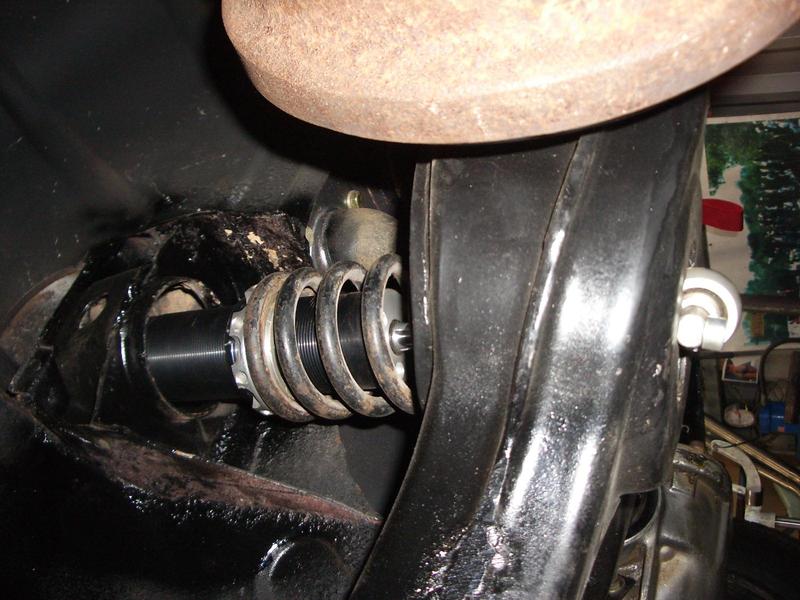

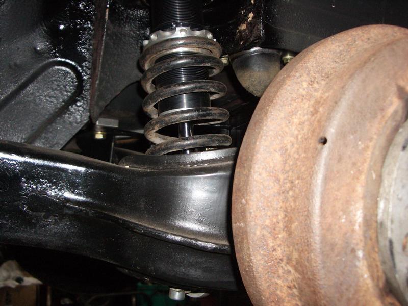

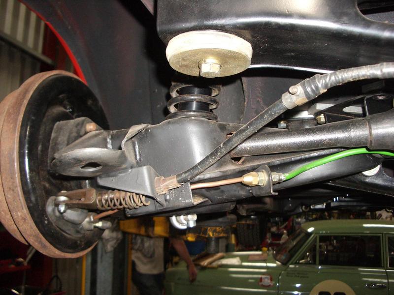

Sorry I've missed out on the earlier discussions, but it's all very interesting and thanks for your contributions. I've taken a few pics of our set up, I'm afraid they've not come out as well I hoped, but they may still be of interest.
You might have to put your screen onto its side for this one!

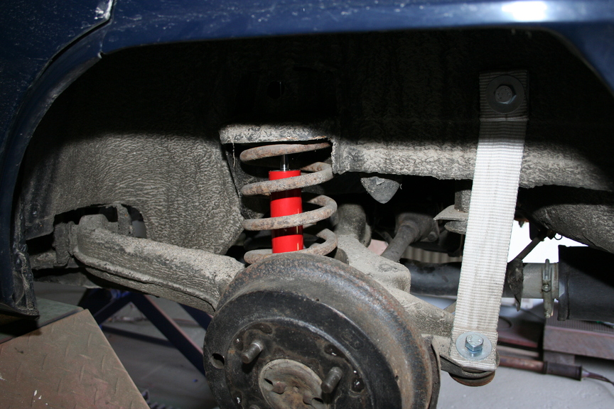

And this is a photo of the Scandanavian set up

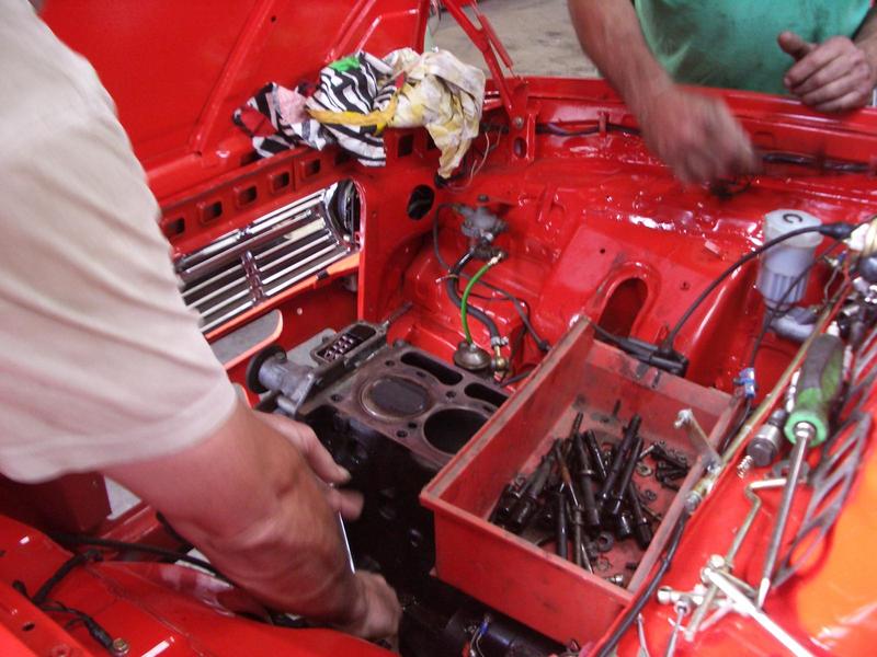

One of my reasons for not joining in on the more recent discussions is that we've suddenly come up against some problems with the engine......amongst other things, after the test we've ended up with two broken valve springs and a broken valve guide. Under the bonnet boys :roll:

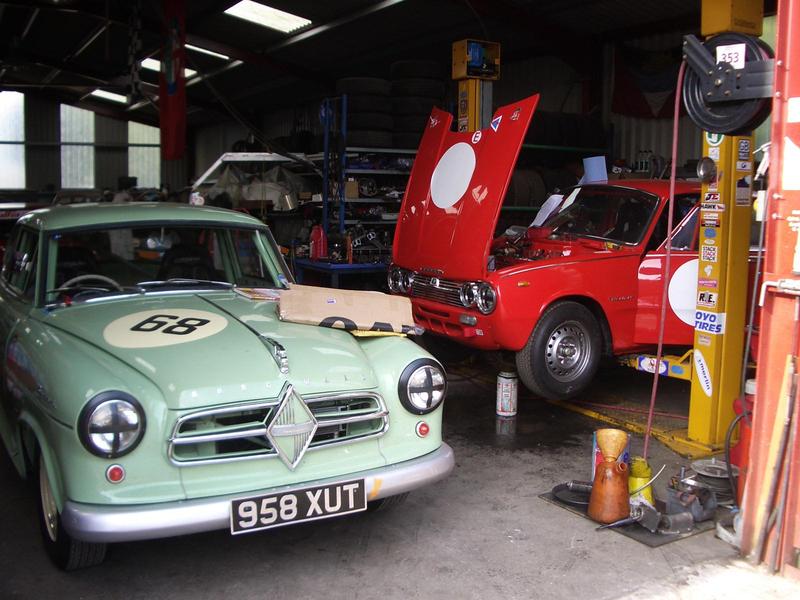

And lastly, I like this one.....it's Rolie and his stablemate.....one of Techno Chris' earlier creations that ran at Goodwood last year.

Great set of photo's Mark,interesting to see your set up and others,wondered
about the strap set up,wishing you all the luck with the motor,Gerry
