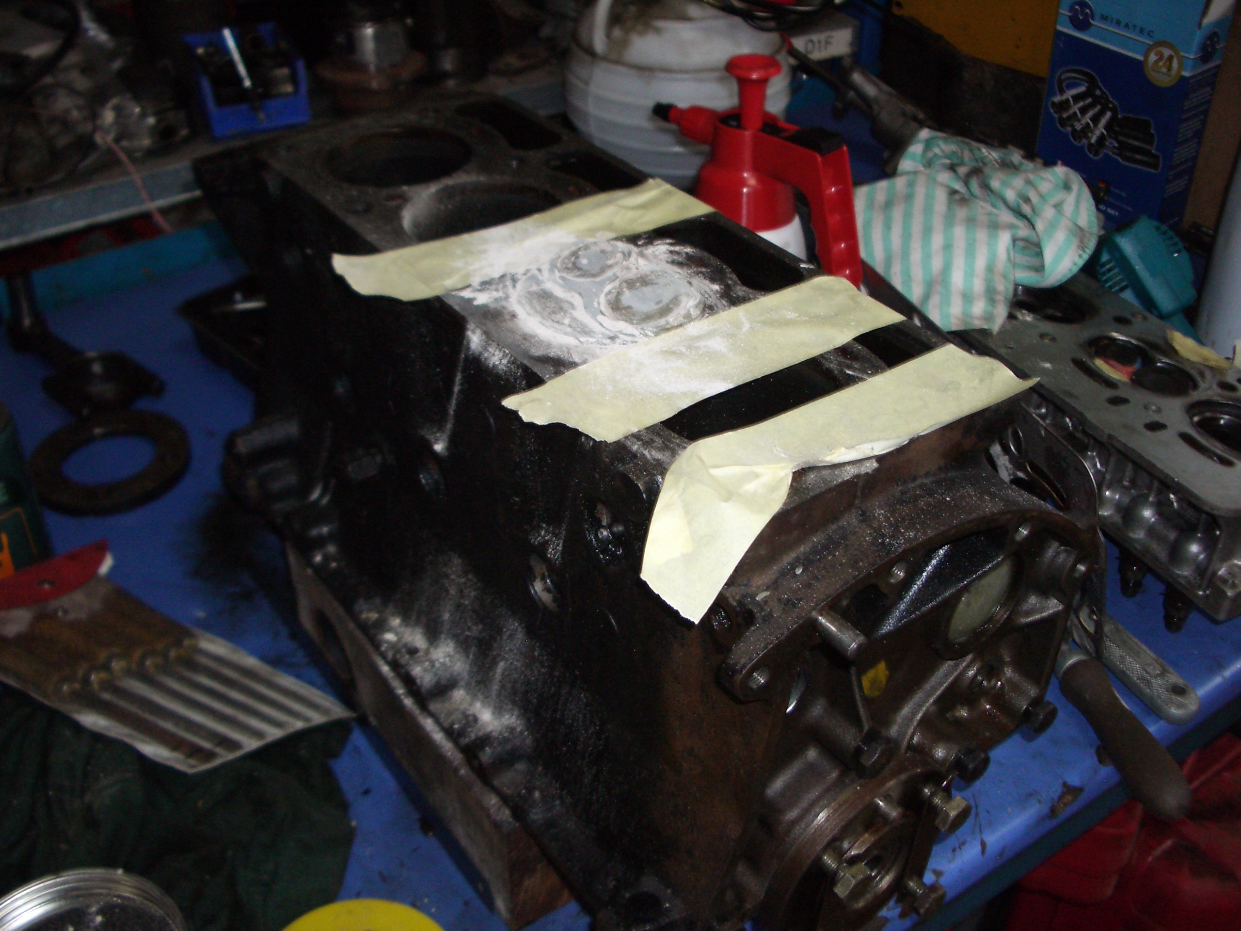

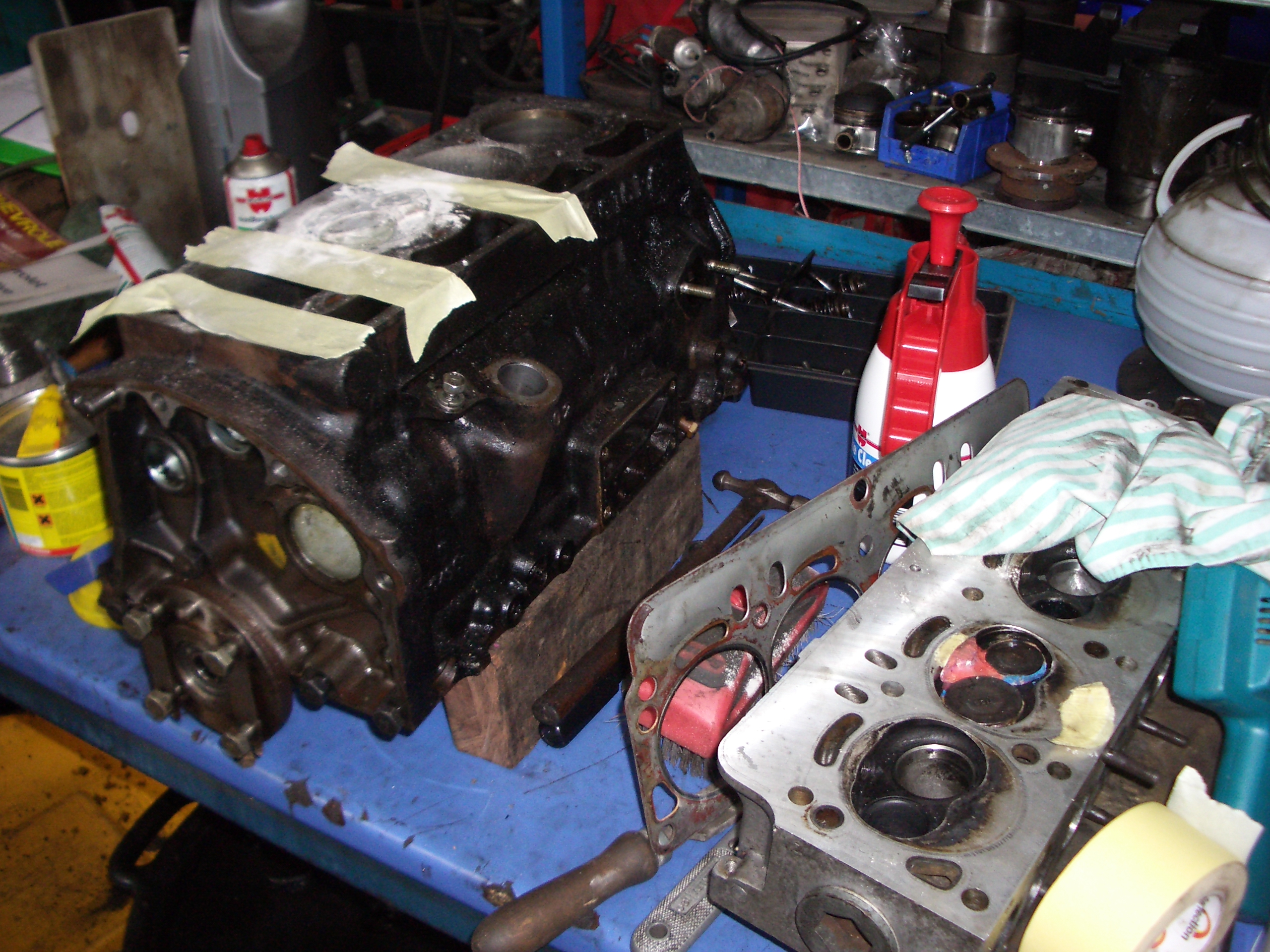

Cheers Dave....we're now hard at work on the engine. The picture below shows the process of designing the pistons.
Here John's making a cast of the swept volume.
And on the right is the head being remodelled. We've had a little set back with the crank, and we're going to take a look at the one from the front cut that Greg sent with Rolie. The guys from mainland Europe reckon it might fit.....fingers crossed.

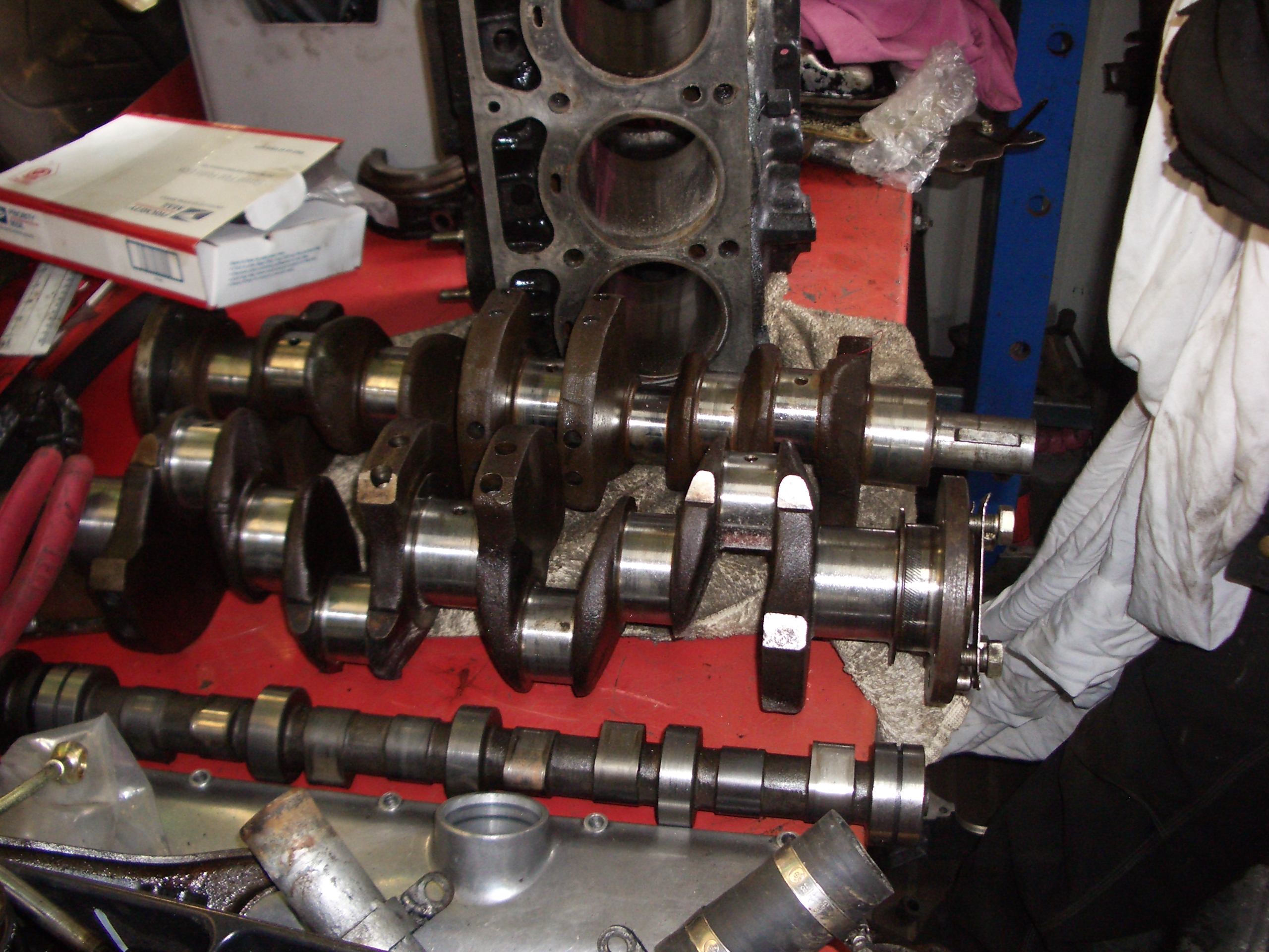

The good news is that the crank from the front cut is a good one and will fit...see below
The tale of two cranks.
By the way what do you guys do when you want to renew the rear crank oil seal? Even Ari is stumped by this one.

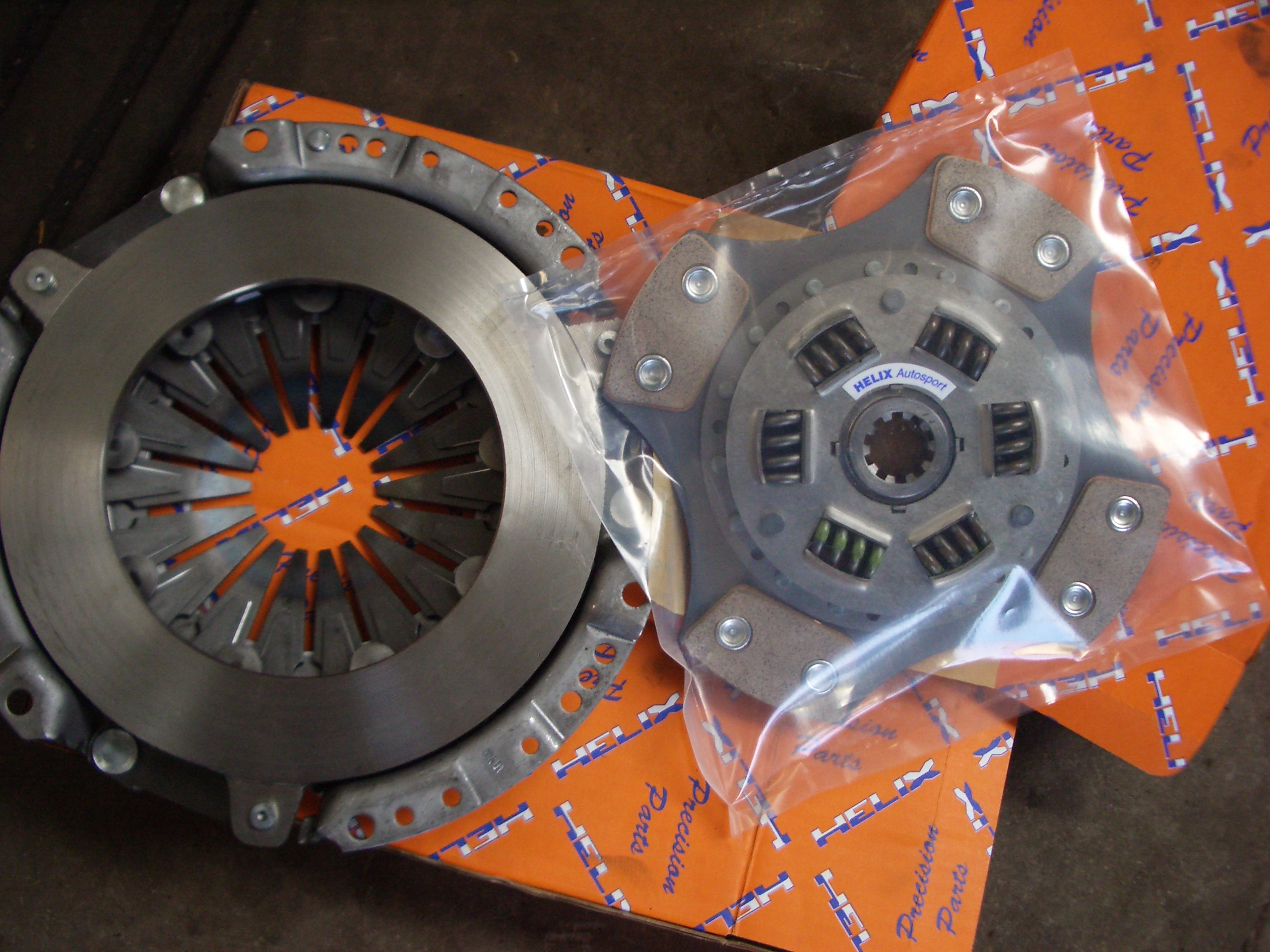

One other interesting discovery was made last week, when we went to a race clutch specialist and found that with only minor jiggery pokery a Triumph Dolomite Sprint clutch will do the job......so with the shaved flywheel and this little lightweight thing we're shedding the pounds where it counts (no jokes about my wallet please :D )

Your find with the Dolomite Sprint clutch is very good to file away.
