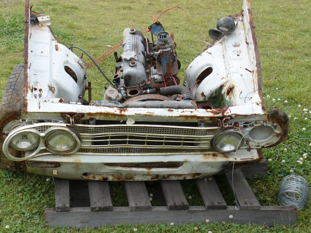

Talking of which......pop quiz....the gearbox that came with the front cut (G160??), pictured below,
although it has a slightly different casing, are the ratios the same as the earlier (G150?) box that came with Rolie? We're looking to close the rather obvious 'torque hole' between 3rd and 4th.
Any ideas?

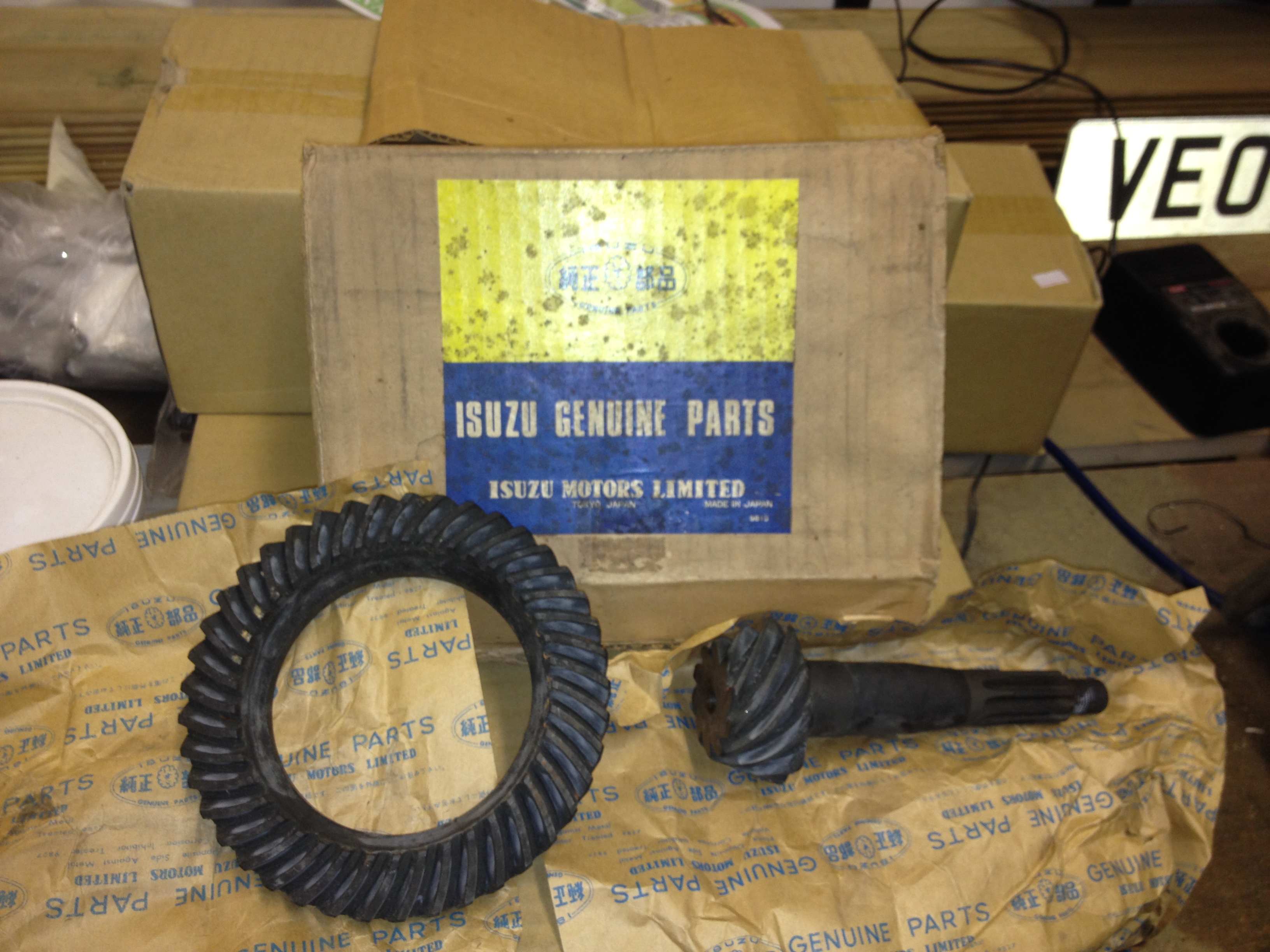

Still on the subject of ratios, this weeks Rolie report can reveal that Santa has come early to Bellett UK, Rolie currently runs the standard 3.7:1 diff, but we've found one of these.....
4.11:1....The theory is, that as we move the power band up, the 'torque hole' will only get worse, this will help, especially as most of the tracks we will go to will be slower than Goodwood.......it also gives us something to do whilst we wait for the engine parts.

that front cut looks like it's a late alloy head G150, not a 160.
a G160 would be from a PR90 GT.
all G150 sedan boxes have the same ratio's, but the early ones didn't have syncro's between first and second where as the later ones did.
GT box's have better ratio's and are the same as the common Gemini box, but there are a few different Gemini ones as well.
unfortunately Bellett and Gemini stuff like that isn't interchangable....
i believe the very late Rapier's had some things common to Bellett's, but i don't know if that extends to include gearbox stuff.

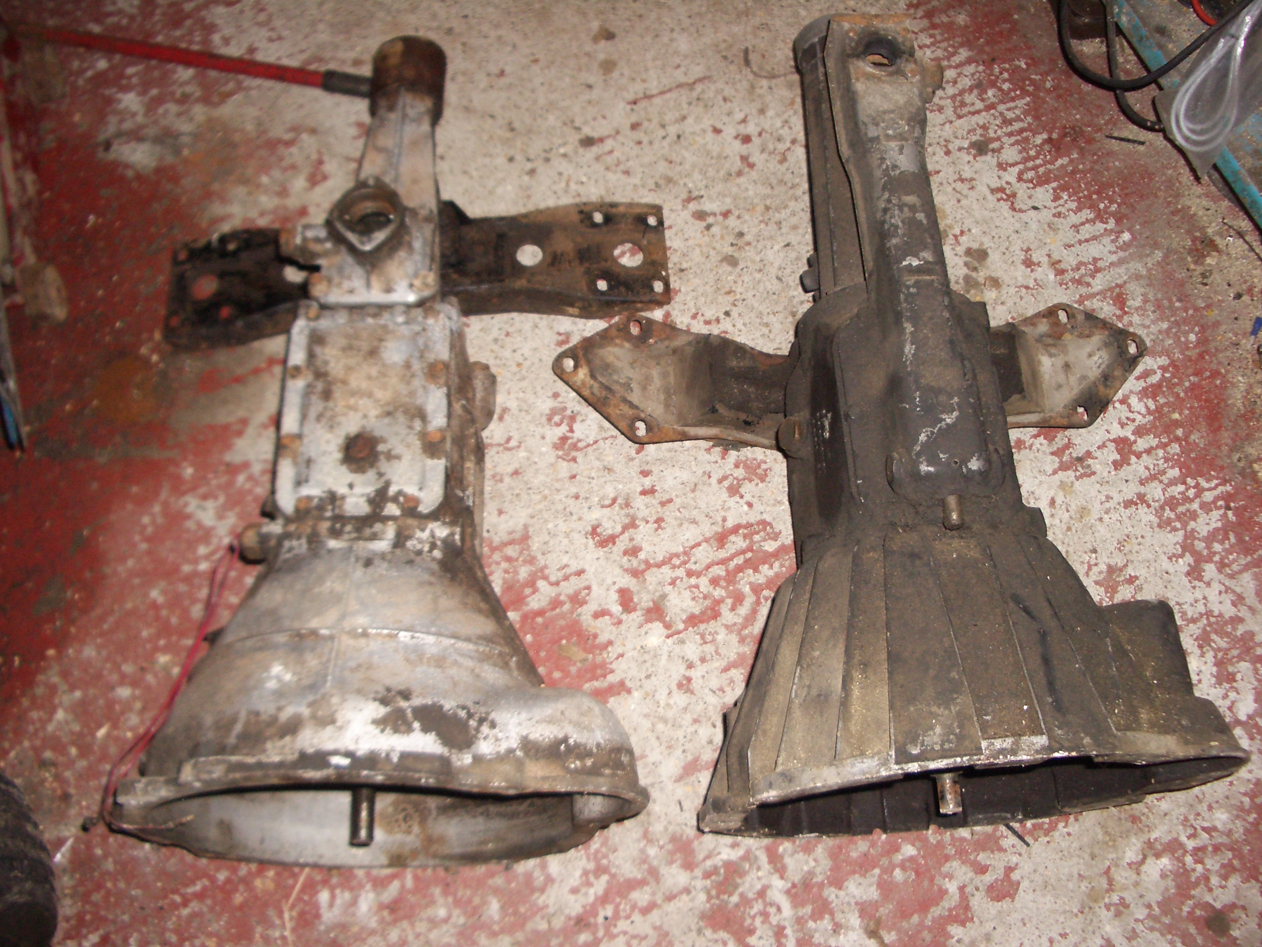

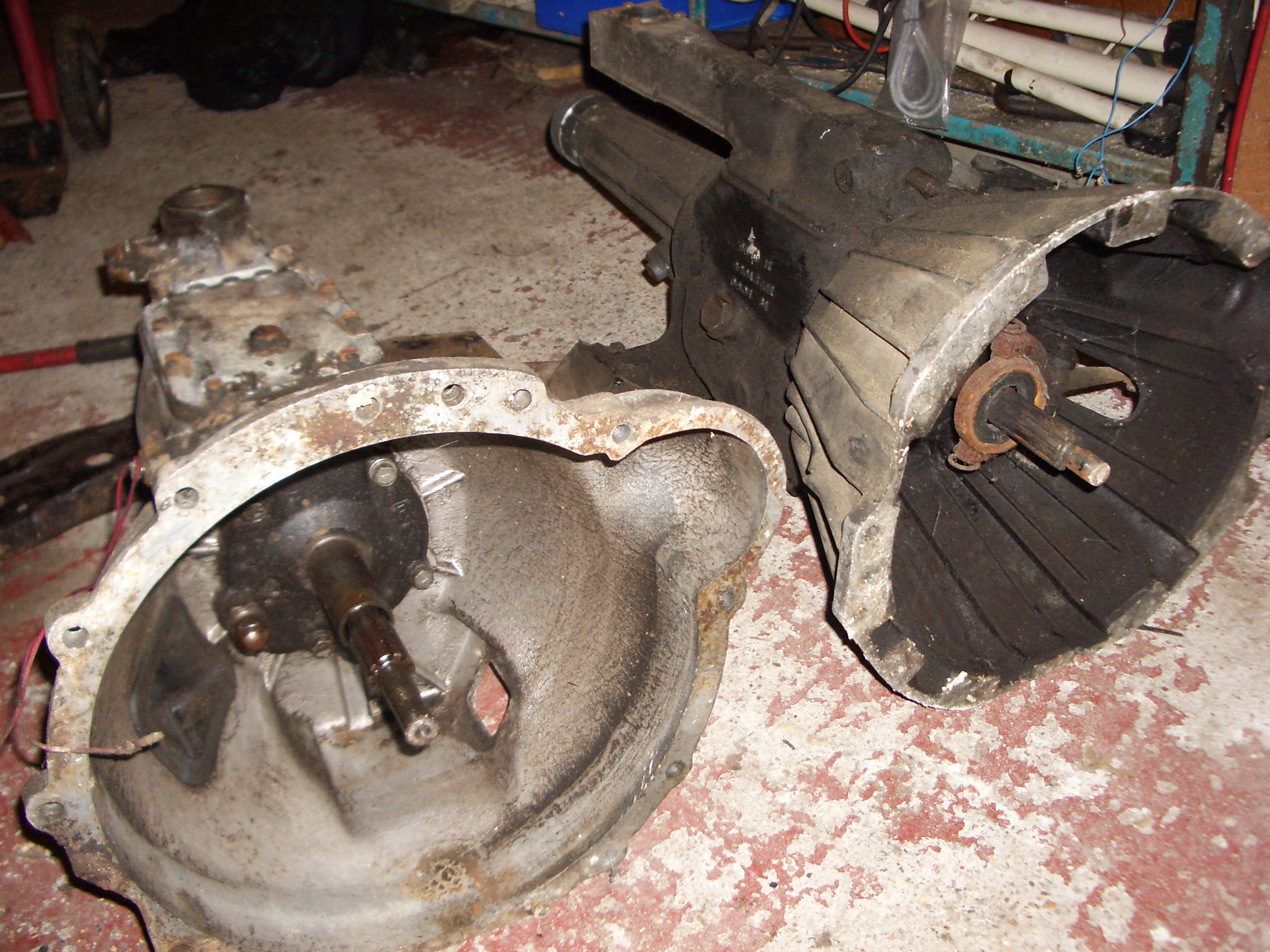

In the meantime I've picked up the Rapier box, and although there's some similarities, I haven't had a good look yet....here they are side by side. Bellett on left.
My missus thinks it's a bit sad taking photos of gearboxes....I haven't told her I'm thinking of making these pics into our next set of Christmas cards.
Fri Mar 09, 2012 12:42 pm
to add to the Xmas card, anybody have a picture of the right Rodeo box ?
a GT box and std Bellett box, too, taken from the side also would be handy
Fri Mar 09, 2012 10:44 pm
That remote on the Rapier box looks a lot like Bellett GT :?
