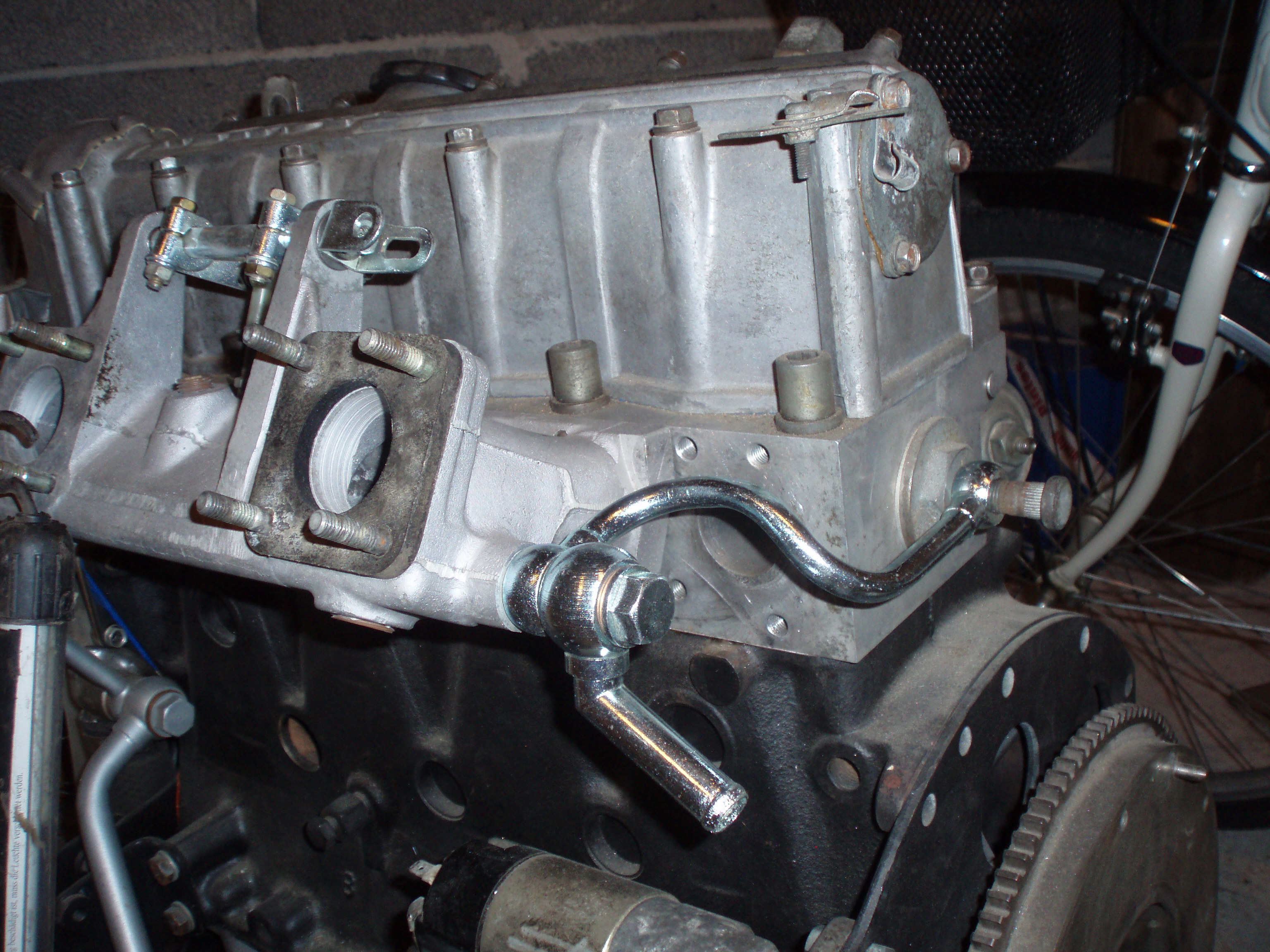

Pombellett wrote:
Cheers Dave M....and yes, it is a Go Pro camera...brilliant little bit of kit.
Here's another pic of the last Goodwood meeting...it shows how lucky we were with the weather...it can be awful here at the end of March.
The attachment grid.png is no longer available
Going back to the cooling of the head....Glen, any chance of you (or anyone else) posting a pic of the union/connection of the hose where it joins the back of the head?.......Cheers guys.
Mark, I don't have the GT anymore so can't post a detailed picture of the rear of the head and pipe. Somebody else should be able to take a closer picture than this.
This is the OHV motor so may not directly translate to the SOHC head. I have no idea of the water passages in those engines.
The pipe uses Bundy fittings and runs out of a tapped insert in the rear of the head to the inlet manifold. The pipe as then electro plated. You should be able to just observe that in this picture of my previous GT's engine.
