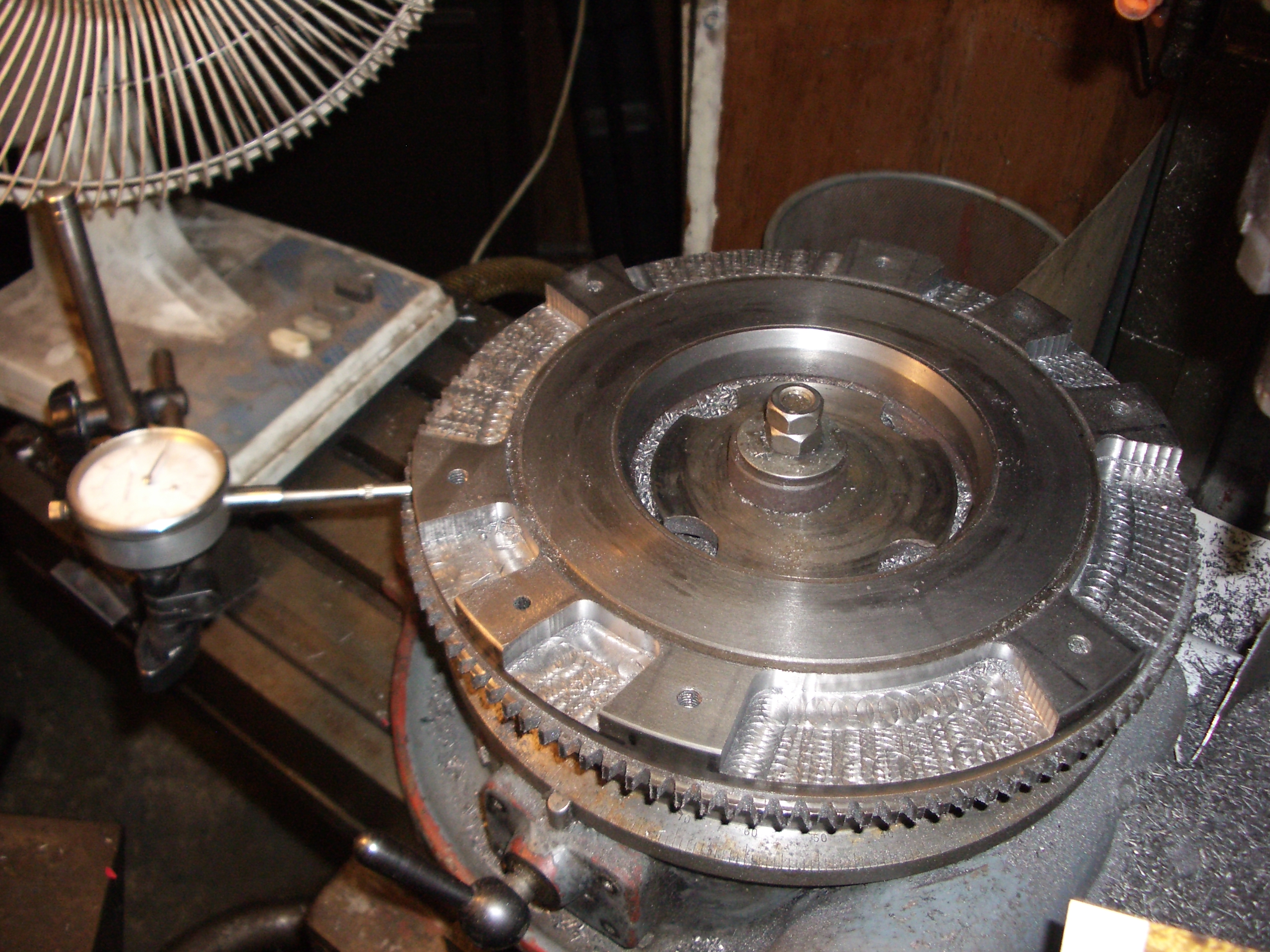

Yep, things are still moving along at a good pace. Crank, cam and valve seats all done. Flywheel's been on a serious diet...see below.
So the bottom end and the top end will hopefully be reassembled by the end of the week, and the two should have a happy reunion at the weekend.....lets hope they have a long and contented relationship.

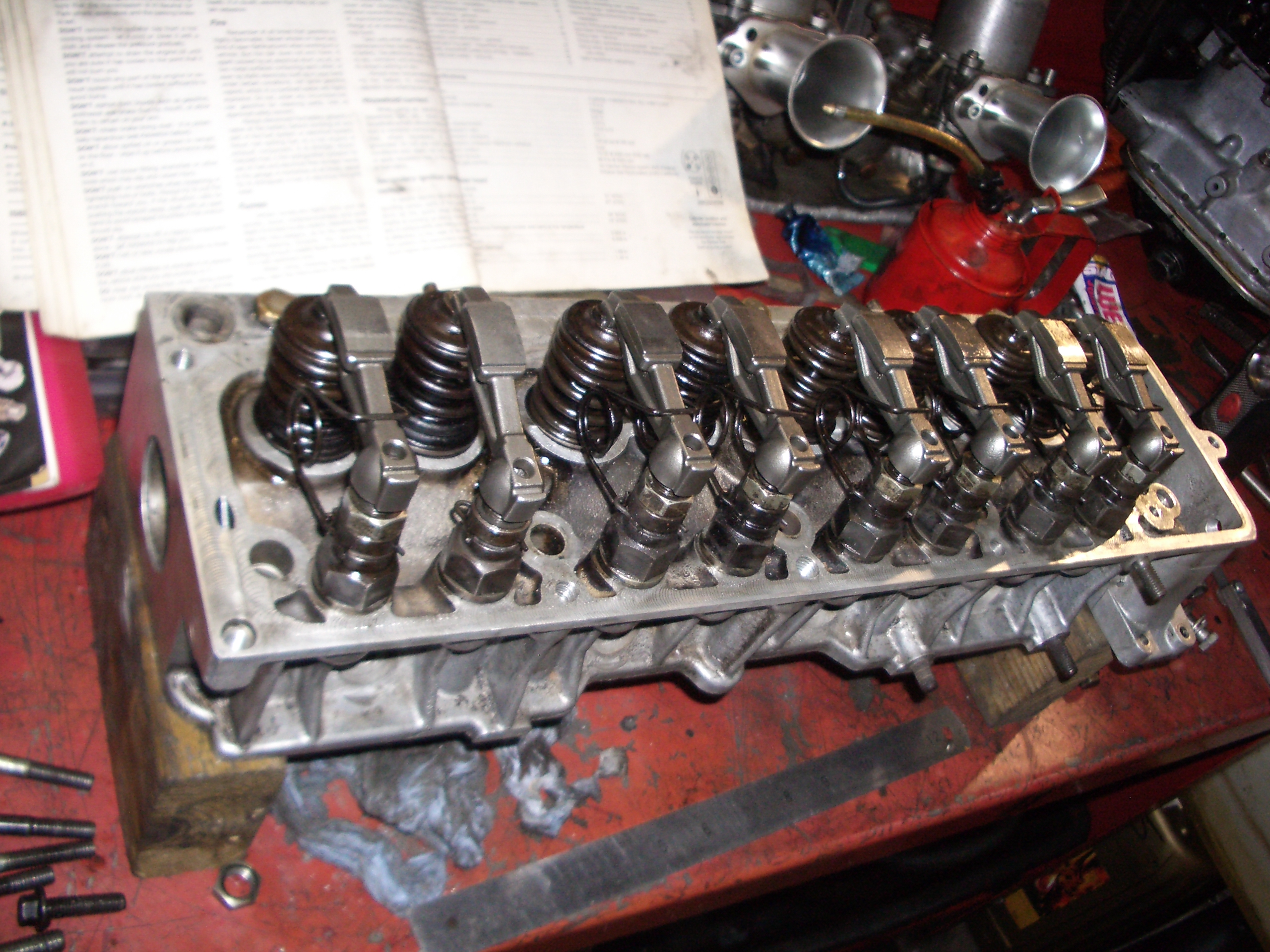

The run up to the test was a little fraught, as a few days before we discovered that whilst in the States the TOP of the head had been machined down by a few mm.....we assumed in a cock-eyed attempt to increase valve lift.
All it did though, was to totally upset the angles of the rockers and their attack on the tops of the valves....you can just about see this on the rocker second from left.

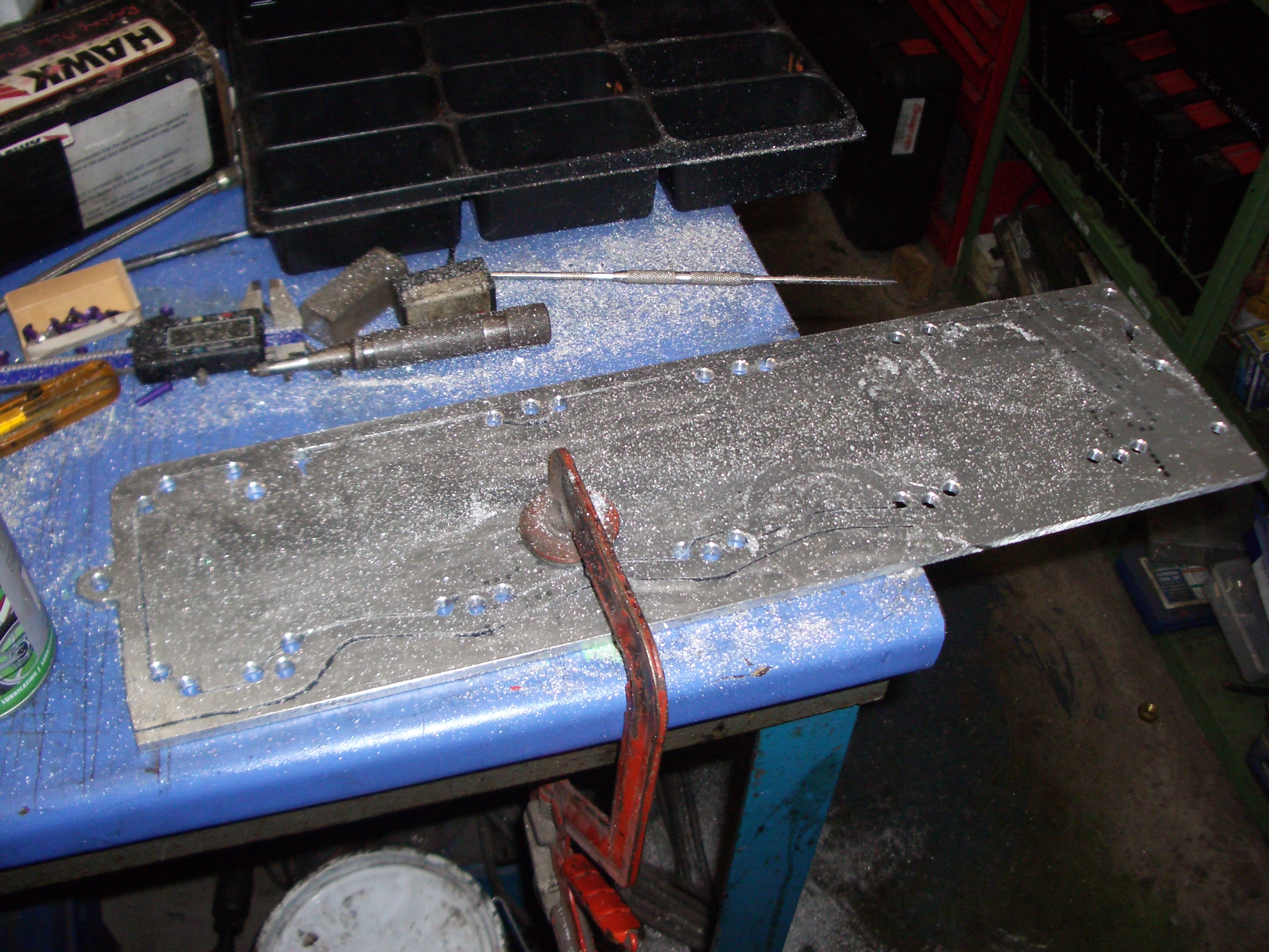

The solution was to cut a spacer
A laborious process to say the least, especially when we realised we hadn't take into account rocker ratio into our calculations and had to do it all again.

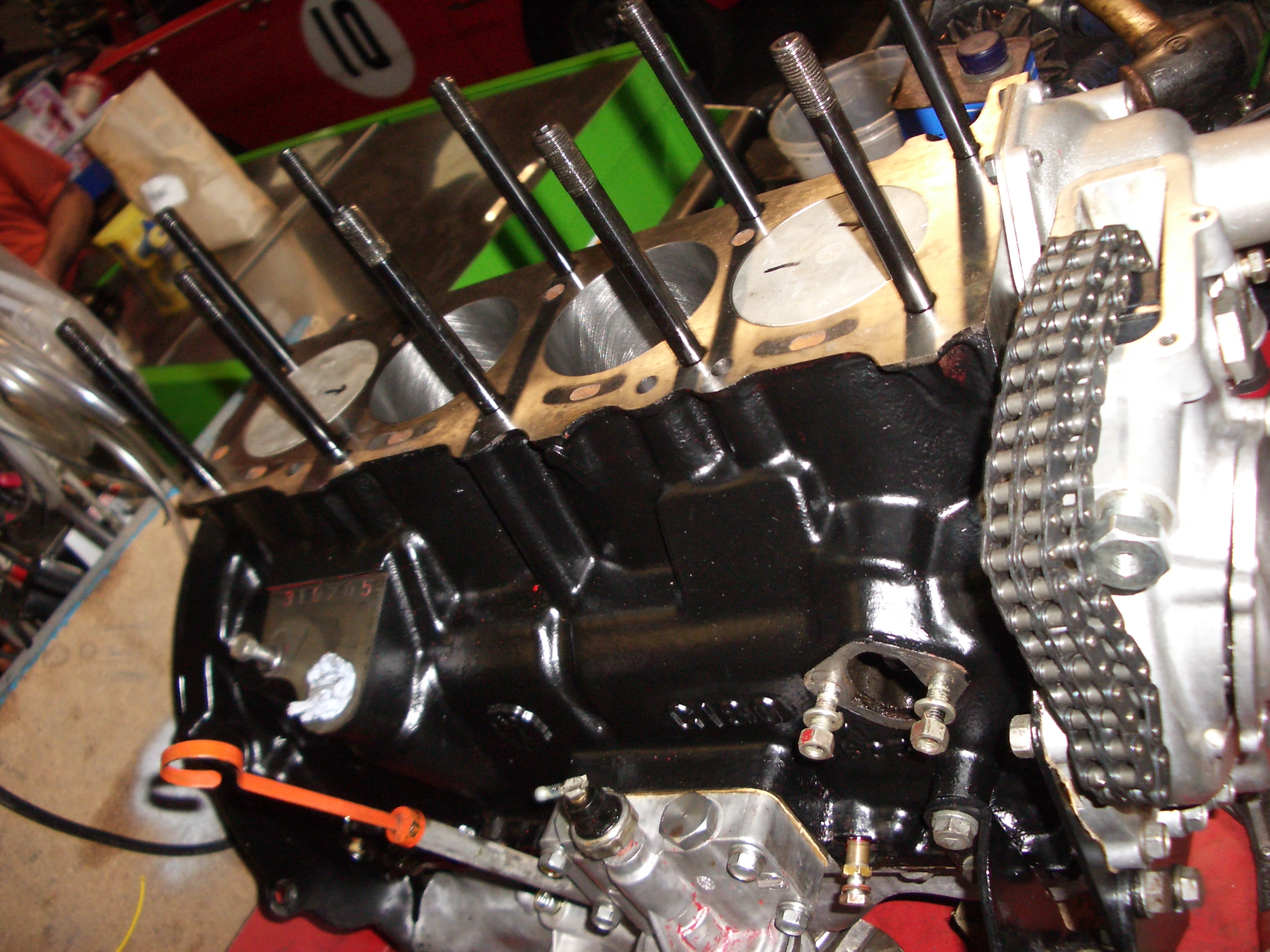

But it worked, and when attached to the block....
....it all dropped into Rolie without any fuss.
