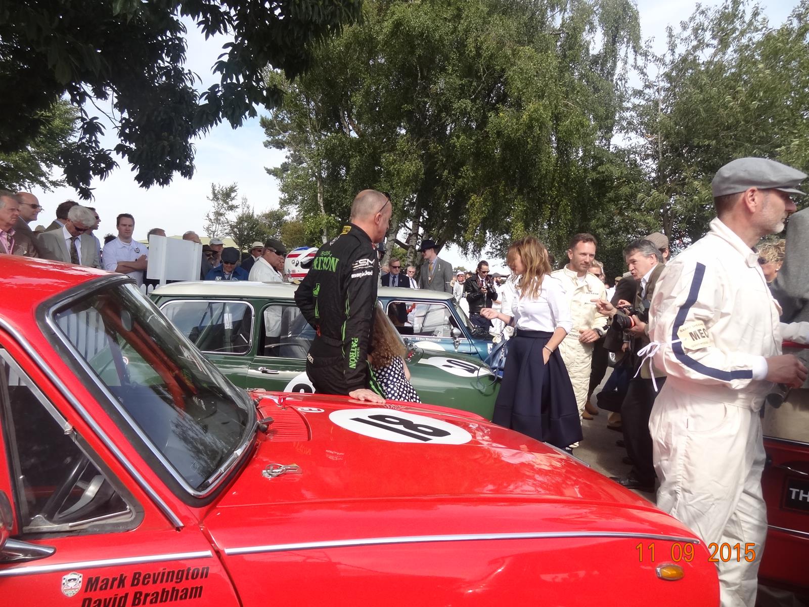

The first one was when David Brabham first took the car out for his qualification....it immediately started to misbehave, and his session was cut short.
Here's a shot of the man himself trying out his first Bellett.
It was Tom who picked up on the fact that, when I'd played around with electronic ignition I binned the ignition parts but left the coil on.........this coil had cooked the points.
The old Lucas 'Prince of Darkness' went back on, and everything was good again.

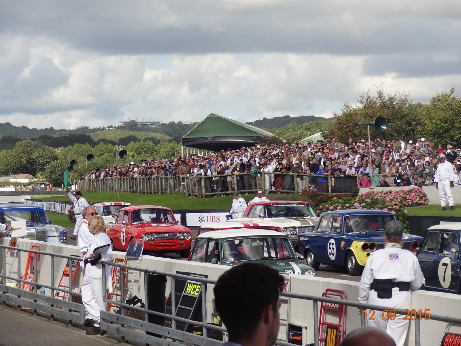

Back to the races....DB's race was directly after one of the Tribute Parades, so we had to park in the pit lane, instead of working our way all around to the assembly area, and here Anna got this great shot of us getting him ready as the rest of the field came out.
And lining up.

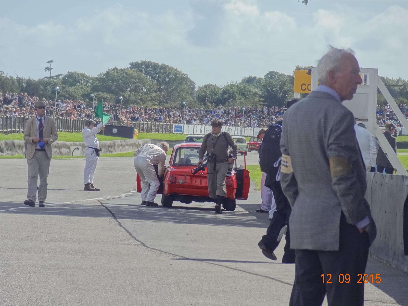

David had a tidy and fairly uneventful race. The two cars we reckon he was racing were passed in the first lap, and he steadily worked his way up to some reasonable times.
The general thought was that the track was running about 1.5s slower than last time, due to some resurfacing, so with this in mind he was running about the pace of two years ago when we had a much more developed engine........he wasn't exactly climbing the walls with excitement but Team Bellett UK were pretty pleased!
BUT, by the time we got the car back to our garage, it had developed a strange 'chuffing' misfire. Once it had cooled the cam cover inspection plate was lifted, it was revealed that a cam follower had sort of rotated sideways and come off the top of the valve. Ouch.
Whilst the boys took the camshaft off, I shot back home and picked up the 1600 head this provided us with the bits and pieces we needed...and after a long evening and a couple of hours in the morning we were up and running again, and ready for my race....but it was a tense few hours.

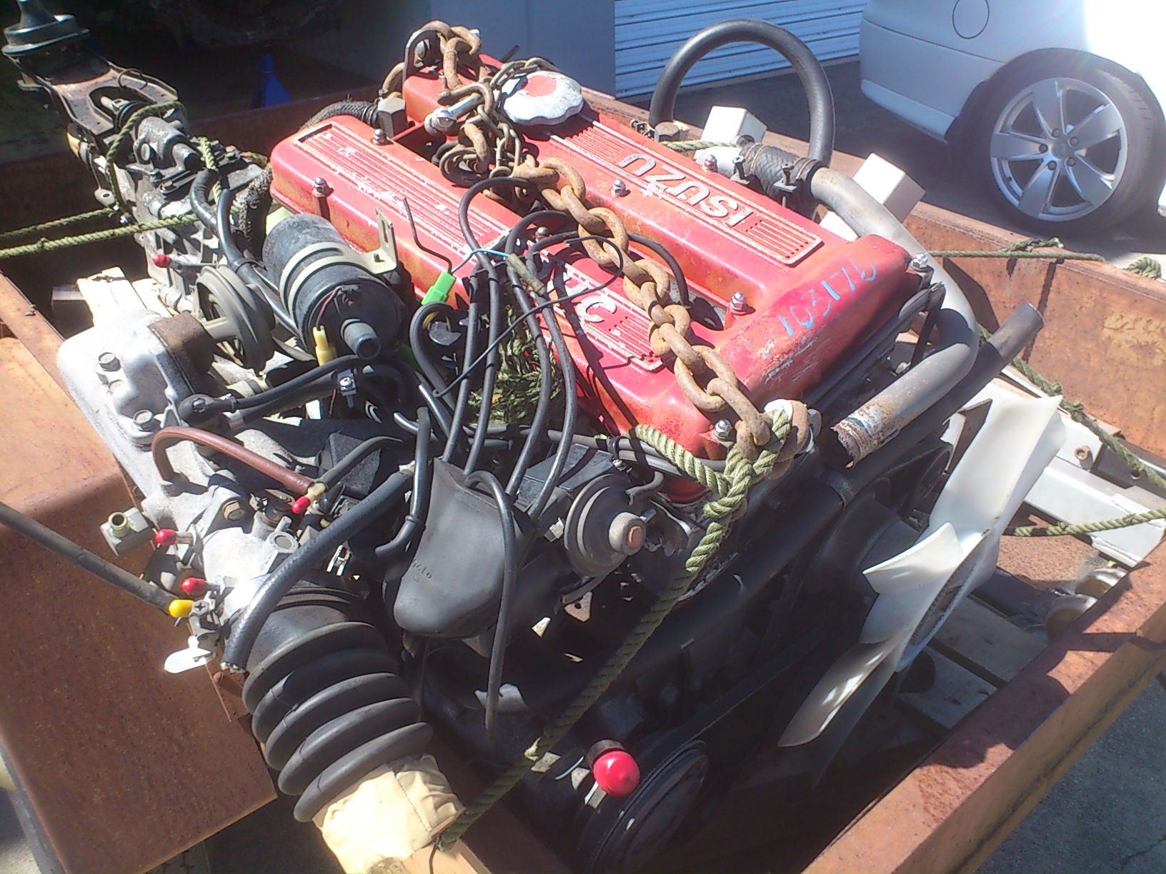

From what I've read of the rules, that you are allowed to use a substitute engine of larger capacity etc as long as it is the same engine family, would it be out of the question to fit a twin cam to it? Kinda turn it into a 4 door gtr?

from what I 'know' (but needs to be verified, as I never actually did it) ..... a twin cam head will fit the 1800 SOHC engine. I would assume the main advantage of the DOHC is it may enable the engine to rev higher? The head may interfere with the starter motor though? Pic is an early 2000cc DOHC with 5 speed. Cylinder spacing 1-2 3-4 is very close though and they are prone to blowing head gaskets if heavily modified, so an 1800cc would be a better bet.
BUT:- worth a read also
from the web http://www.isuzuperformance.com/isupage/tech/engswap.html

IMHO, the twin cam is overrated.
A Gemini SOHC of the same capacity will make more power, and be more reliable, for far less money.
That's why I use them in my race car.

We have thought about it, Red and Glen, especially as the guys in Finland have been pushing for this 'mod' for a few years.......they have VERY strict rules over there, and can't believe we can play around with the regs to such an extent here.
The problem with the twin cam is that it falls well outside the 'age limitation'....and although we'd probably get away with it for a while (such is the limited knowledge of Belletts in the UK) it certainly wouldn't be in the 'spirit of things'......it clearly looks like an engine from a later era, and would certainly set tongues wagging if we suddenly found 10 seconds.
Politics is big in this type of historic racing (probably compensating for the slightly more relaxed attitude to the regs) consequently you have to learn to play hard but within a certain set of rather fuzzy rules.
I hope this makes some sense, but I'd be happy to attempt to answer any further questions.

Just seen your post Brett, and you're not the only one to mention this, which obviously helps me make the choice. I hear good things about the SOHC particularly the 1800,

Hi Mark
Pretty sure the 1st instance of DOHC in 2000cc size was around 1976. The 1800cc version came much later in Gemini. Of course the GTR had a 1600cc DOHC but scarce as. I think the engine PR91 refers to though, is the much later SOHC Isuzu Gemini engine that would fall way out side guidelines if date was a factor.
I agree that the DOHC is over rated.... but it sure looks great ! I guess the 8 valves limits a it a lot. I think the 1800SOHC you have, can produce just as much power but it would appear a big task to get reliable power.

G180W came out in the 117 in early 70's I think 1973? Same block as G180S ohc, minor changes to the G180 Florian ohv block.
Dohc isn't overrated, just no one in aus has really pushed one yet. My friend had an internally stock with stock cams with twin 40mm dellortos G200W in a Gemini and it made 116rwhp. Aquarius sports in Japan has an all singing 2.2L G200W making 220hp.
You can bore a G180W to 2L capacity. They don't blow head gaskets if they don't ping! Plus Thomas4parts make mls gaskets for them.
I can't see why you can't run a 117 coupe style twin webered G180W with some tasty head work and big cams under those rules. The engine with the old type rocker cover looks like and essentially IS a 1960s engine, remember the Bellett GT-R came out in the 60s with basically the same engine. It is a copy of the Alfa gtv dohc design except the Isuzu head outflows the Alfa.
After my group A car is painted I'll be diving into the build of my G180W ZZ Gemini engines, I'm restricted by stock intake and exhaust manifolds but I'm confident of achieving 150rwhp.
