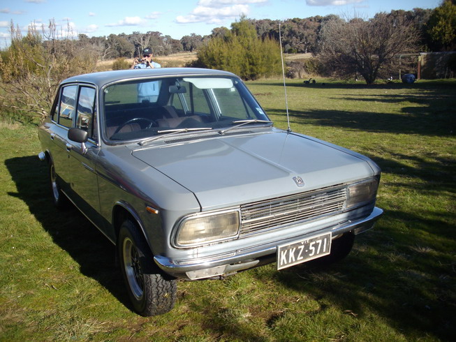

Yeah, I know - I'm hopeless for naming cars, but it just seems to happen.
Some of you may have seen this Florian in the 'Rumor Mill' thread. ;)
She's been here for a week now but I've only had a few hours to make a start on a tidy-up.
She is a one family owner & is named after the original purchaser. She has been well cared for and I am fortunate that she only really needs a good service. I am also fortunate to have a good mate that thought of me when he found a car that he didn't have room for. :D
So I've made a start-

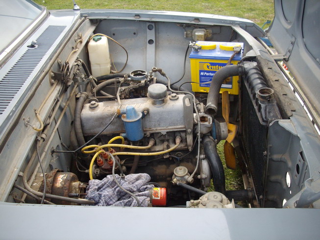

First, brakes wouldn't bleed. Master Cylinder was leaking back into the booster. It's in getting sleeved & kitted. The rest of the brakes seem fine.
Next, a grease. The grease nipples are still all fitted with their little plastic covers!
Then, Carby was a bit seepy. - Some of the screws were loose, so I replaced the spring-washers.
Drained water - Nice & green. Hooray, no corrosion! Flush-out. Also heater back-flush - still clean! Remove radiator - Back-flush. Very little gunge! :D Re-fit.
Drained the oil - :| pretty mucky - and the filter - lots if sludge. Being off the road for about 12 years will probably do that! Washed out the oilcap, separator & hoses. Yep, sludgy.
After I took the 'before' pic, lifted the Tappet Cover to adjust the rattly tappets. NOW I'm looking at sludge! Wash out Cover. Tomorrow I scrape up as much sludge as possible before filling with high-detergent oil for a flush-out.
You reckon I'm having fun? You betcha! :D

loving it! looks to be in really good nick. has it had the fender mirrors removed? gotta love the getting to know part of having a new old car!

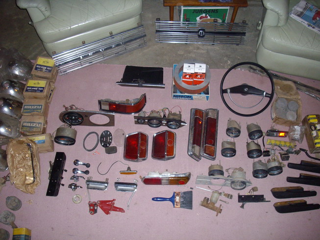

*Bonus* The whole deal came with a nice stash of parts. I just had to spread 'em out on the lounge floor. (Well, Tracy was away......)

nice score on the spares too!
a florian definately doesnt corner like a bellett, it sort of floats/rolls around a corner, and it makes me smile!
waiting to try mine out as its got the heavy duty gas shocks all round, was going to try the old hot rod trick of 2 swaybars on the front if it rolls too much!
whats in all the isuzu labelled boxes on the left?
Fri Jul 22, 2011 1:10 pm
dont ya love people who stach away parts even though some may not be for the car they own.
really well done, farmer. the parts are nearly as good as the car.. NEARLY!
it is such a great time bringing a good car back to everyday running condition. a very rewarding journey. keep postin those pics thanks

Ah Mr Flibb, I somehow knew you were gonna ask that! Pretty random-
Boxes contain: 1 set of 4 Door Handles, 1 ignition switch panel, 1 Reversing Light, 1 'Florian' Badge, Headlight Globes, and 2 Speedos - Zero miles :!:
And did you notice those NOS headlight reflectors? I reckon Aunty Mary is in for a retina replacement. 'Bing' - Bright eyes! :shock:
And good condition early flat Grille & Headlights. Maybe I can build an early-girl around them?! :P
And, yeah Davo, I know the question might come, but I reckon it's better to keep cars on the road than to hoard parts for "one day". I'll just say that my preferred transaction type is 'Barter'!
So make a 'wish list' - I know I am!
And thanks Oz, It is great that some people save bits, but then just hand 'em over with the car.
-He might have chased a few more dollars on Ebay.
But no, he's even called me up to tell me he found a few more used bits in another shed!

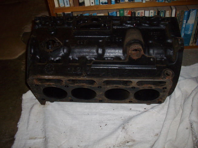

Genuine replacement part: G161 Block, complete with main bearing caps & bolts :!:
Looks a bit ordinary in the pic, but that's just a little rust colour from storage. The bores are painted, and there's no engine number stamped in.
Nice bonus!

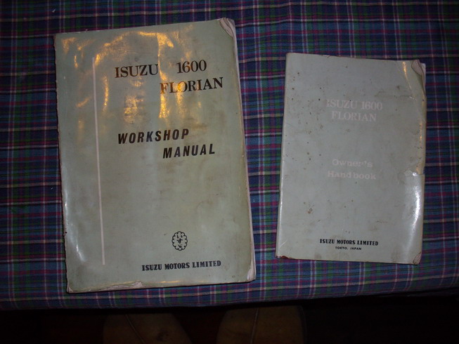

And a workshop manual! wow! officially i am now super envious!

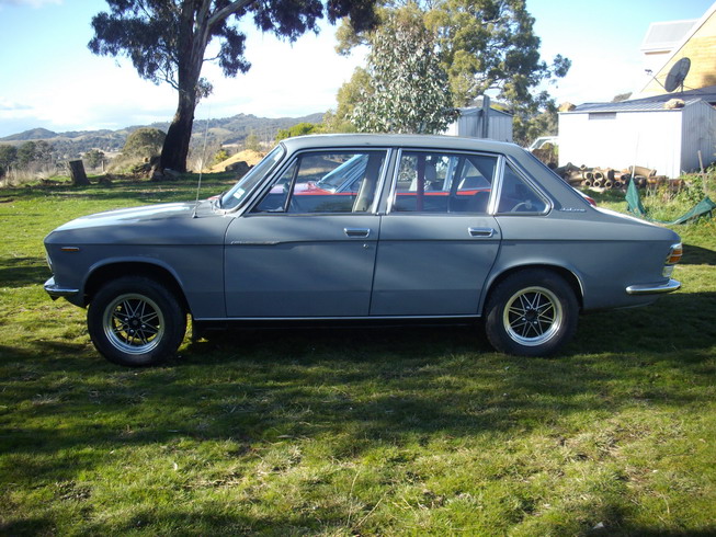

Not a lot of time today, but enough for a quick bath. It was time for some more photos.
After I took 'em, rubbed some polish on one back guard. Colour now matches the front one.
Gotta do the rest.

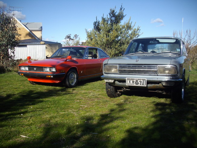

Of course there was a distraction today...........
A sexy.........red........distraction!
There's more about that in the 'Rumor Mill' thread.
Me enjoying? Maaaaaaaaaaaaayte!
Cheers (very), Matt.

i bet you have a massive grin now!
and dont tell Gary i said anything about the chev love being a parts car for the florian!
Wed Jul 27, 2011 12:26 pm
Yep, pretty grinny! But I left out one detail. The 117 is actually Gary Carters. He dropped off my mail & he let me have a drive. :)
Looks like I'll have to make a 'My (His) Isuzu thread'.
Yeah, better not rat the KB for bits - might not get any more choice drives!
