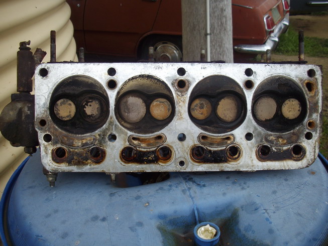

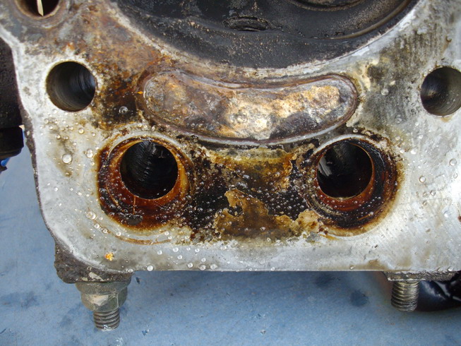

The overheating problem came back, so I took out the thermostat.
No difference.
A bit milky under the oilcap. :? Maybe the haed's a bit loose.
Retensioned. No difference.
Guage sender unit? Changed. No difference.
Ah well, OFF WITH HER HEAD!
This might have something to do with it -
Not a lot of coolant flowing around cyls 1 & 4! :(
I feel a cleaning, surface grind & stem seal replacement coming on.

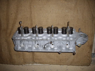

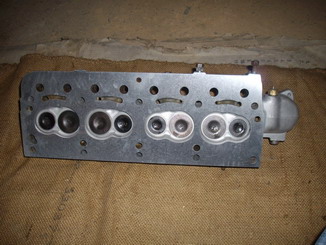

Flibbs mate, that's not the spare, that's the one I took off!
Fortunately I did get a spare with the deal, so I took the pair of 'em to Canberra today.
They prettied up the spare (less corrosion) 'while I waited'.

Very better! Amazing what a good bead blast, valve grind & shave will do.
At least it's clean now! :idea:
$240. Pretty fair.
The original head is not beyond saving, but will require a bigger spend. Sometime.

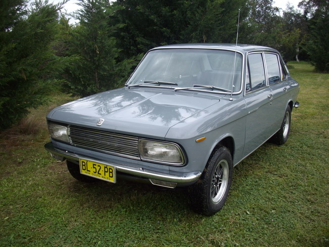

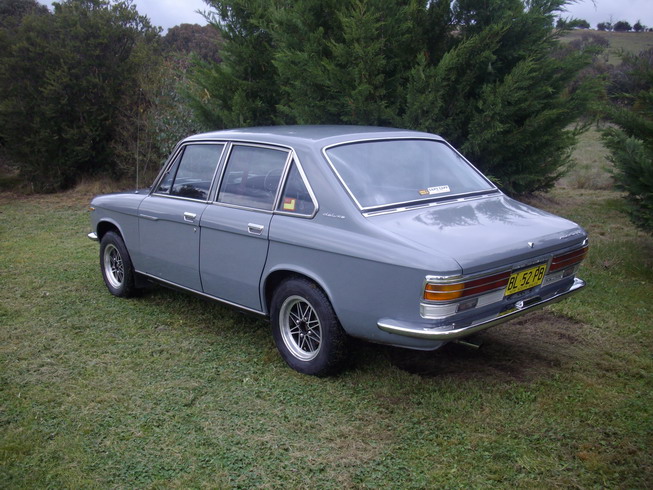

So today I got to take the photo I really wanted! :D
Plates affixed!
8-)
A third trip to Young in the rain, but this time, NO OVERHEATING!, NO faultering, NO dramas!
Passed roadworthy, then to the R.T.A., and I only had to go back 3 TIMES to obtain the plates! :o First, the hand written reciept wasn't good enough 'cause it didn't have chassis & engine numbers, previous rego details, colour, mother's maiden name & what she had for breakfast! :? So, off to make a stat dec, then back. Then there was 1 digit wrong on the green slip. Can we change, sign & date it, then tell the insurance company? NO. Back to the office, tear it up & start again.
Ahh, you all know how it is!
But now, :D :D - Have plates!

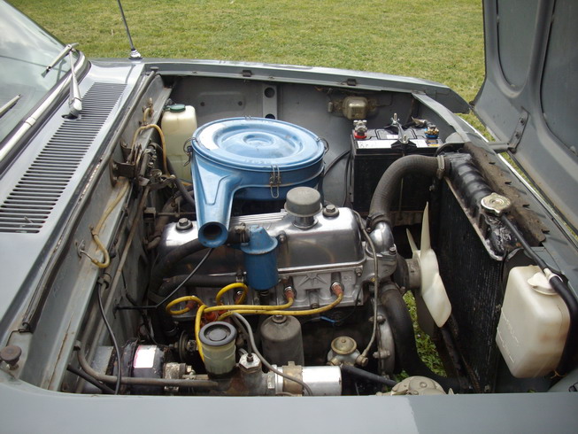

The overheating? There was STILL crap in the block that flushed through & clogged the radiator.
This time, I ran water into the inverted bottom radiator hose, while blasting compressed air into the block drain hole. HANDFULLS came out of the thermostat hole!
All clean now!
And the faultering? There was crap in the main jet AGAIN! (Third removal of carbie).
So I took the top off the fuel pump, and those recesses were FULL of brown crud. (There was no mesh screen on the needle & seat inlet fitting.)
Cleaned that out, and now ALL SWEET.
And the motor is a bit cleaner-
