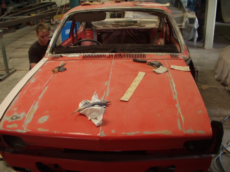

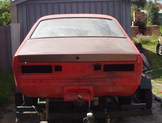

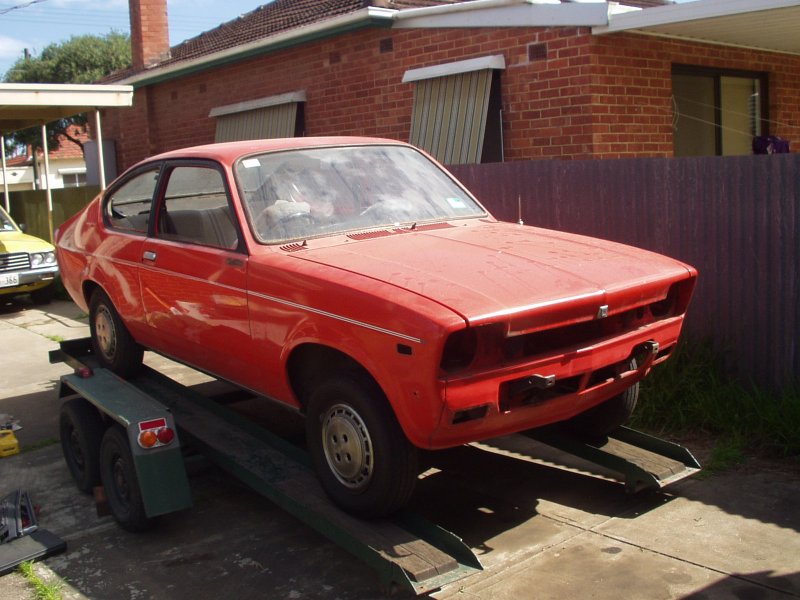

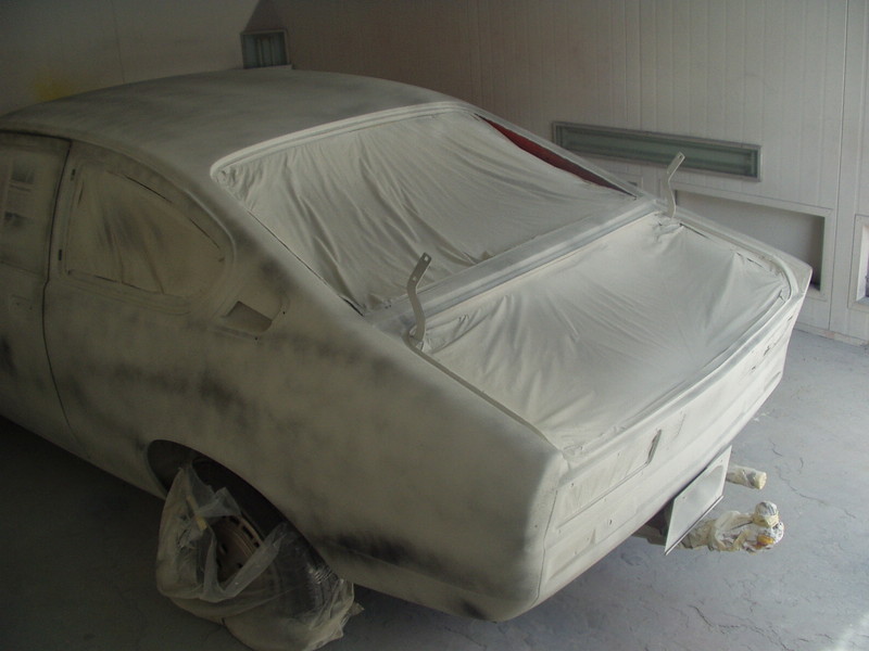

The car originally had rust along the back of the boot and through it that aligned with the frame. I took these photos after I had replaced the boot with this brown one, so the brown boot was the first step toward repair. There was a bit of damage to the bumper, and a bit of dent in the back, as well as more of a chunk above the left rear wheel (not pictured). These pics are after I had started stripping it for the body and paint work.

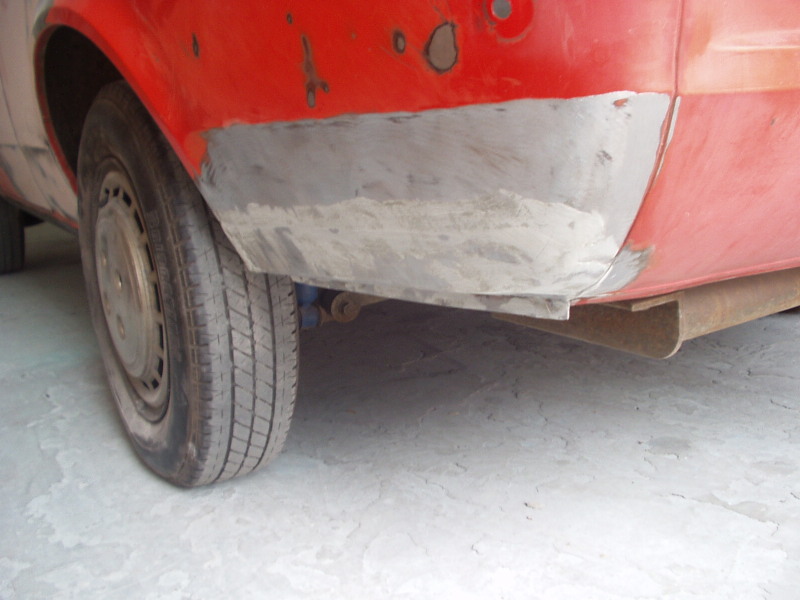

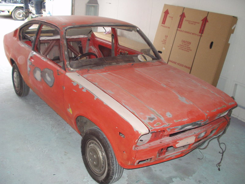

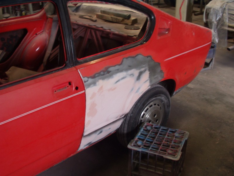

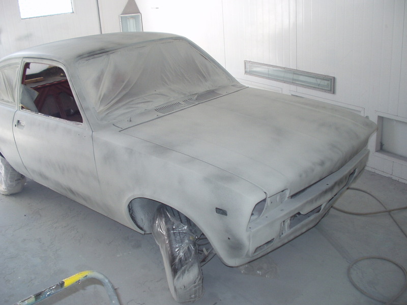

At the paint shop they took it back to metal where it was needed, fixed the chunk over the wheel, replaced the front left guard, fixed the boot rust, replaced the fuel cover, and generally made the body perfect.

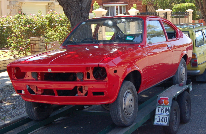

Then she was under coated and painted ferrari red (goes faster) :lol:

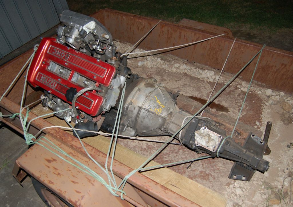

a good condition twin cam engine and 5 speed box was sourced, which also happened to have a suitably coloured rocker cover for my car. The engine was seen running but the ECU was not supplied. (Damn that was a mistake, blew out the difficulty and costs way more than I expected!)

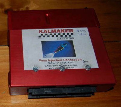

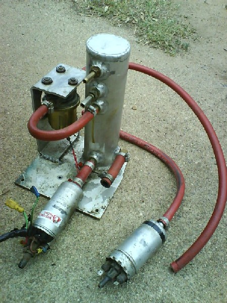

I sourced a Kalmaker ecu package, and a fuel surge tank (to later discover that all pumps had seized)

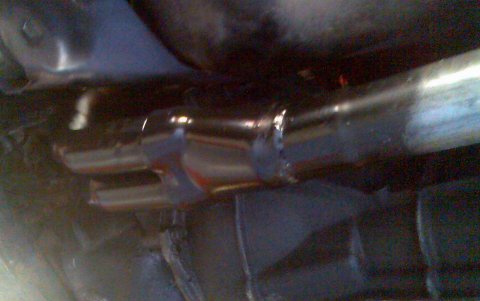

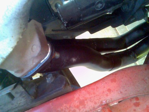

This 2" exhaust was sectioned on to the headers:

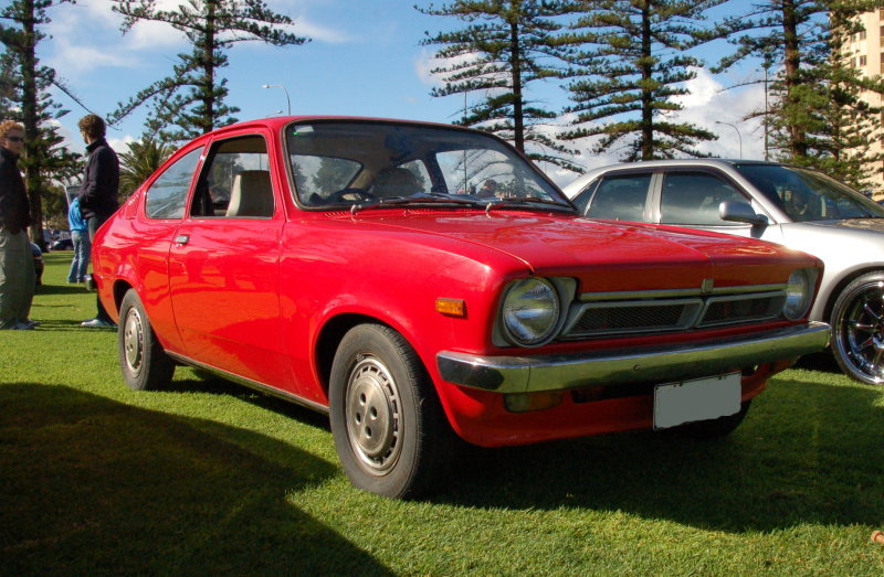

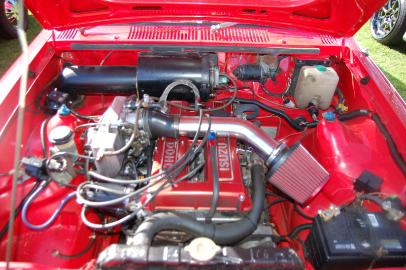

And finally I spent a lot of time on the EFI and eventually gave up and spent much more money than planned down at graham west workshops, who to their credit did an awesome job, got all the bugs out of it and I ended up with this.

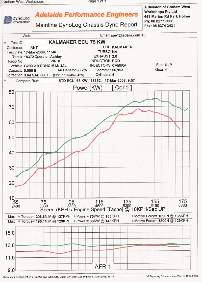

Latest mod, front king springs, and double standard anti-sway with back to back d-clamps to attach the second to the first. 2nd also has ends angle grinded off to make room. Result is much improved handling! Couldnt believe how much of a difference the front suspension makes, even to body roll down the back end! Very happy :) Its also got a cusom +40% heavy duty clutch now, too :D
Also have a new free delco realtime software lined up for the ecu instead of kalmaker in the coming weeks. Its being developed over at www.delcohacking.net with the intent of being a good cheap solution (only costs are for junkyard efi gear - JE camira in my case, and the realtime board ~$200). It wont really improve anything compared to kalmaker, but efi hacking is another hobby :)
