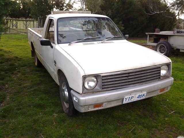

Hello, what have we here?
A Rodeo! Hmm, letsee, Diesel. A longbed. From 1982. And...

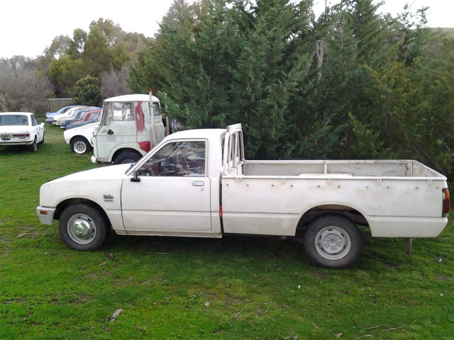

Column benchy. Nice.
Well jump on the line then!

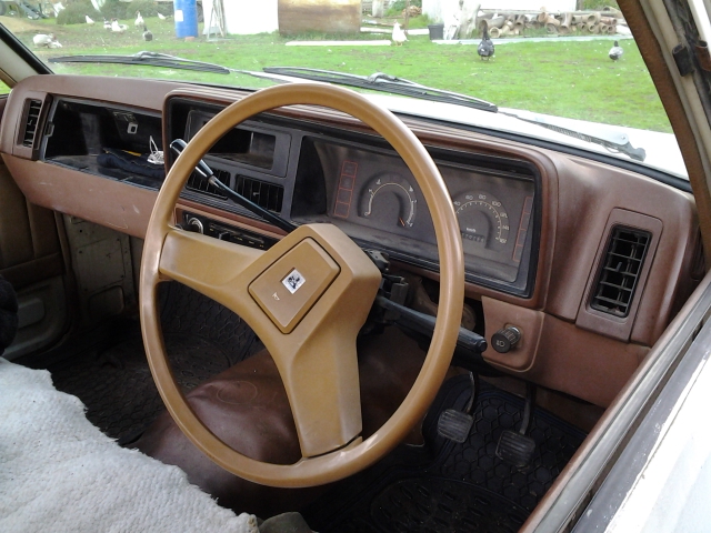

8-) Matt.

Sorry fellas, I understand the mixup as I posted under My Isuzu, but its not actually mine.........well not yet. It belongs to a mate here, and he bought it for $1. He is away on holiday, so left it with me to see if its worth fixing. It was only getting 3rd and 4th gear, and the clutch was slipping worse than a worn Hydramatic. The previous owner was starting it each time wth aerostart, which can be dangerous for diesels.
So I put a couple of hours in. The linkage bushes are worn, but I got enough adjustment to get all the gears, even reverse! (Reverse is very handy!) I adjusted the clutch cable, and amazingly it drives without slipping. Tough things these! I probably wouldn't put a tonne on it, but ok.
Now to find a set of glow plugs, and maybe a rearview mirror and sunvisors. They are all tied up with tie wire as they fall down & flop around.
All good fun,
cheers, Matt.
