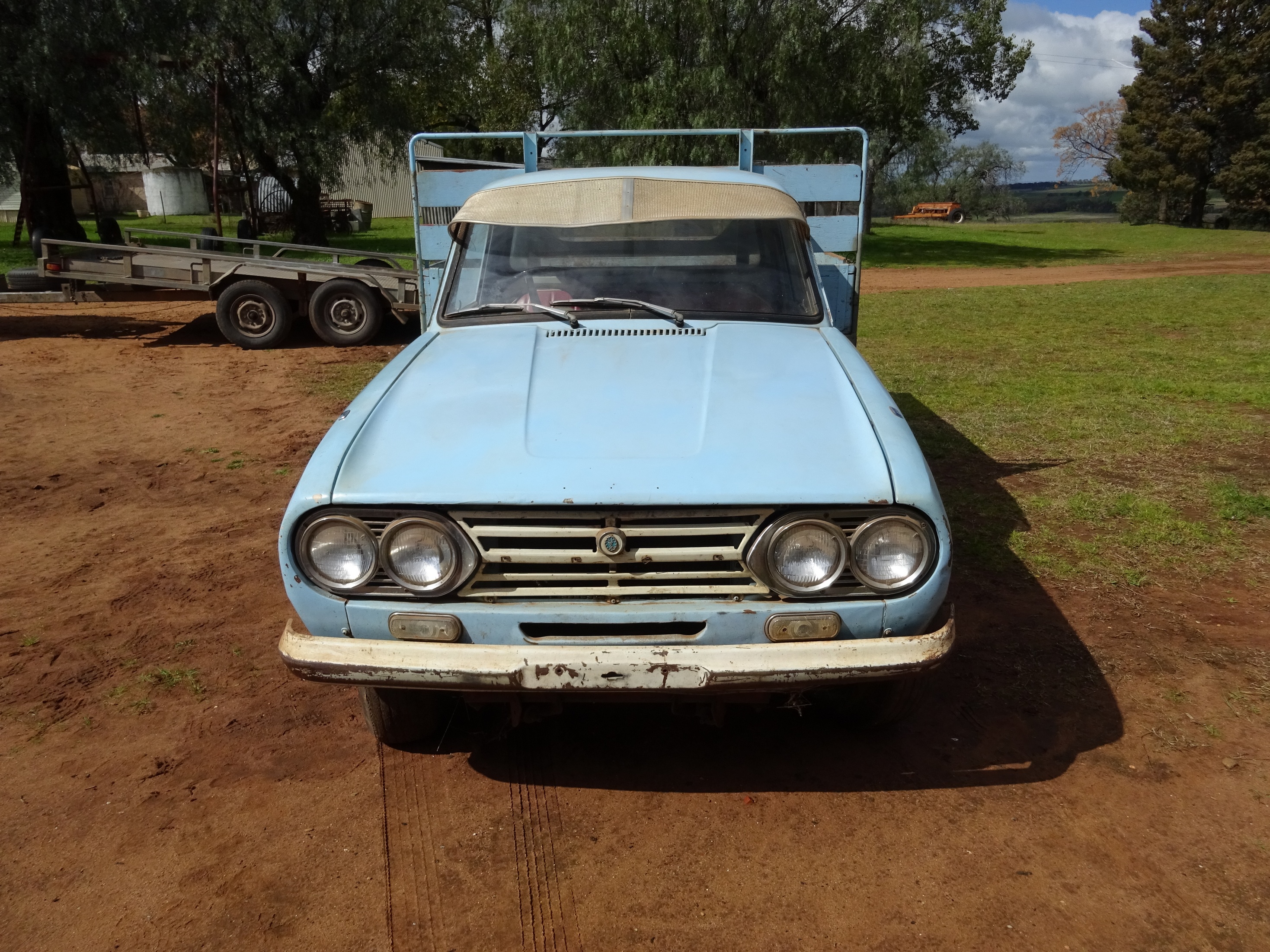

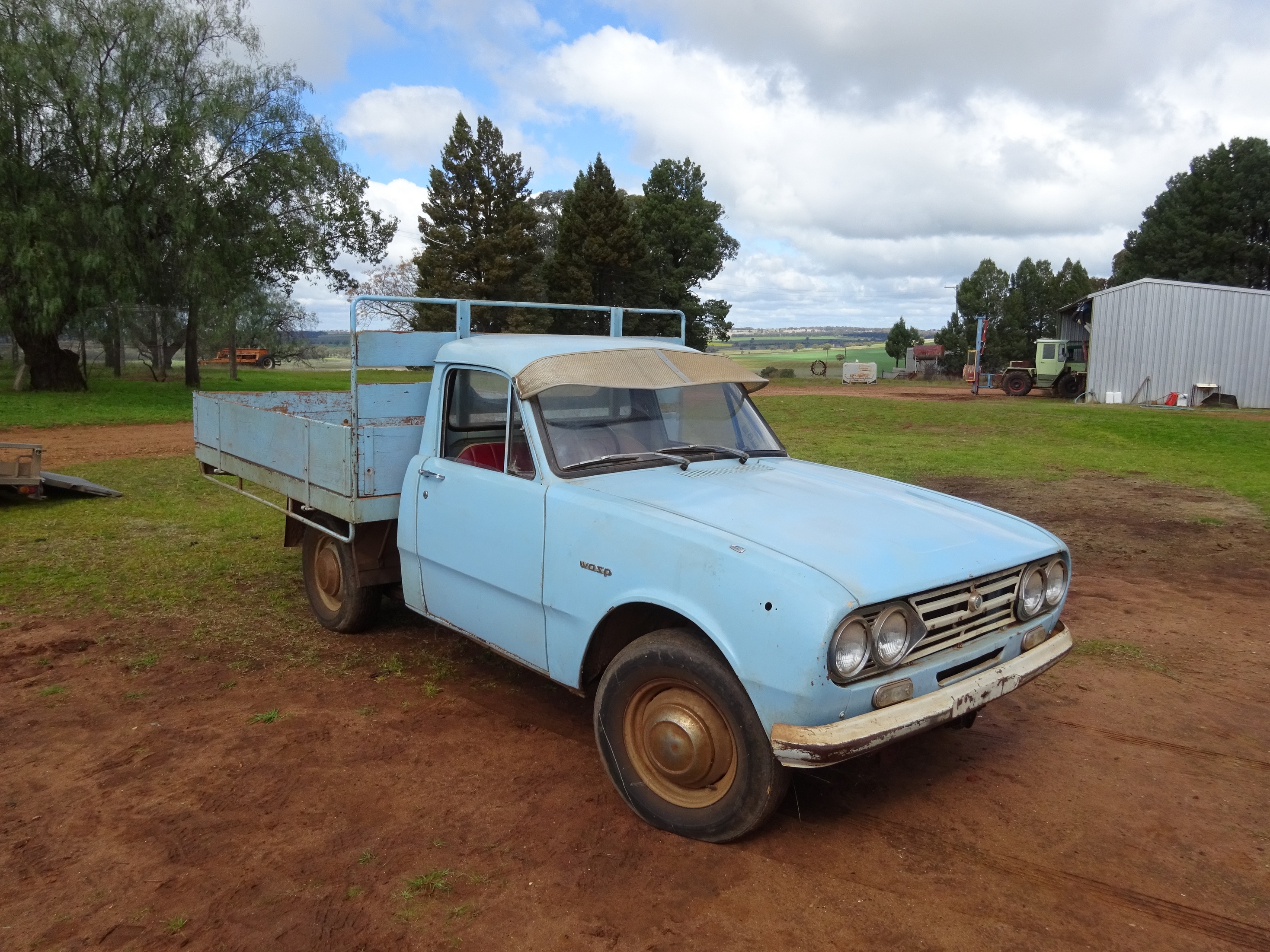

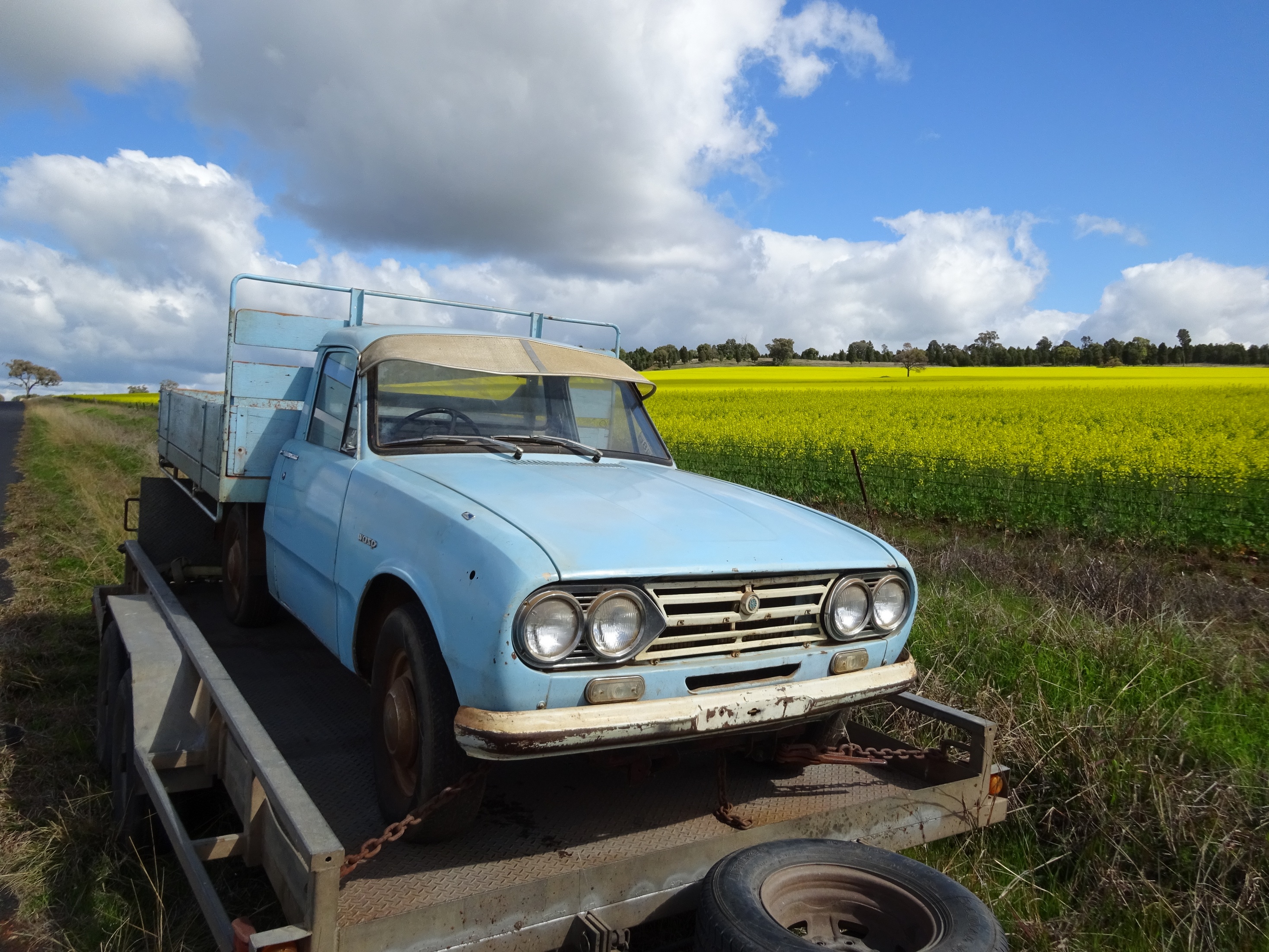

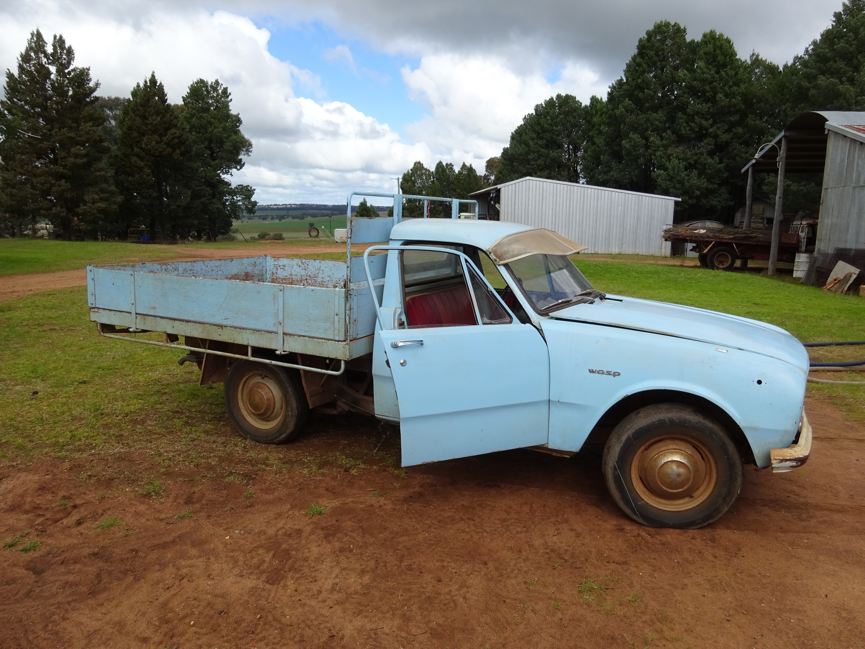

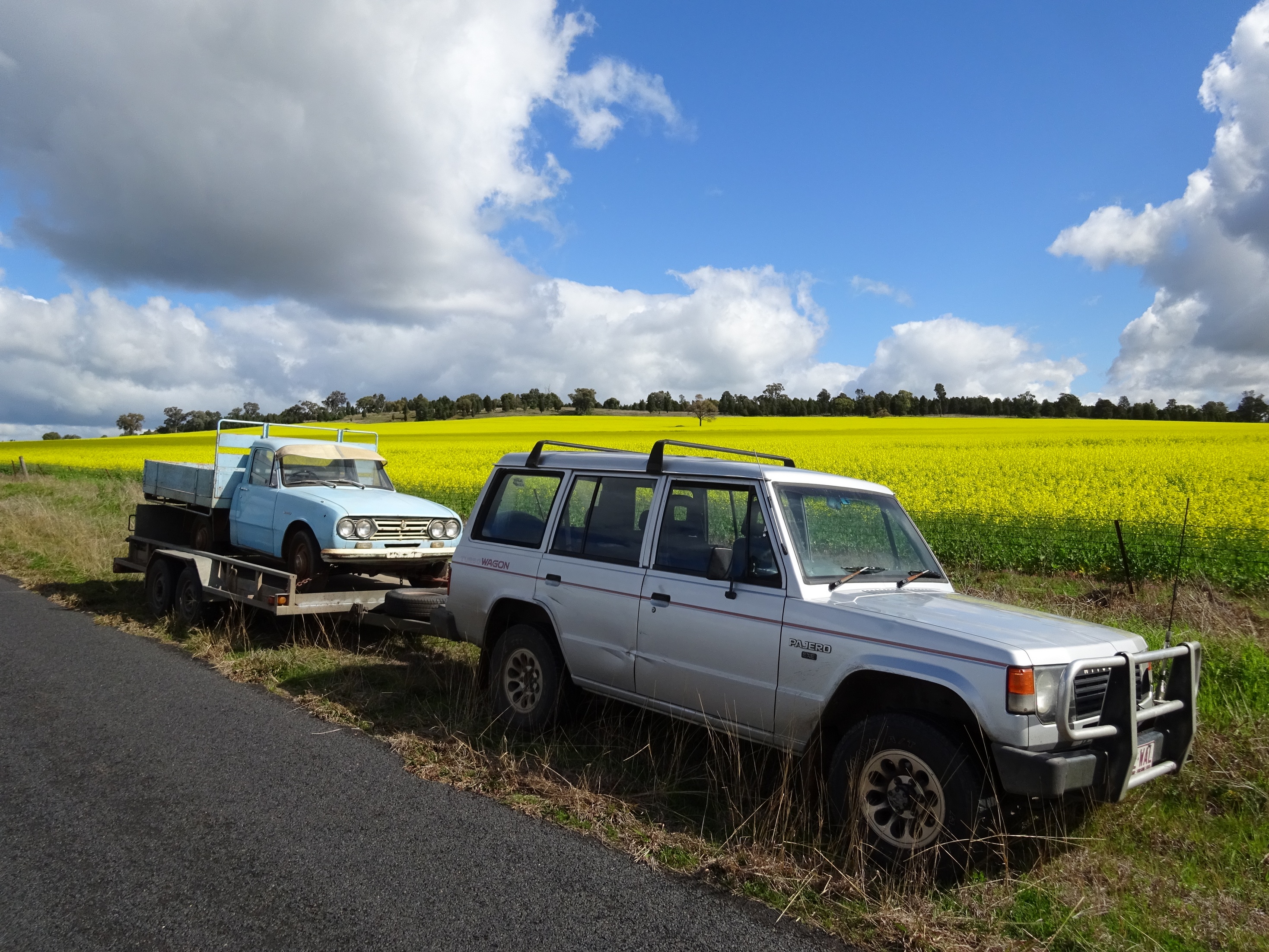

Some pics from the day I picked it up and the road trip home..... back roads style :mrgreen:

Last time it was rego'd was 1981 and the sticker is still on the quarter window :P

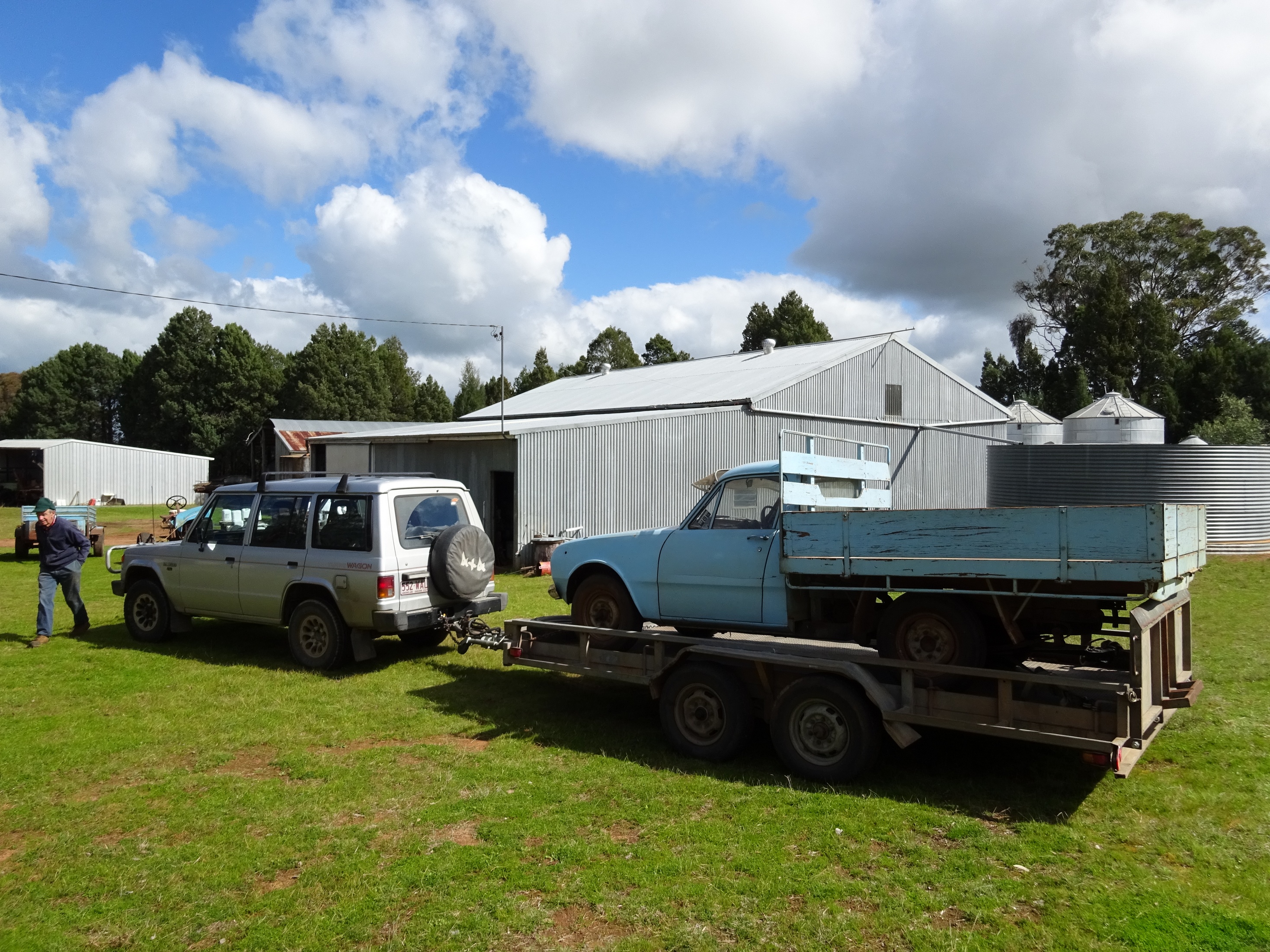

Loaded up and ready for the journey north to live with Donkey

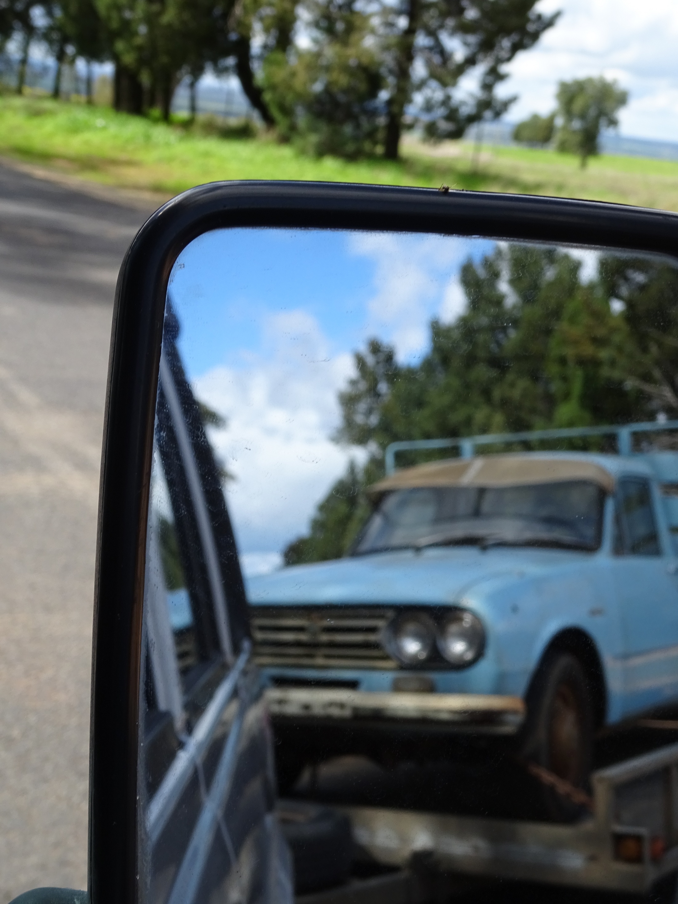

As I left I couldn't stop looking in the mirror and smiling like a Cheshire cat.

I drove for about 10 miles before I had to stop and take some more pics of my new baby..... best 5k I've ever spent :D

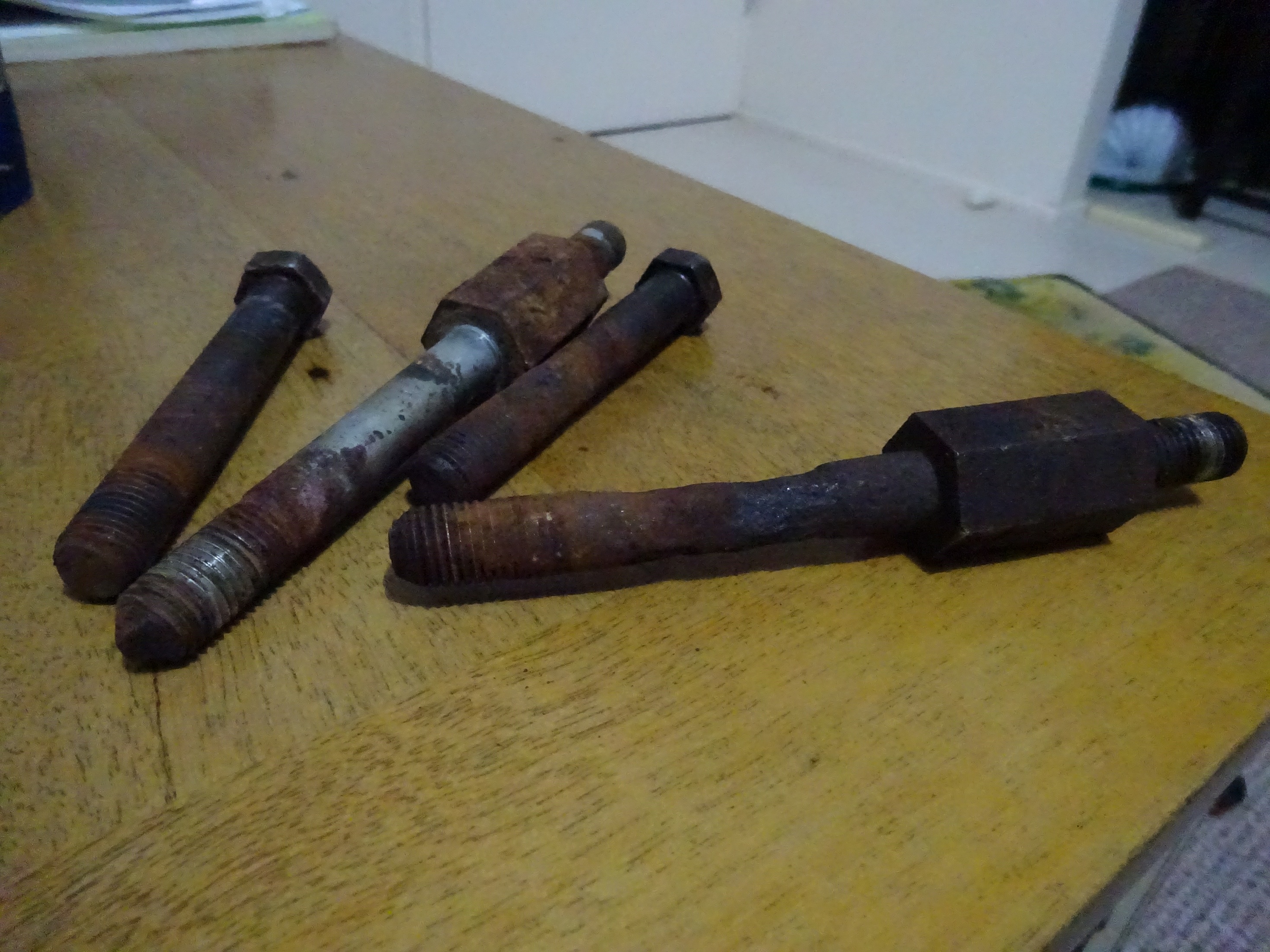

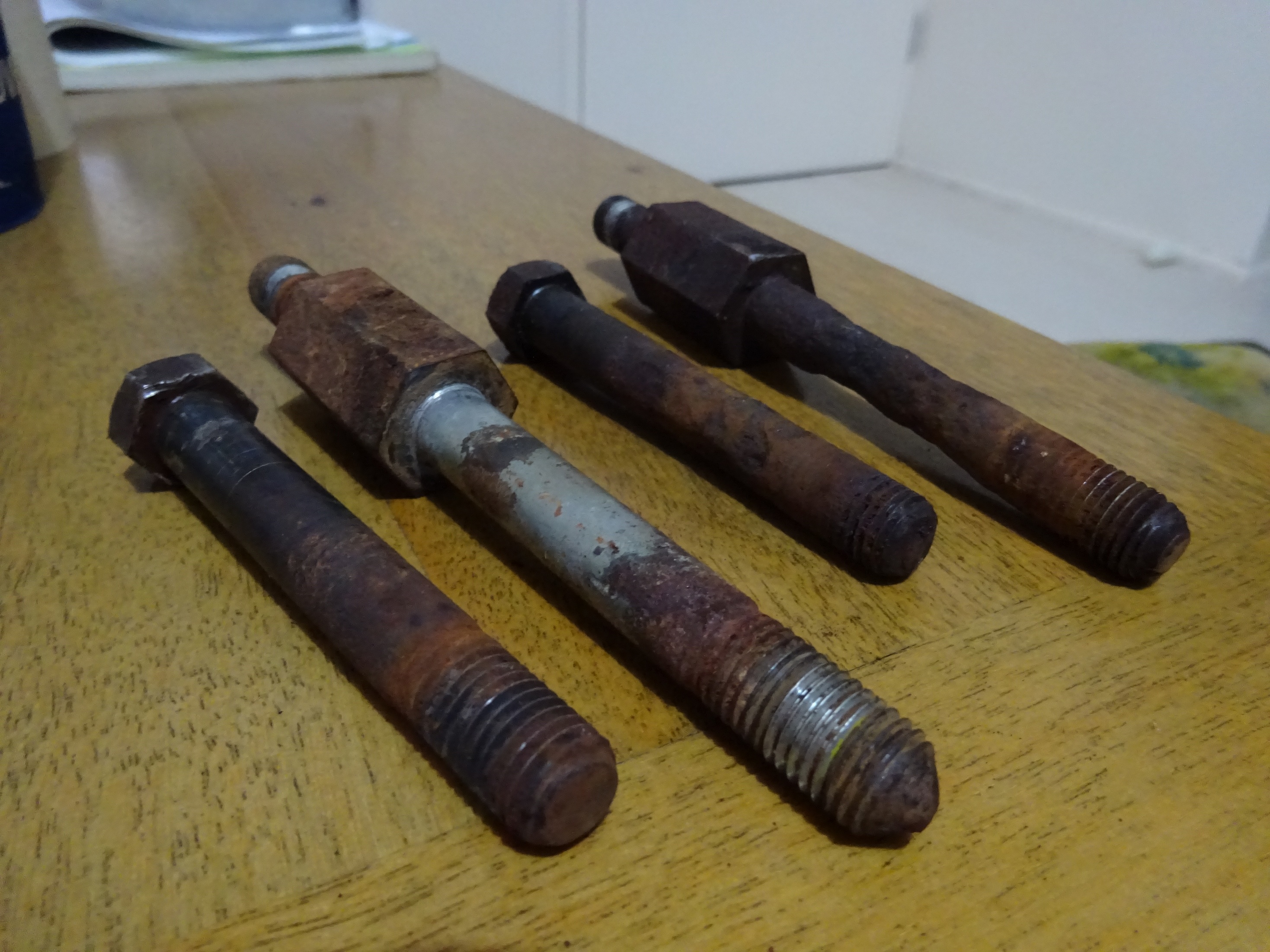

I took 4 1/2hrs to get the drivers side lower ball joint out :shock:
Never in my life have I had one that tenacious.
Two of the bolts were we and truly rusted in tight but persistence, a bottle torch, pinch bar, hammer and a few beers eventually paid off.
Does anyone know if bolts like these are still available off the shelf somewhere??
If not I'll get a mate to machine me some up

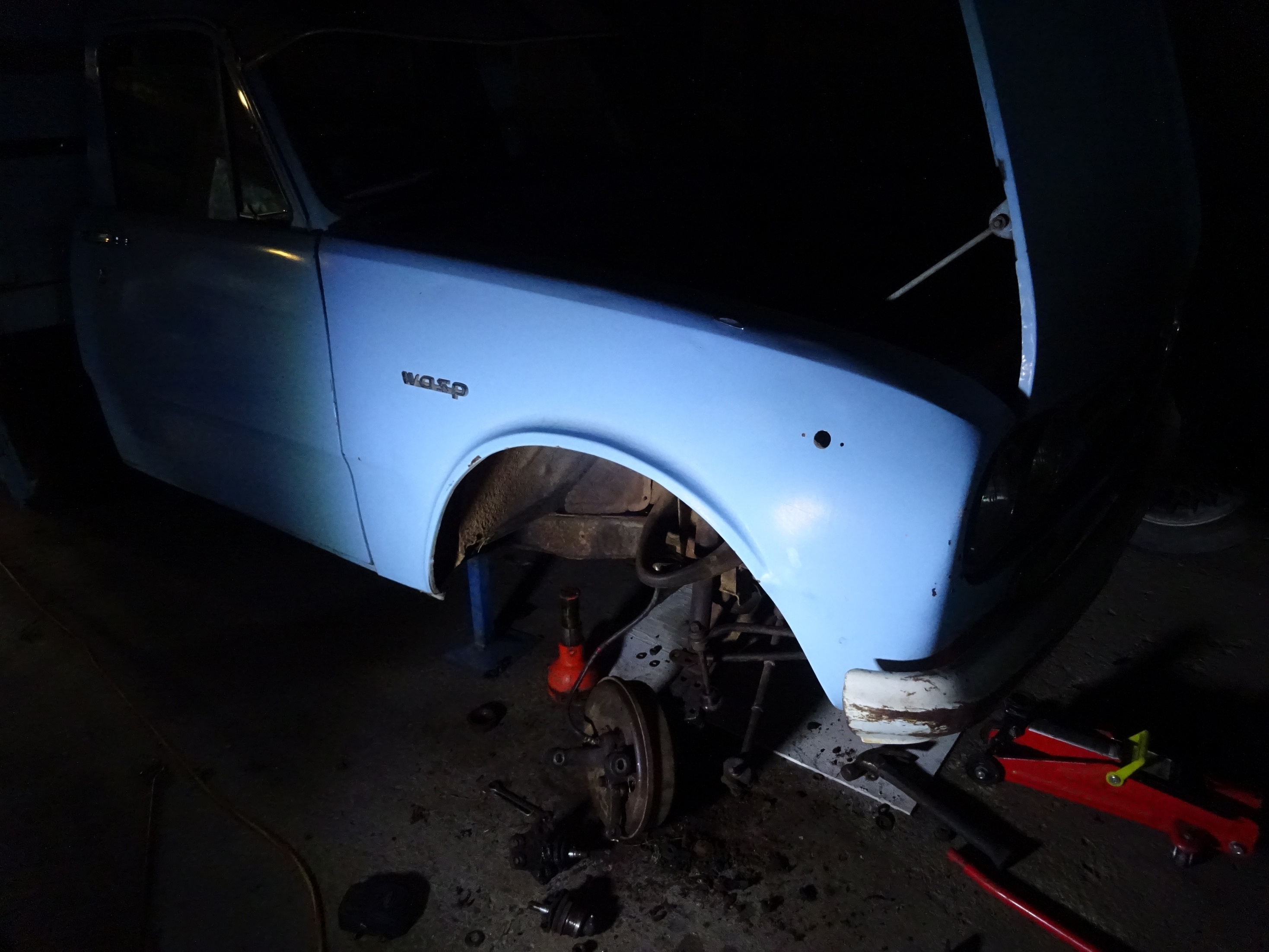

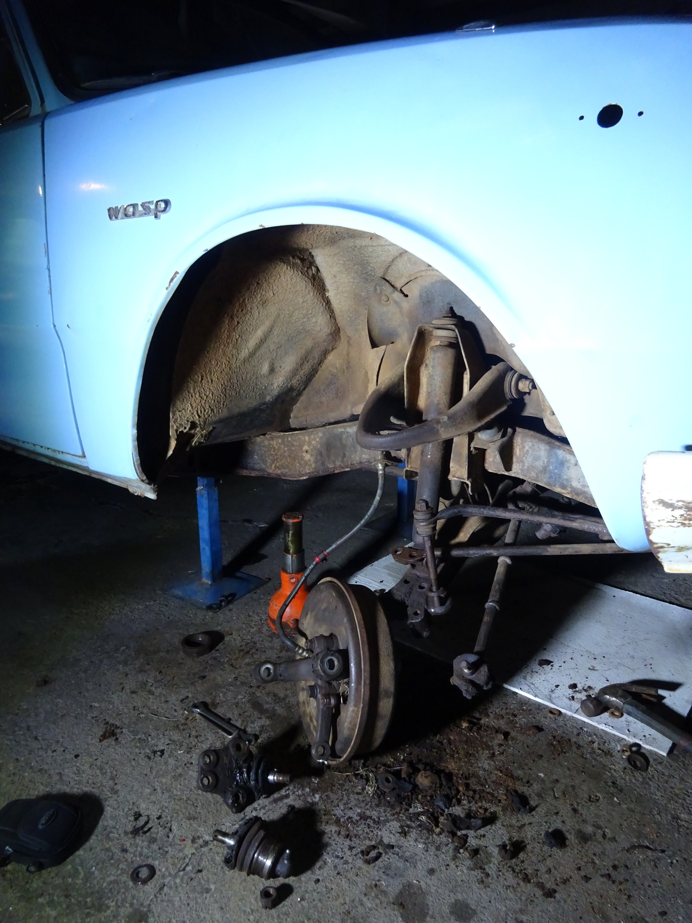

Progress on changing the ball joints has been painfully slow.
I couldn't do anything in last weeks deluge as I had a few inches of water through the garage.
This however pales in comparison and seems quite pathetic when compared to the Glen and Elaine Potter who had 14 foot of water through there place at Murwillumbah :shock:
I did finally get all the ball joints out but finding replacement bolts has been proving difficult.
A mate of mine will be machining me up some new ones but it will be a few weeks before he can slot it in so things have ground to a halt again :|
The lack of lighting under the house makes it frustrating too as I have to work with lead lights even in the middle of the day.
These couple of pics were taken at about 2pm on an overcast day but sunny days aren't much better
