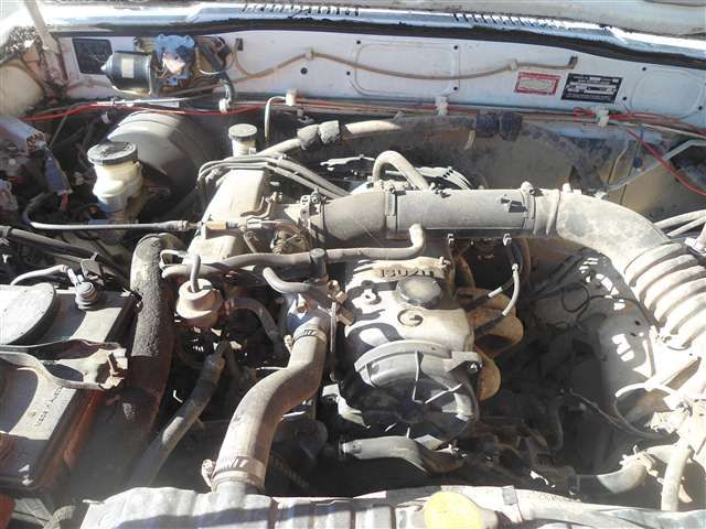

Anybody know if the inlet manifold from a Jackaroo will fit on a G200 DOHC engine ??
they look similar but I am not sure if the engine side will be the same? (probably not !)
If I can get the 117 engine it has the manifold that won't fit a bellett. Need to change to the ECGI type.

answer is NO fit
Sat Aug 04, 2012 7:41 am
Bugger.....
not even close ?
adapter maybe? cut and shut ?
thanks Greg

I'm looking way in the future here at moment. Prime reason to get the 117 engine is the gearbox with idea maybe one day to fit the DOHC to 2nd car if it proves to be worth re-building.
Was planning to go the Astra/Camira Delco computer conversion route for the efi. For that i need the ECGI type manifold or 2nd choice, make my own but that won't look 'factory'.
Or if can find some GT type carbies, just fit them !

nope. manifold isn't even close.
those 4z series manifolds are interchangable with G-z gemini series engines tho, and we all know they won't fit a G-w.
Glenn.... how bout Weber manifolds with 4 throttle bodies? gives a carb look and sound, but advantages of EFI.
talk to Gavin and Ross about Delco too. Ross has done a few and swears by it, and your old white GT that Gav has is Delco'd now.
