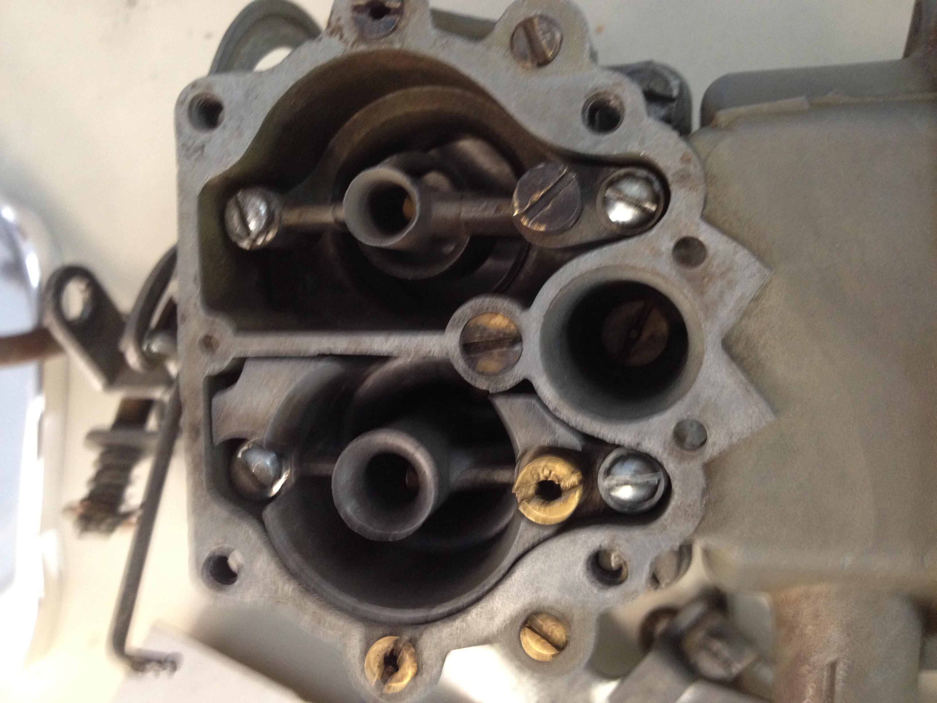

I completely disassembled the carburetor from Suzie Belle for a cleanup and new parts kitout.
At the top of each throat there's an air nozzle needle thing about an inch and a half long, with tiny air holes at the base of the needle. One has a hole in the top and one has a hole in the side, near the thread.
I stupidly forgot to check if they were different when I pulled it apart for cleaning - they are!
So can anyone tell me which side which air needle thing goes on?
I'm uploading a picture with this - it might not work though.
Any help or advice would be greatly appreciated, I'd love to put this thig back together and get her running!

Sorry for the blurry pic. The bits in question are the brass slotted thing stamped "60" and the corresponding one above it which is darker and has no hole at the top. This picture is post-cleaning.

I believe you have it correct. These are the Primary and Secondary main air bleeds. The secondary is the one with the hole (on late series carbs) and goes o=in the secondary throat, nearest the fuel bowl inlet pipe.
Sorry about the slow reply, hope it goes well for you.

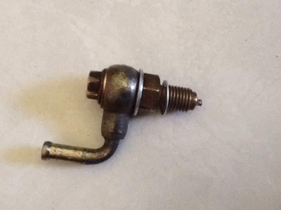

Does anyone have part numbers for the needle and seat assembly (with banjo fitting and seals at all. I have remitted my carb and the inlet needle supplied was too short for my nikki carb.
Attached is a photo of my existing one that I wish to replace. I would probably need a float as well please.

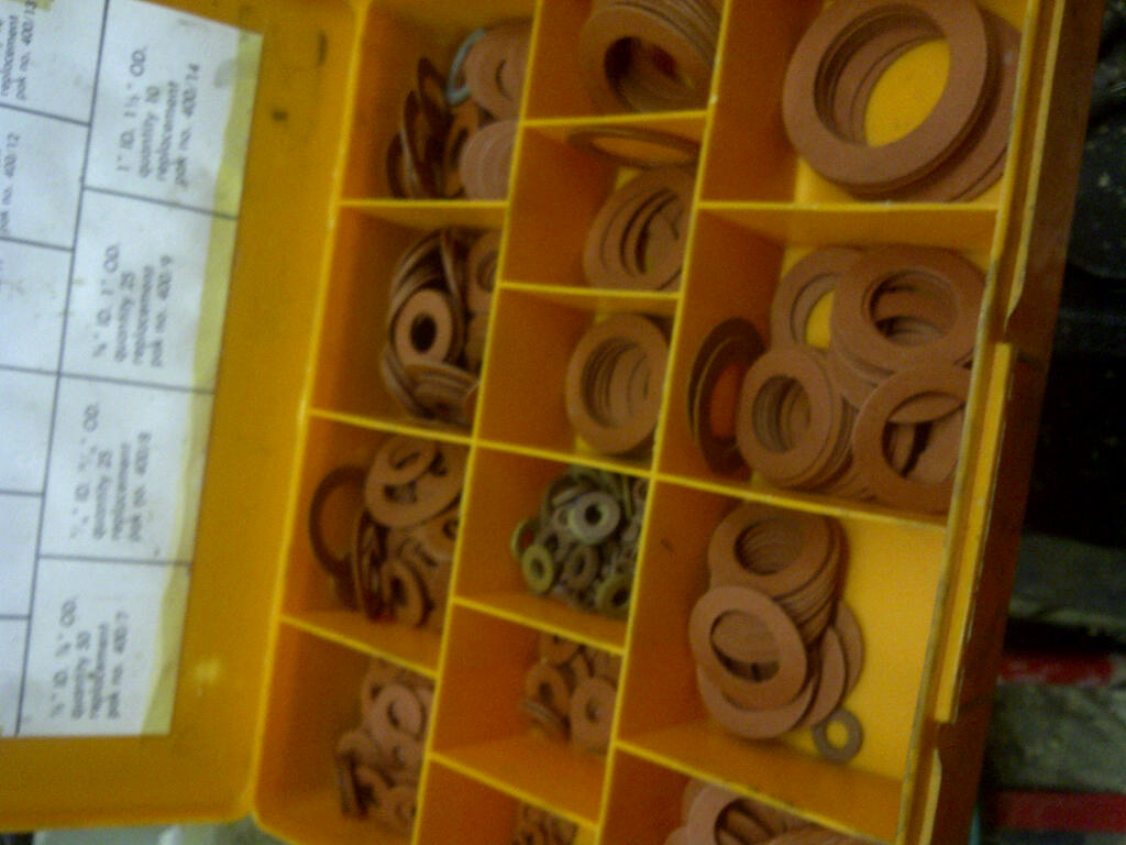

generally you only find those parts as part of the carbi kit, Redback.
best to try some local carbi guys, preferably one which has a few old guys who work there as they are often more help and have more knowledge with older vehicles.
or perhaps one of the forum guys have a few bits kicking about. mine are all old used ones which would not be much better.
most float systems work quite well even when old and brass washers are found at car parts and carbi suppliers.
also can use red fibre type washers like this Grab Kit pictured below as dont get effected by fuel.
Good Luck
