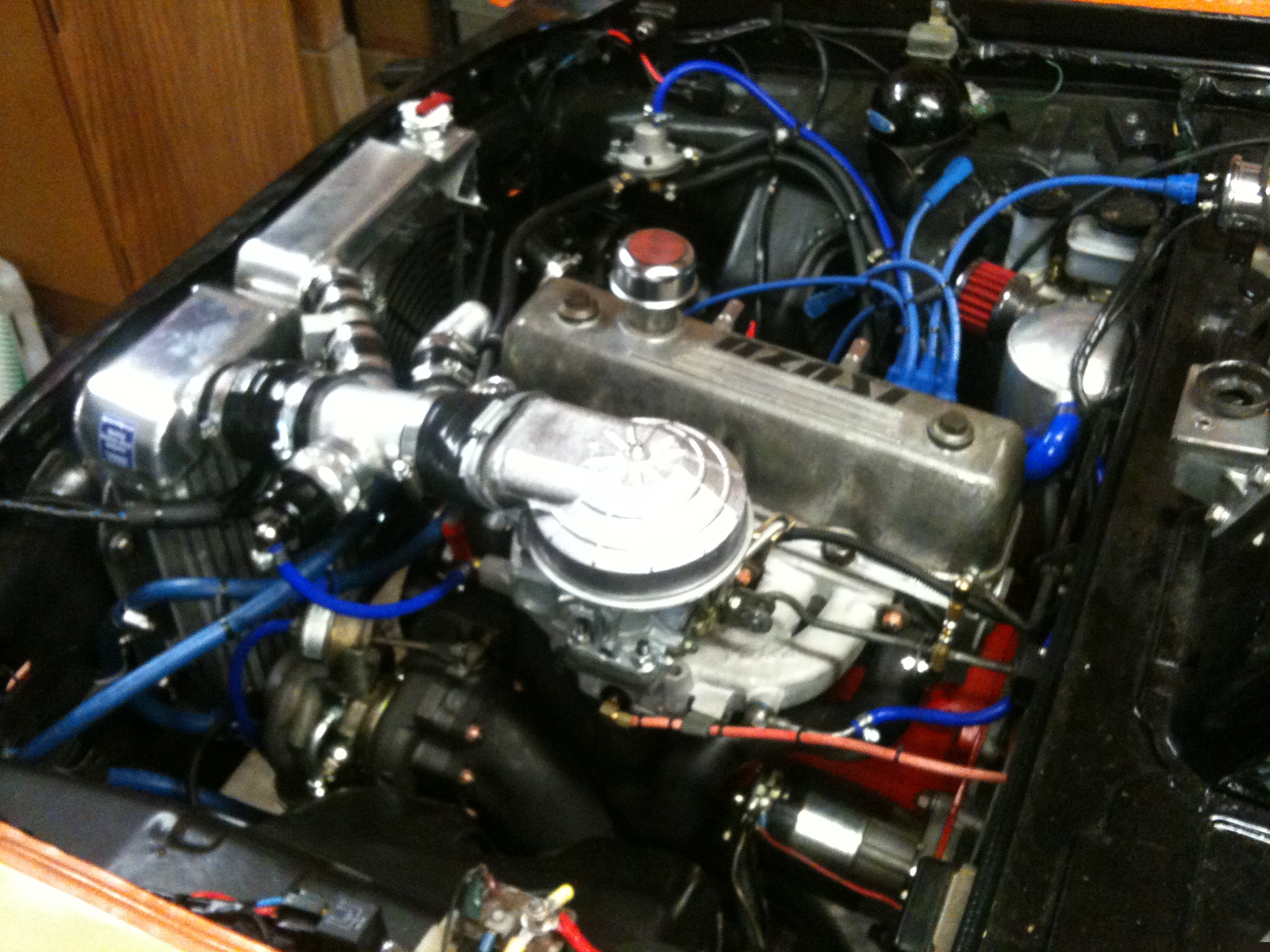

In that case
Feast your eyes
Been there, dont that
JD

have you got a month and a lot of beer!
That's just to tell u how to build it
It took me over a year to make it a reality (actually more like 3) :o
Oh Yea,,,,,,, very deep pockets :lol:
For supercharging check out
http://www.bulletcars.com/

Well for starters
Supercharging is not same as turbo charging
8 lb super is approx equal 14 lb turbo
Far harder on bottom end
With 8 lb and no intercooler inlet temps high
Need to lower compression to approx 7.5:1
Forged pistons
Pref forged rods
Pref sleeved block for starters
? Not enough room to use side draft.. Perhaps down draft like me
That's just inside the engine
Then there is all the issues with fuel pressures
Rising rate regulator definitely for blow thru applications
Surge tank
Remapped ignition
Huge clutch to handle torque
U basically have to upgrade everything
