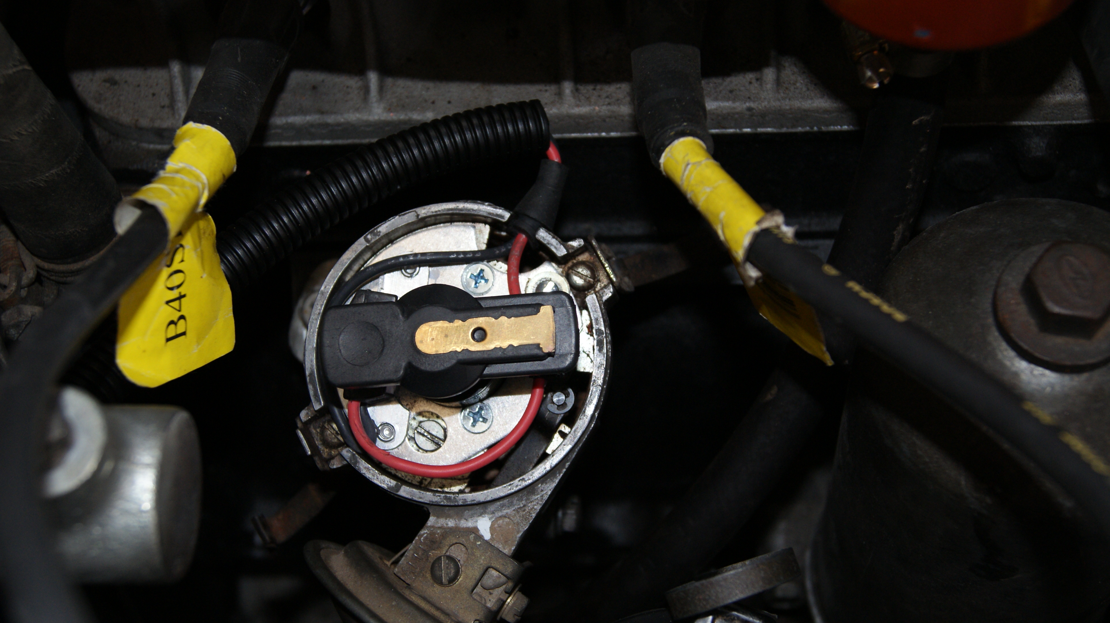

Hi Guys,
Glenn, I didn't have the part number handy. It is from RAE Ignition & Sensors, part #RIGHN.
Farmer, in answer to your question, most people wouldn't even notice anything different. Some of the wiring has been upgraded from the coil to the distributor, but that's the only external difference. The conversion still uses the same rotor button and dizzy cap.
I will try and post some photos later.
Fri Feb 27, 2015 9:21 pm
I hop these photos work. Still no good on computers.

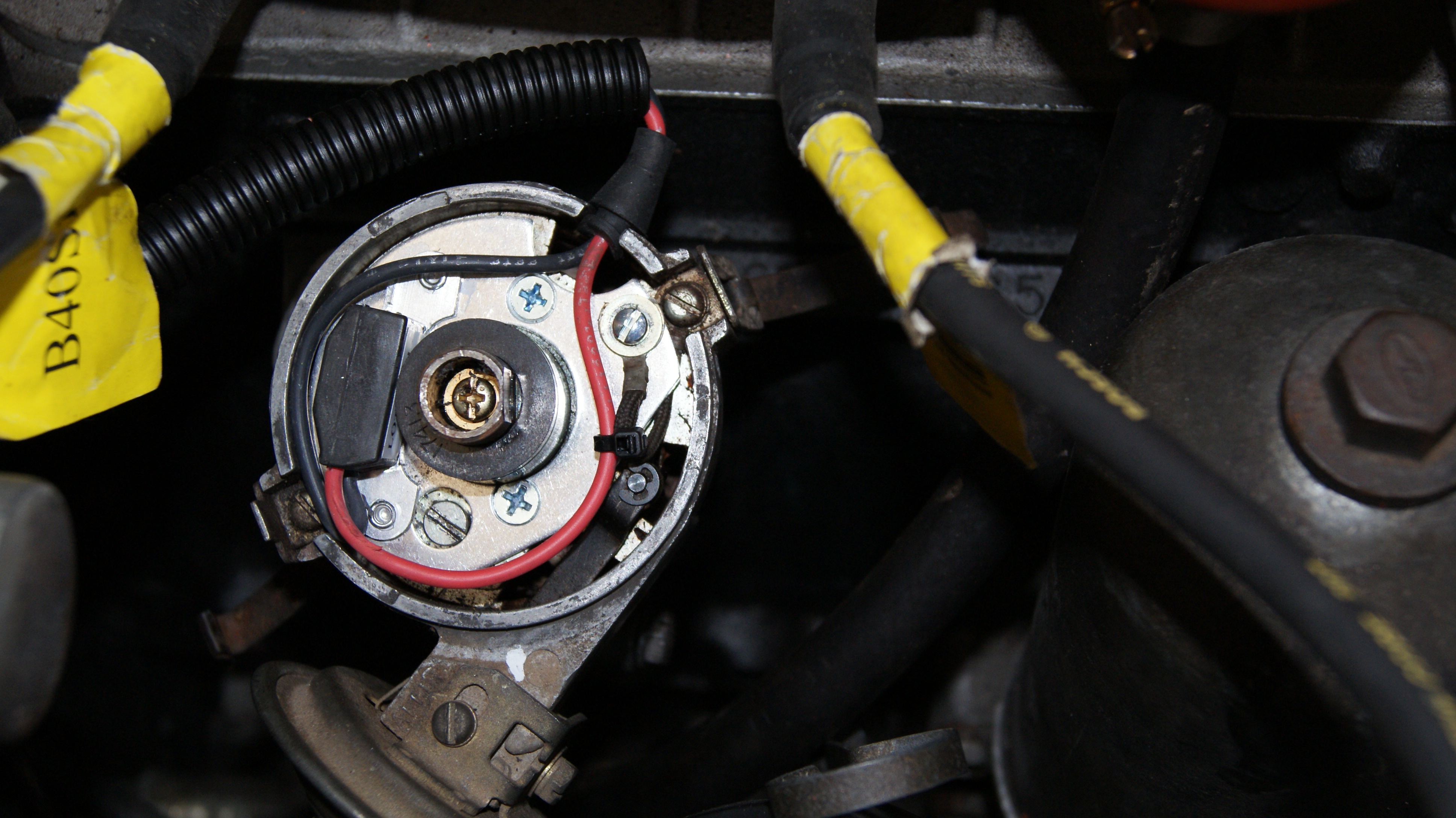

sorry guys, looks like one at a time.

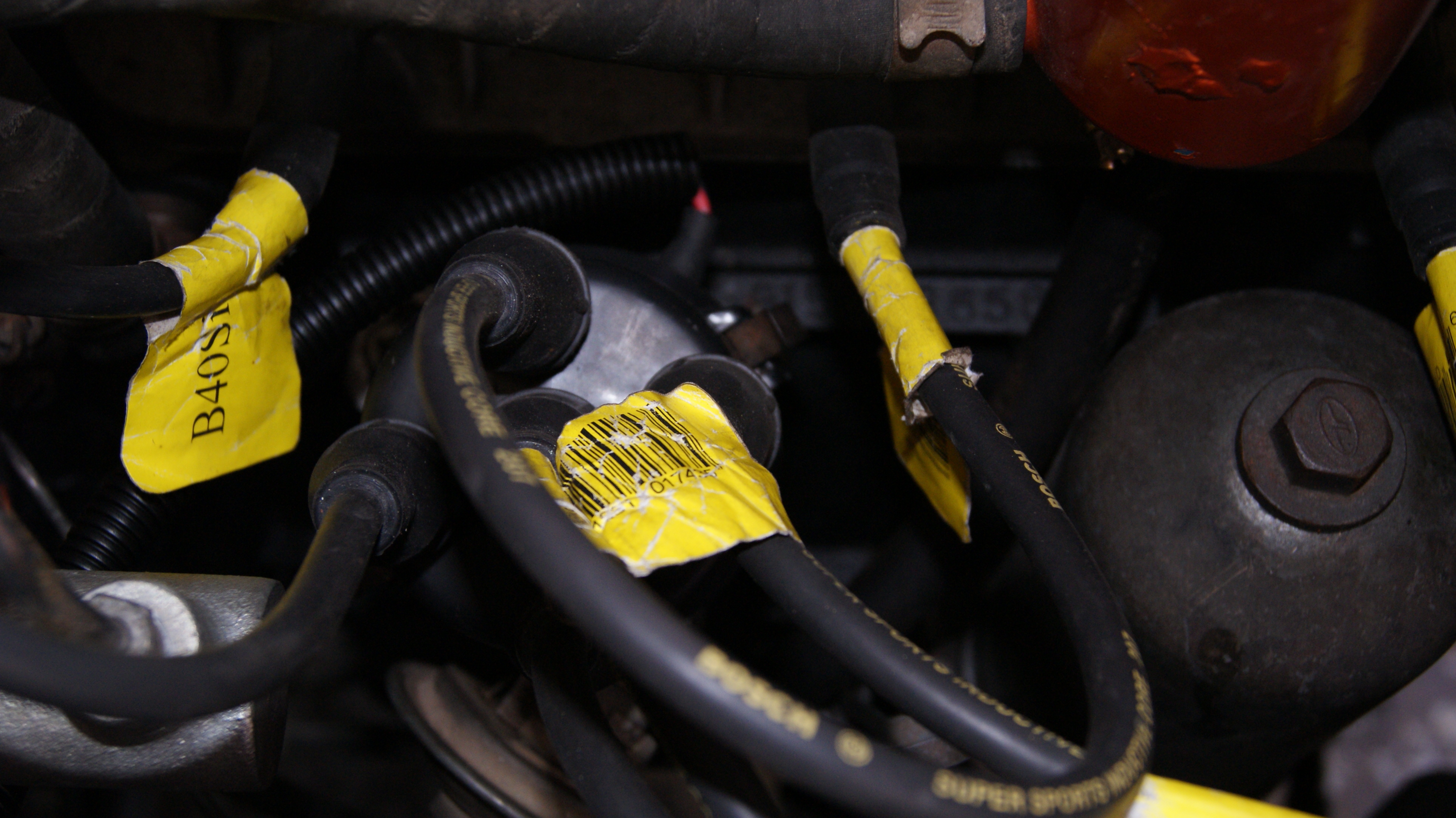

And last one, with the cap on.
