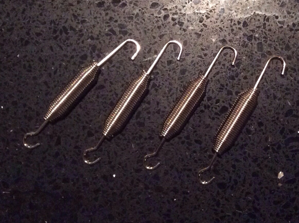

Look what just arrived for my two cars. They are decent quality SU throttle return springs. Chrome plated, ( thought they may have been stainless steel). Come in packs of 3 for $7.90 from SU Midel in Sydney.
Yes, it is important for the carbies to return to idle easily, and make sure the lower bracket where the bottom end of the spring attaches doesn't move....tighten nut well.
Cheers, Lewis
