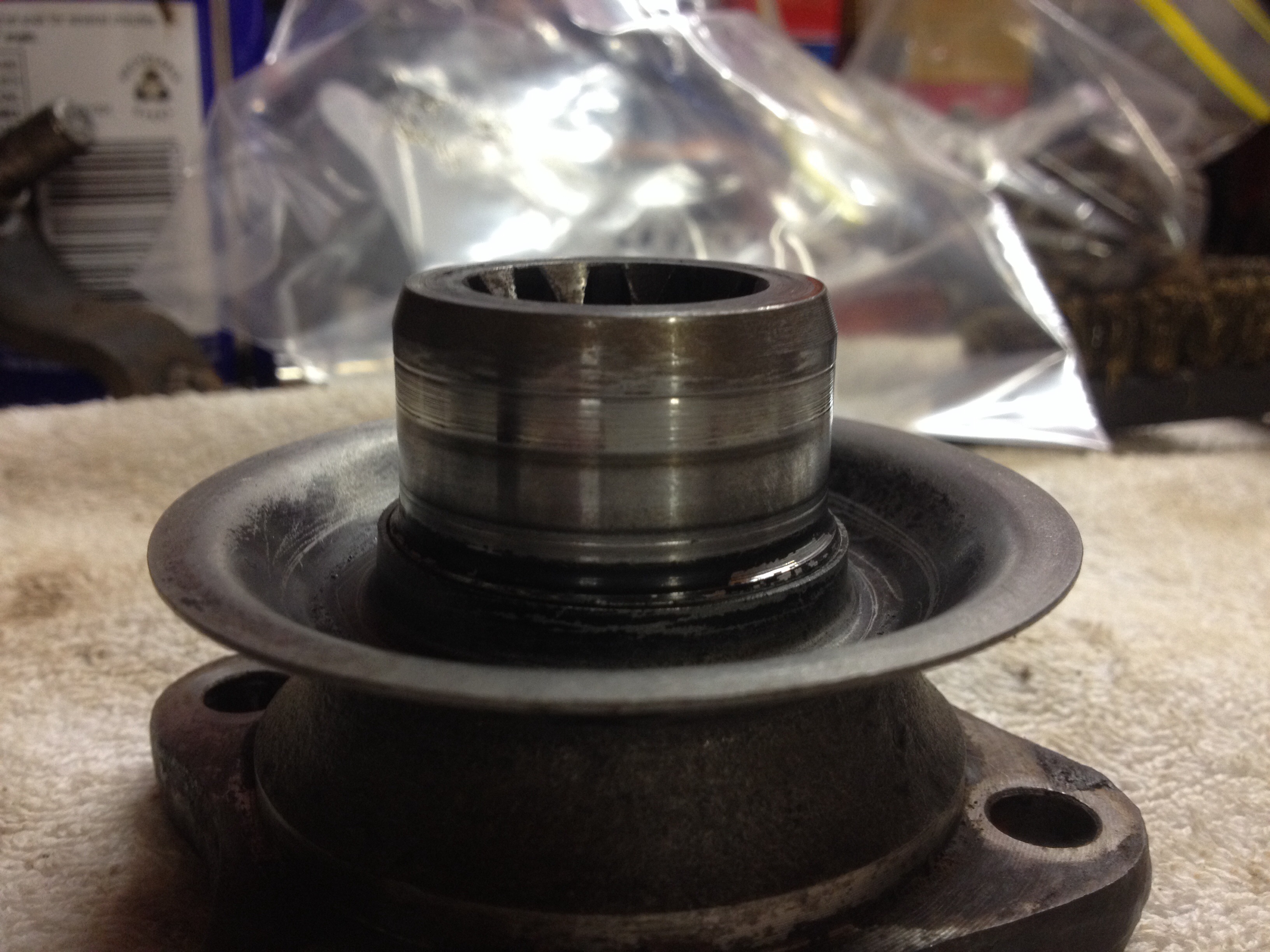

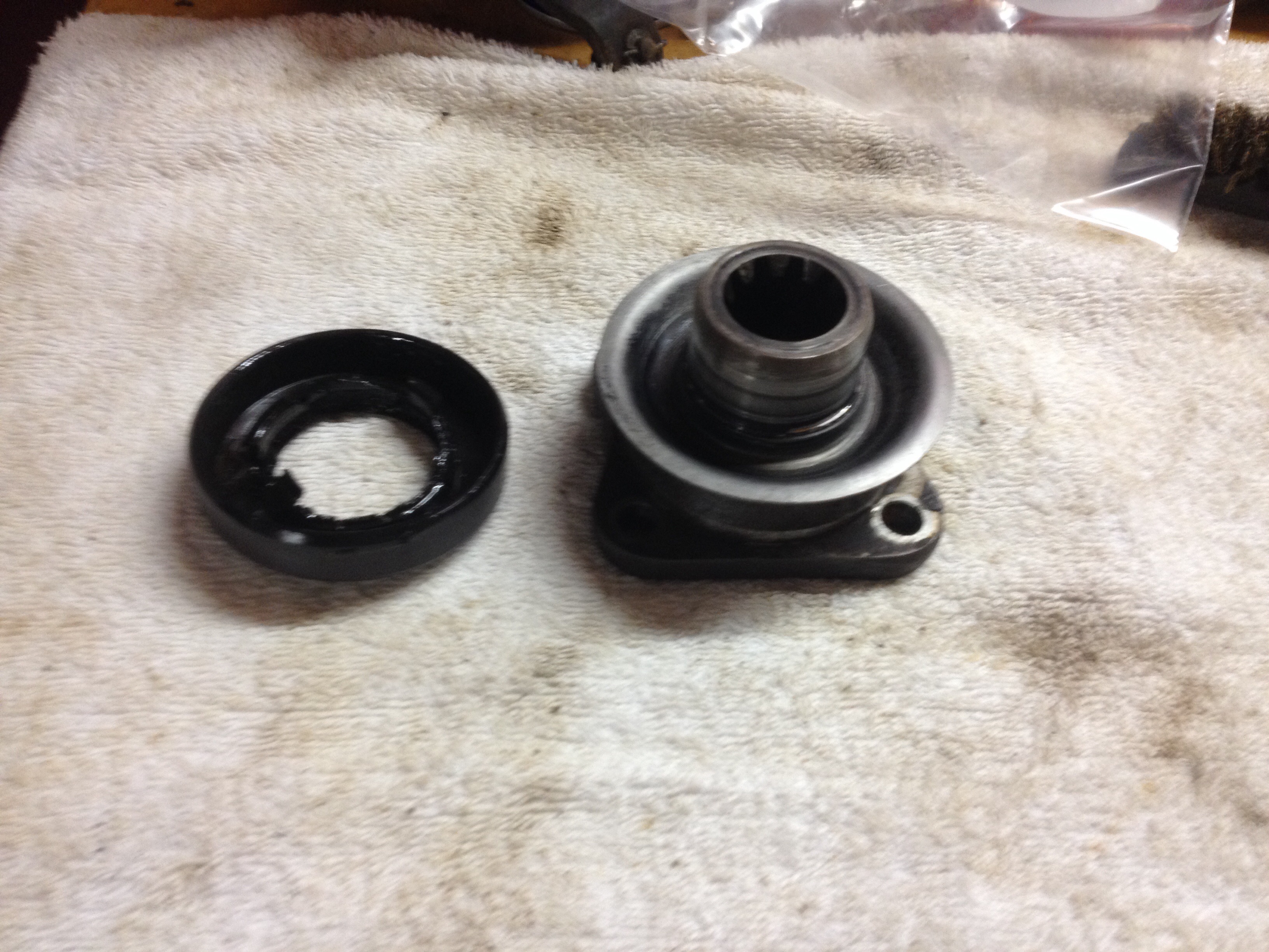

Eureka
It fought me all the way but bit by bit got the yoke off
50 year old Seal hard as hell and a real sh@# To get out lying on your back on concrete at 0' but hey, that's a heat wave in Tassie :lol: ..
The yoke will need sleeving as u predicted I am Afraid

Speedi Sleave
Best invention known to man
http://www.bsc.com.au/sites/default/fil ... 6Shaft.pdf
Thanks Dave
Legend
