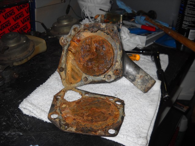

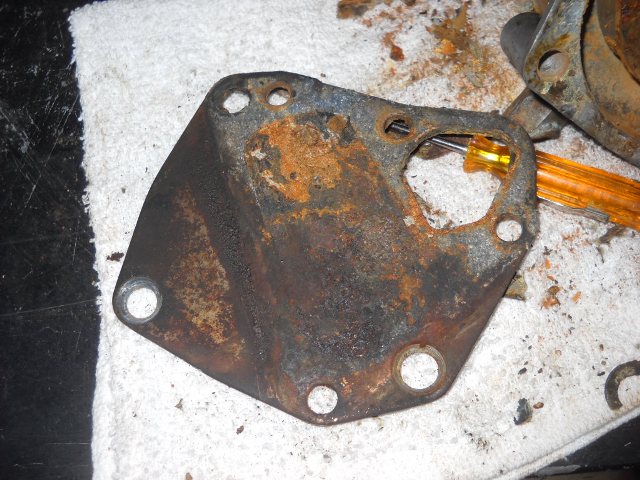

I learnt today the differance between the water pumps backing plates.The plate on the back of the pump in the 5 bearing engine bolts complete with the plate supplied to the block.In the wasp 3 bearing the block has a plate the sits behind the timing gear that bolts to the block this plate also is used for engine mounts,generator as well as the water pump backing plate.We will remove the plate supplied with the pump and bolt it on to Walter the wasps engine plate.

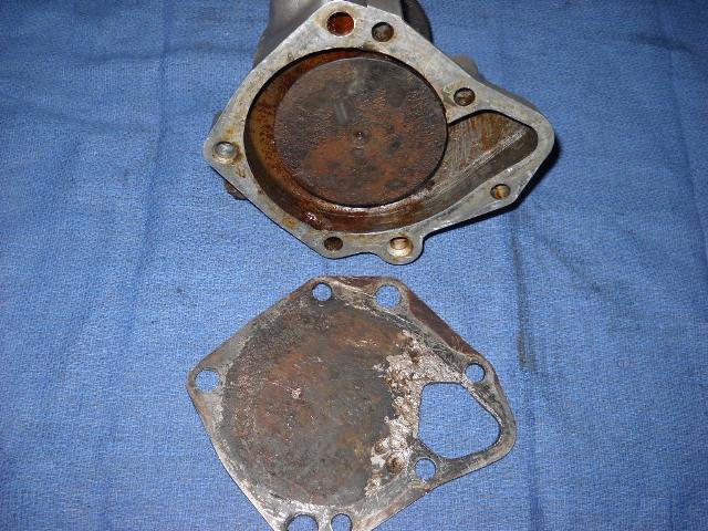

Posts: 211
Location: Florida
Digging up old posts
