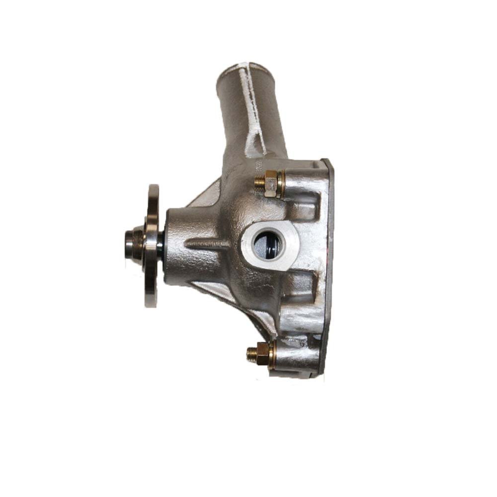

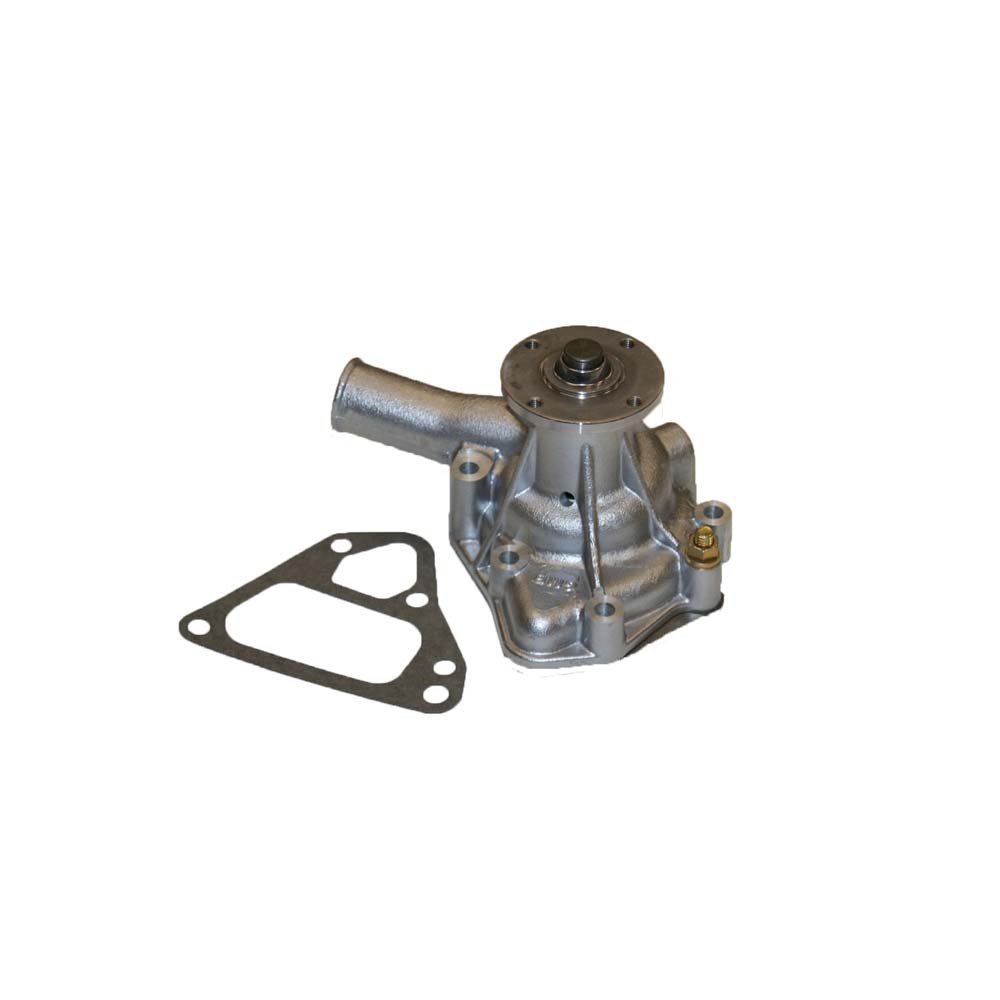

THE WATER PUMP SAGA...........NT edition.
I have ordered 5 water pumps from 5 different online suppliers with "in stock" for Protex WP1001G, GMB GWIS-13a all to no avail.......
"Sorry MR Ingram - our guys went to pick your pump off the shelf and there was not one there....." REFUND GIVEN -
or
"We don't have the Protex available but we can give you a GMB version" - a few days later................"Sorry Neil blah blah blah......." REFUND GIVEN
I have been searching and searching for a few months for this part.
I have even emailed GMB International Japan - I ordered 10 and requested a price - so I can onsell at cost to you guys........." NIL STOCK - we will contact when back in stock - PFFFFFT
SO SIXth TIME LUCKY??
AMAZON AMERICA - 1 in stock
THEN IT WAS SHIPPED THE NEXT DAY!!!!!!!!!!!!!!
I will let you know when it arrives so I can confirm it fits my G150 and then contact the seller for more!!!!!
You be the judge if it will fit from the photos - I am confident!! :o
Wed Jan 21, 2015 6:02 am
good luck. looks the goods from what i can tell
How much all up ? Some USA companies charge stupid freight costs
Wed Jan 21, 2015 6:12 am
Hey Glenn,
Australian $109.38 including freight - after all the crap I have gone through over the last couple of weeks I probably would have paid $100 just for freight alone to get it here quick.
The pump was AUD 48.14
Shipping & Handling: AUD 61.24
I am feeling confident in it.
Looks like it was the last one too. If it is correct I can let everyone know.....stay tuned.

Wed Jan 21, 2015 7:17 am
I back Glenn, Neil, looks correct to me when checked against the spare I have!

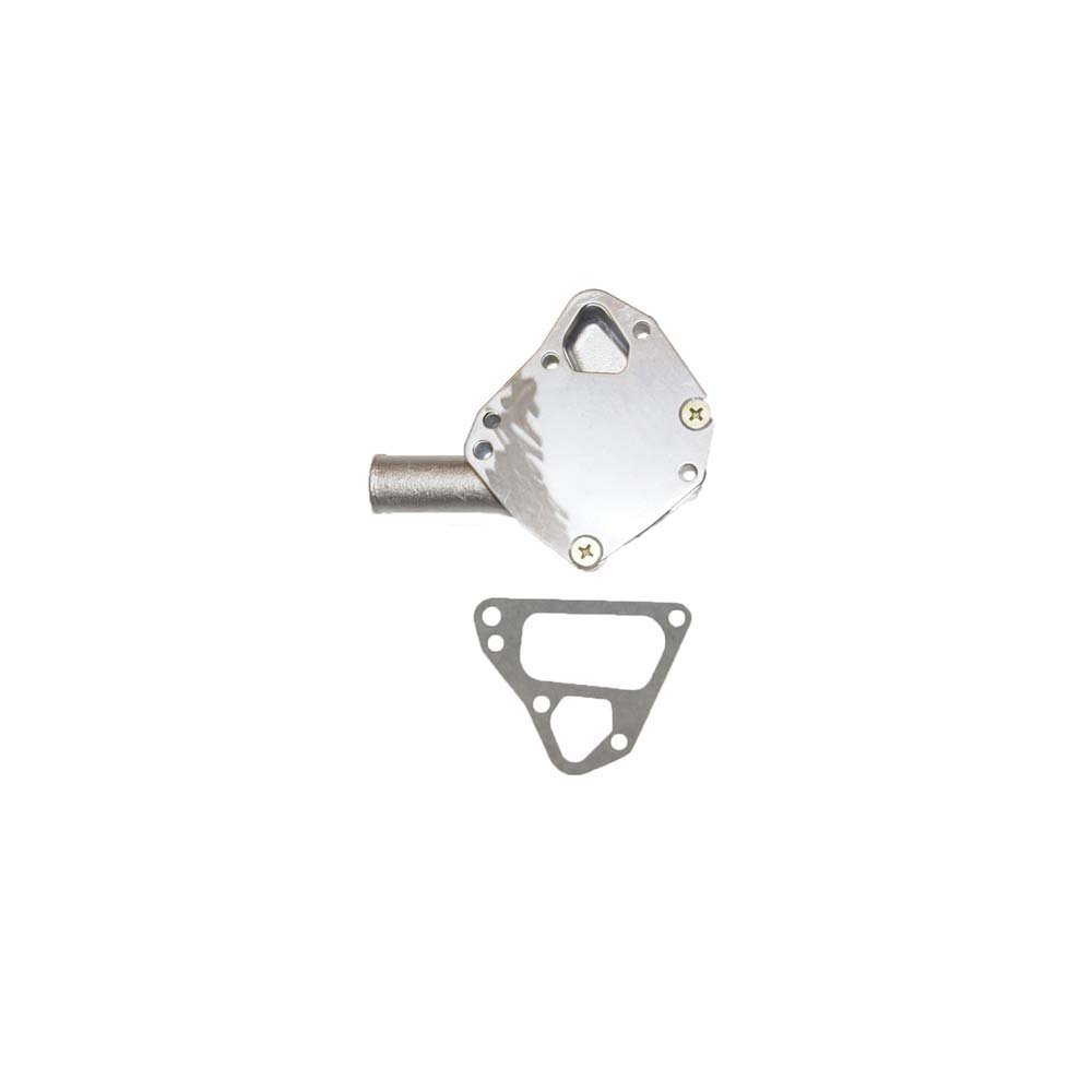

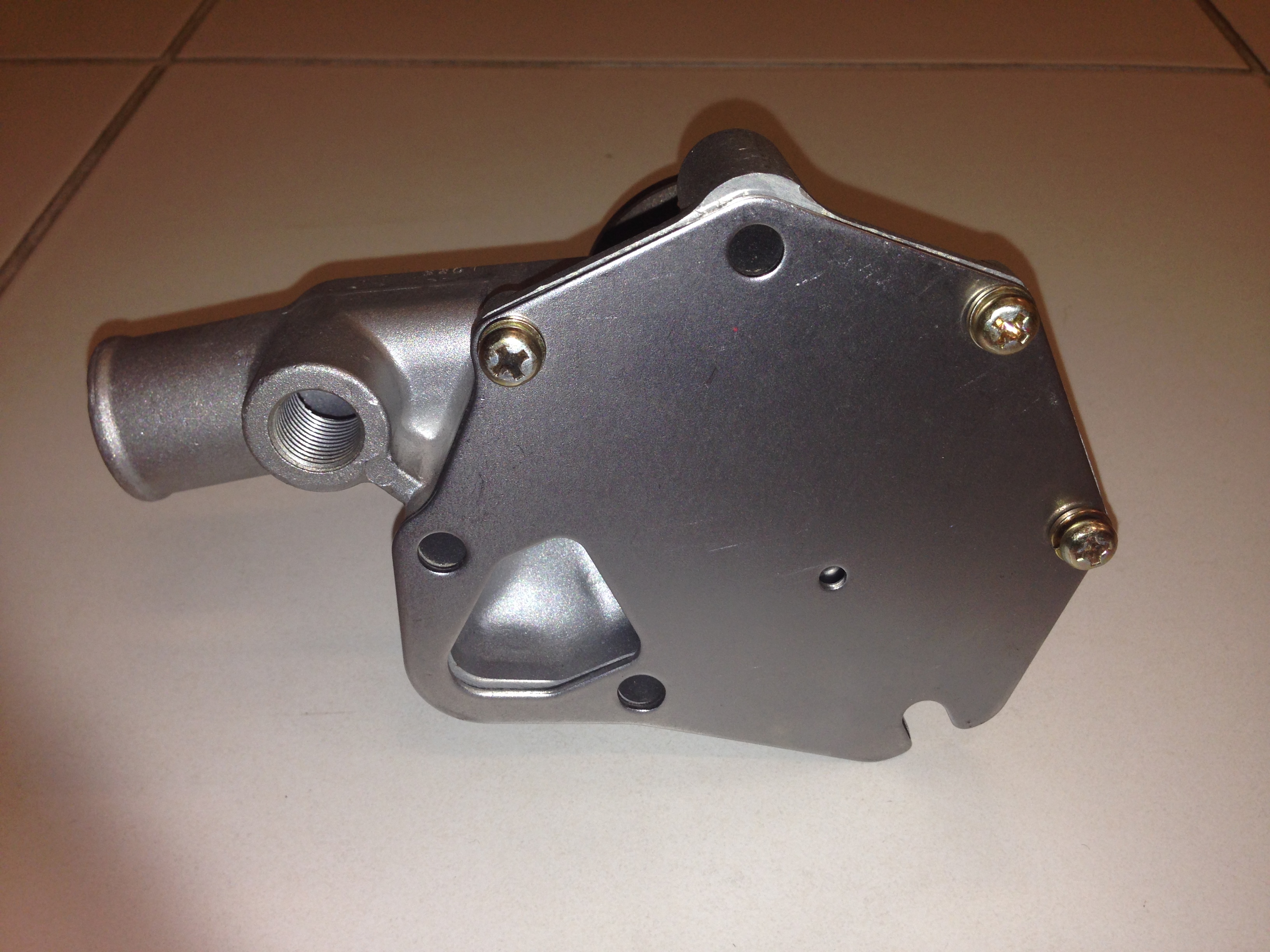

Fri Jan 23, 2015 2:00 am
Damn it!!
Pump received and NOT correct......START AGAIN....SHEESH
Mon Jan 26, 2015 10:04 pm
That pump looks like it may be for 1800 OHC, which would fit the Chev luv motor in the Stat
Mon Jan 26, 2015 10:19 pm
You got it in 1
1800 G180ss engine
SOHC
Tue Jan 27, 2015 3:51 am
Neil.
Commiserations mate. The pics you brought up originally were correct. Comming from a Parts Guy I can understand the
frustration you would have had when you got the incorrect pump. When I saw WP1001 in a Protex catalogue and not being
home to check. [I was in Melbourne for a wedding last weekend], I thought the number is right. Started to read this post tonight and saw what happened, and pulled out my pump listings and sure enough, it was wrong. Also checked my stock of pumps and this confirmed my suspicions. I have 2 WP1001's for my convertible.
WP1001 or PWP1001 is a pump to suit all SOHC engines. 1.6, 1.8, 2.0 litre. The GMB number is GWIS-14A or GWIS Y14A.
There is NO WP number for the OHV engines available. This is a list of numbers that I know are correct as I have got or used.
GWIS-13A, CP0319 or CP319 & 8943768640 (ISUZU).
Hope this will help everybody Nationally and our International friends.

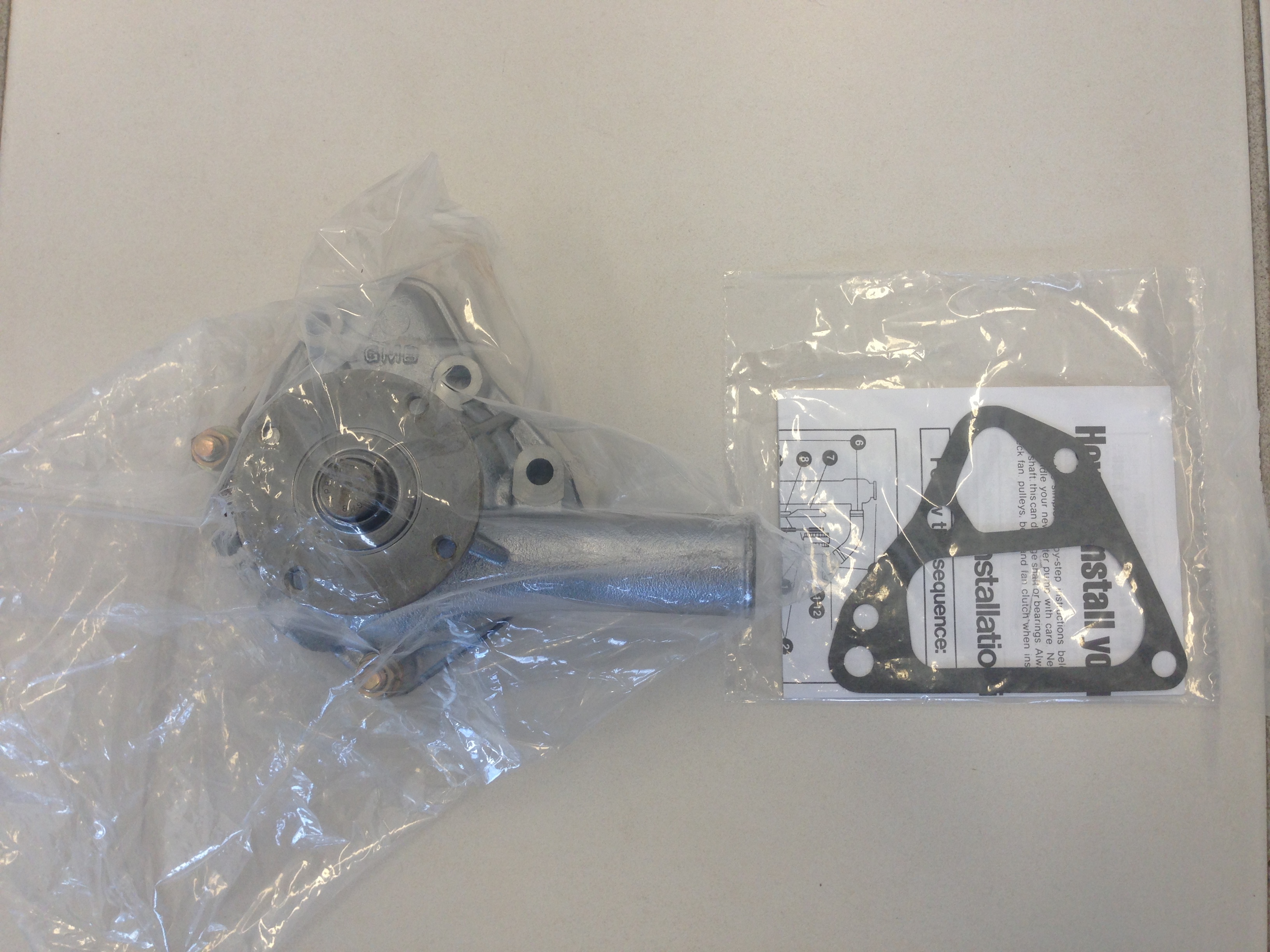

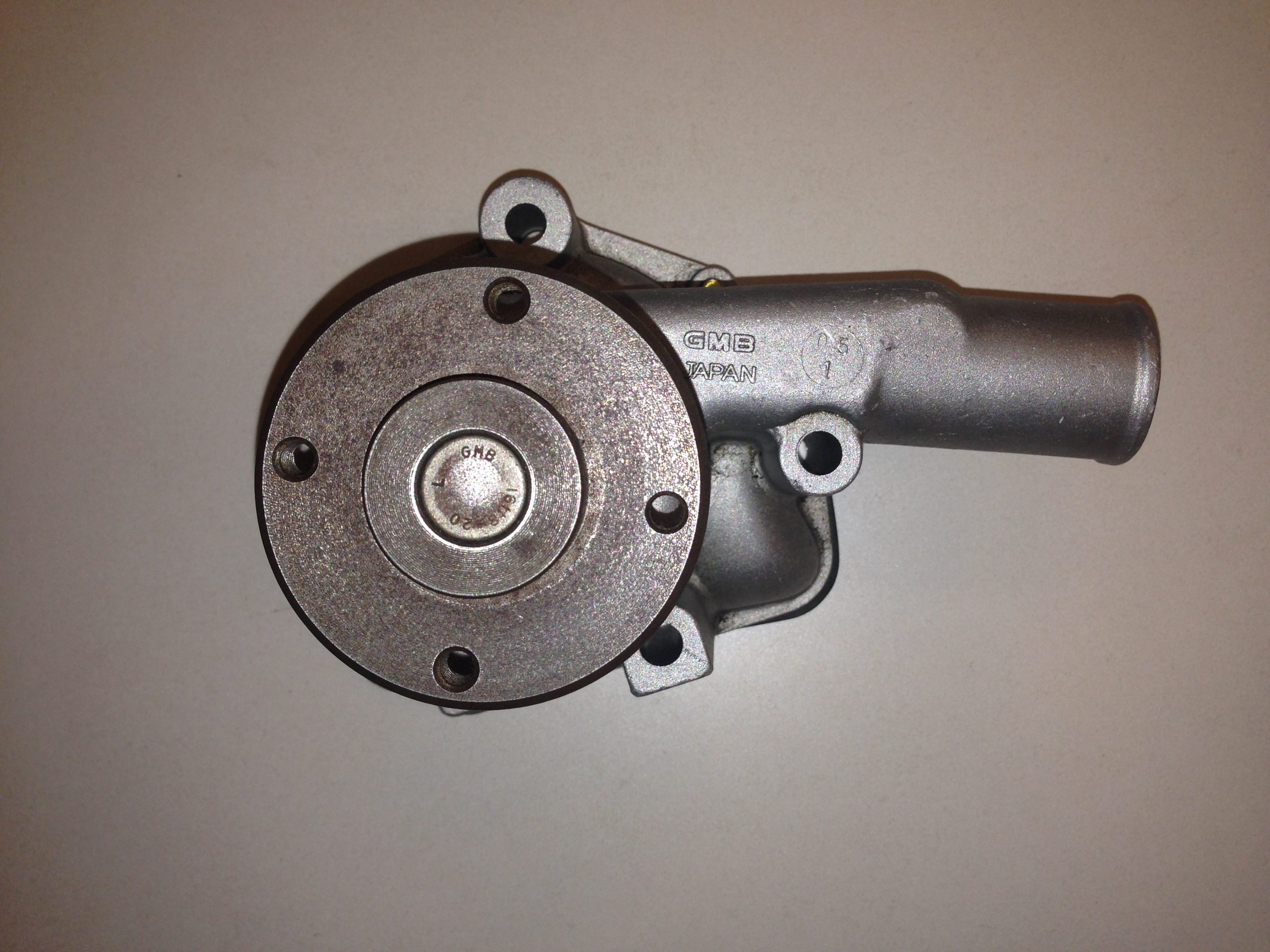

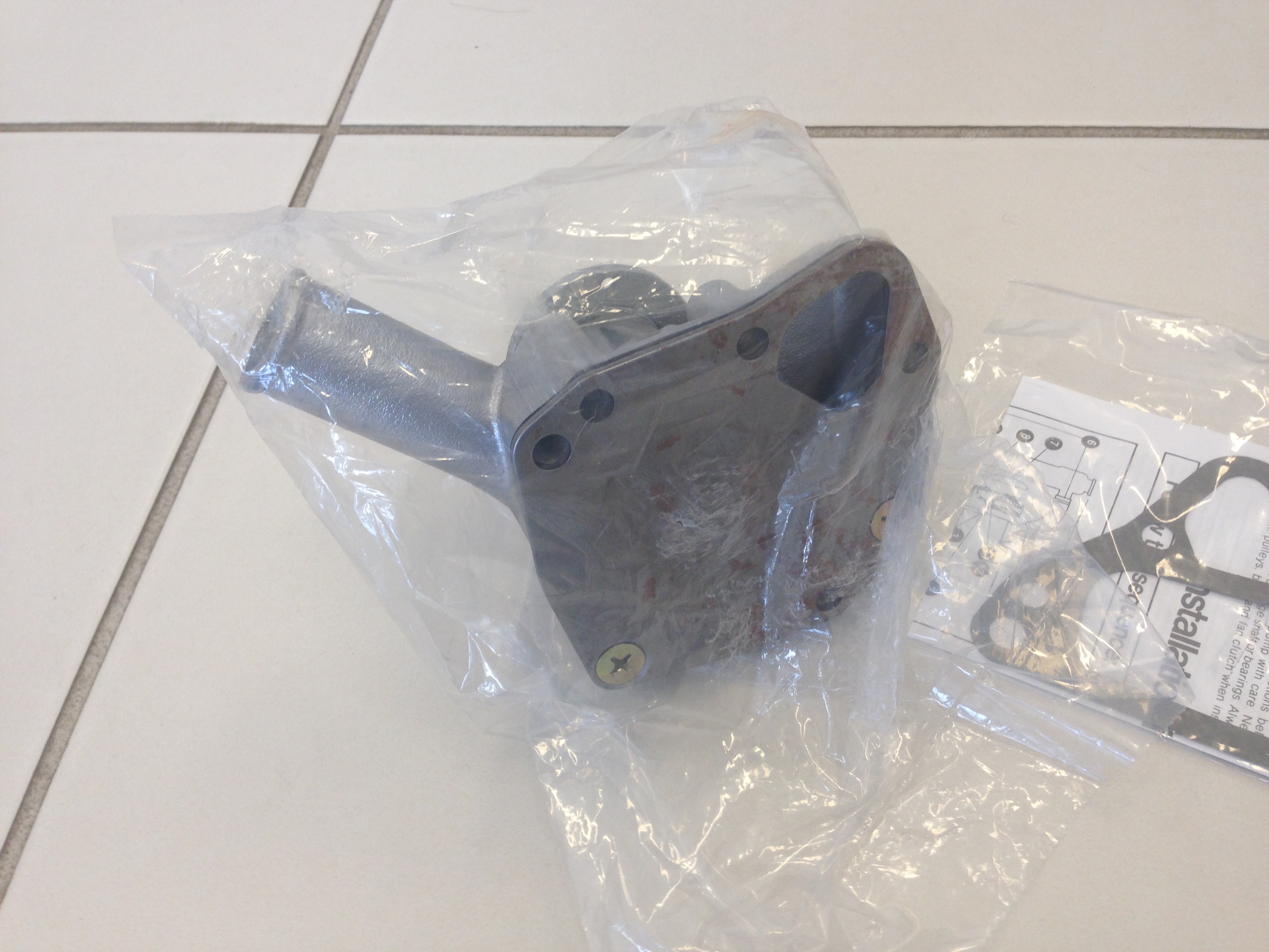

Fri Jan 30, 2015 12:43 pm
I GOT ONE!!!!!!!!
Okay I am pretty excited - but until I get the thing on Stinky I am not going to give everyone the low down on where and how much I spent on this thing.......I don't want to stuff you all around.
I am a bit busy at the moment preparing my Chopper for the Shannon's Motorcycle Extravaganza this weekend but I will try and tear myself away from polishing to whack this on sometime after work this week.
Check out the photos of it................(virgin inside plastic bags with gaskets!!!!!)
File comment: The Matrix Chopper
File comment: Water Pump and Seal
File comment: Seal and Water Pump
Mon Feb 09, 2015 12:57 am
Oh you rippa
Looks the goods
Go on...... Give..... Are there any more????
:lol:
Mon Feb 09, 2015 8:12 am
Well done Redback. :mrgreen: Can't wait for the info. ;) My sources have given me a big NO. CAN"T DO. :cry:
Rubbing hands in anticipation.
Mon Feb 09, 2015 1:12 pm
the package is in English not Japanese ..so was it a local supplier ???..come on mate leave that bike alone ..tell us ....
Mon Feb 09, 2015 1:51 pm
OKAY - sorry for the delay.
I was in the middle of installing the water pump and our old dog Zara (16 year old maltese) had a stroke and had to rush her to the vets about 7.00pm Monday evening.......she is a bit wobbly on her legs but seems not be in any pain and not getting any worse at the moment - we have to stay beside her all this week and maybe into next week to see how she is hopefully progressing.
Anyway back to the task at hand - pump is still half on Stinky but all seems to be well and good - I have NOT test run the motor yet but am very confident all will work as the factory designed.
WHOOOHOOOOOO!!!!
I purchased the water pump from summitracing.com the part number I used was GMB 140-1130 (a General Motors part number I think) for a Chev Luv.....
Here is the link:
http://www.summitracing.com/parts/gmb-140-1130
These are US$45.97 each and about US$60- $90 postage depending on how quick you want it - mine was ordered on the 27th January and received on 9th February by DHL Express (I was very happy with paying extra to get it here quickly)
This has been probably 3 years in the searching for me and I am glad to share with all of the Bellett.net family.
Now go get them!!!
