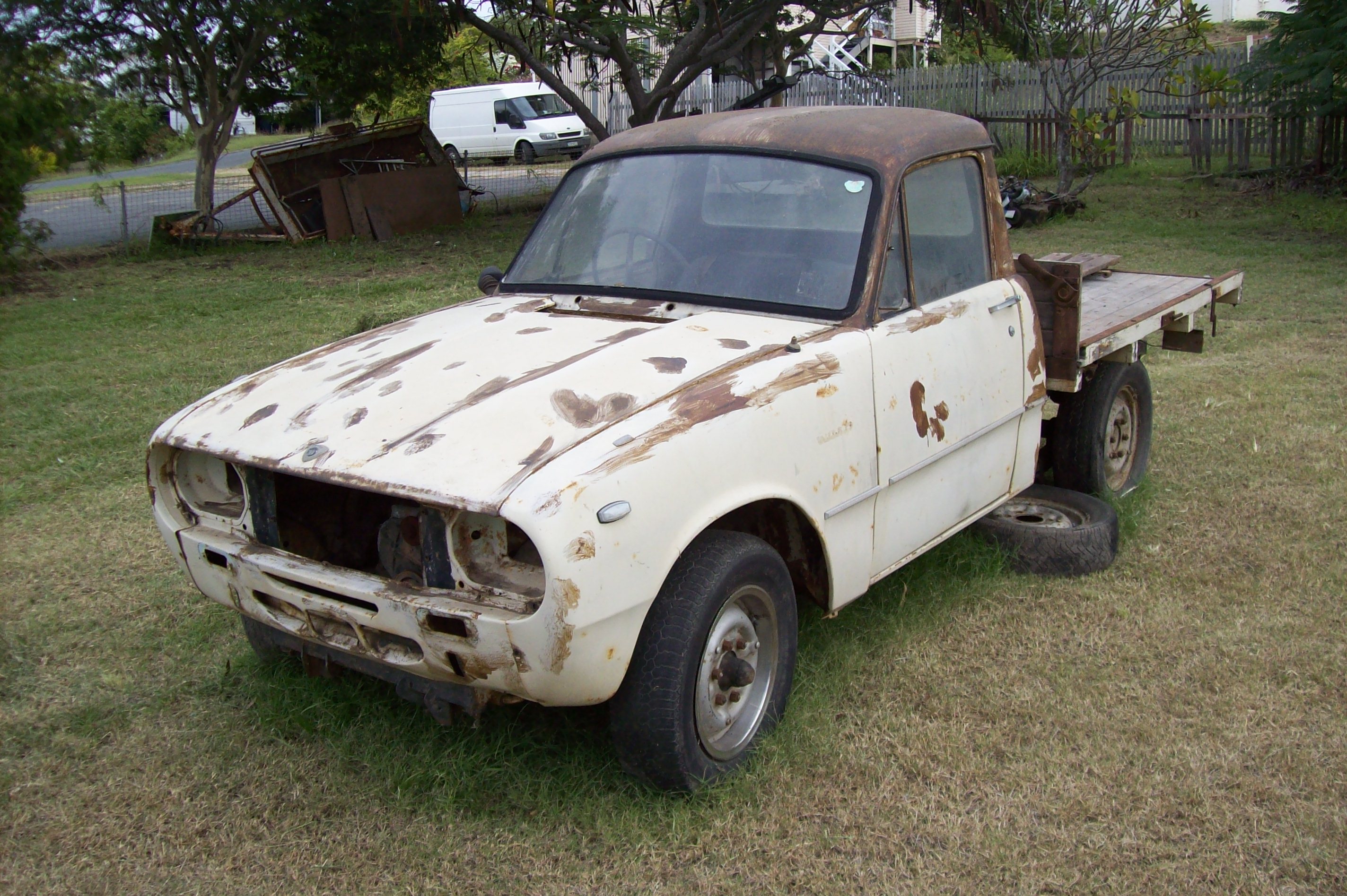

hey dave what about some shots of harry cheers davo
Tue Jun 12, 2012 1:46 pm
Not sure if this will work. First try.
If it does work. I might put in a thread on all my cars and utes.
File comment: 'Neville'. Good for spares only.
File comment: This is 'Harry'.

Thanks for the Wasp pics. You must be the Dave with the 2 Wasps.......
