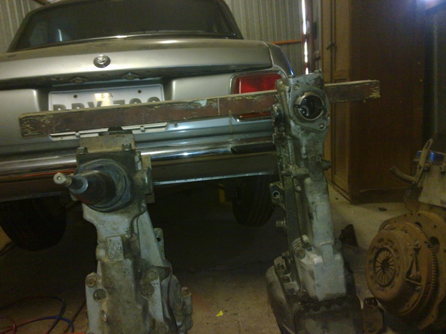

Hi
I am putting a G180w into my 67 GT and would also like to fit the 5 speed gearbox. The one I have came with the motor so I am assuming its the Close ratio ZZR box. It seems that the overall box dimensions are the same but the remote gear stick is too far forward to fit the original hole in the floor of the GT. Have any of the GT owners with Twin Cams fitted the 5 speed box? One option may be to cut and shut the llinkages to extend them. I am wondering if any remote from Rodeo or Piazza extends past the output shaft as in the originat GT 4 Speed. The Gearbox mounts are wider thats been covered in other threads. I have attached a photo showing both original gox on the right and ZZR Box on left

mate, it should go straight into the original hole in the tunnel.
we've done heaps of gemini and 5 speed or twin cam and 5 speed conversions over the years and it all lines up perfect including the tailshaft length, bellhousing in the tunnel entrance, the lot.
double check it all coz it seriously sounds like something is a-miss.

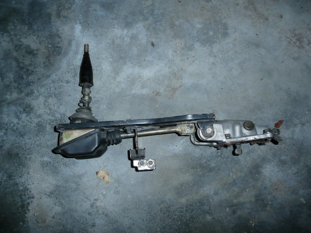

A picture is worth a thousand words After everyones comments I went back to the shed

thats the "short" remote shifter u have there.
mine is the same length as the GT one, in that it extends to the very rear of the box. "isabellgrandtourer"s will be the same too.
u'll need the longer one, which correct me if i'm wrong, is the more common one anyway, so it might not be too hard to locate.
geoff, u would have had to fit the shifter before the box went in as u can't get to the bolts for it once it's in place.
that's why my race car has a removable top/lid on the tunnel....

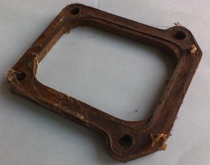

Glenn we had to move the crossmember back on isabell we used the rear holes in the front to rear in the floor pan. the spacer plate you probably recall is where the shifter goes into the selctors some are too long by around 6/8 mm so the spacer lifts it away.
Sat Aug 04, 2012 3:35 am
Yes that's a way to do it but I elected to have x member in stock holes
Ok on spacer too. Thats the reason for sure as spacer is about that thickness.
I found the one i have below. The steel casting is 7mm thick. PLus gaskets makes it about 8mm I'm not sure if this is needed or not for the 117 type remote shifter but at least you know what it looks like !
