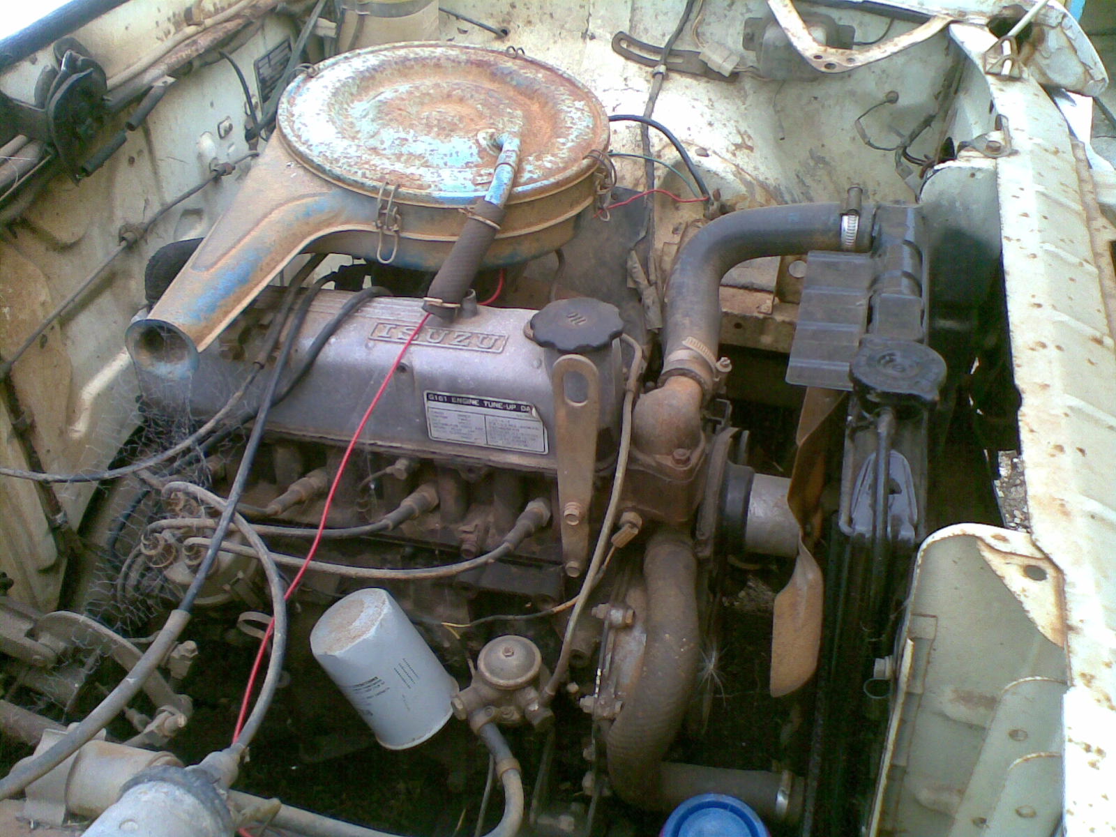

Well I have posted a picture of my engine below. Does this look the same as yours Pa_man?

I took a photo of a friends 72 as my engine does look the same. Looks like they all look VERY similar except under the skin!!

Posts: 57
Looks identical doesn't it!

This is Oz's Luv, mine doesn't have as many cobwebs :D
But always welcome a visit from donkey and you.
