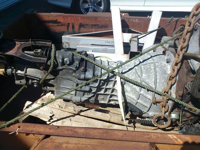

If a genuine DOHC 5 speed (pictured) is used, the lever comes out a long way back and much higher. A new trans hump like a GT, will need to be fabricated in that case and welded in. Also, the handbrake lever has to be moved back on the tunnel to clear the shifter. [you could elect to just use the Bellett 4 speed though.] The 5 speed g'box uses a cable operated clutch. You can use this system if you get a cable sytem from a Gemini and alter the clutch pedal to take the end. A largish hole needs to be drilled in firewall to take the cable. Or you could change clutch to hydraulic operation. In one conversion i did this using (i think) a Toyota system.

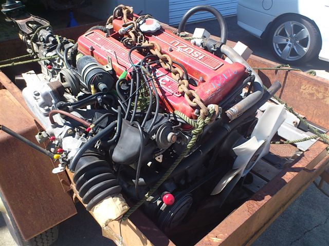

File comment: 2litre DOHC engine with early EFI

The engine pictured is the same so I will need to look at the oil pump/filter to check orientation. The engine comes with a clutch but no gearbox.

I don't know how you could tell if you have a so called close ratio box by looking at it. You would have to do a turn the input shaft and count output rotations in each gear and compare with other boxes..... I think there is a link to a document somewhere on here (can't find it now) that shows all gear box ratios though.
The gear box I have, pictured above is from a 117. If they are so-called 'close ratio' i have no idea.
