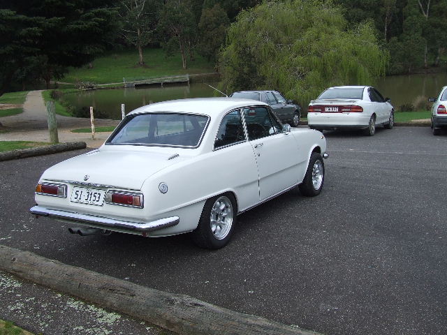

Appearance from the rear twins to the rear, I will attach a photo of the rear of my car which has been replicated to as near as possible to the original set up in stainless steel.
I hope this assists you the exhaust is single from the extractors, to the front of the muffler in front of the rear axle where the muffler is located, from there the two pipes come out at the rear, I hope this is what you are after?

Good picture.
I will have to measure the height of the tailgate name garnish, but it looks like 1 7/8 - 2 1/4 inch tips, with the space between about 75% of the diameter of the tips. That's really close together.
The tips also look like pencil tip with the ends rolled in to exaggerate the circle.

THE MEASUREMENTS OF THE PIPES ON MY CAR ARE; OUTER DIAMETER OF THE TIPS IS 47MM, THE SPACE BETWEEN THE PIPES IS 26 MM.
I hope this helps you??

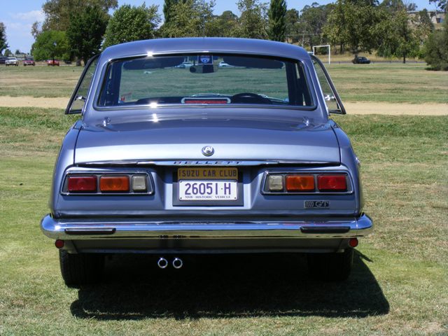

i do believe these are the proper pipes as going on by original panflet 68 gt are 50 mmm slite angle from muffler ?

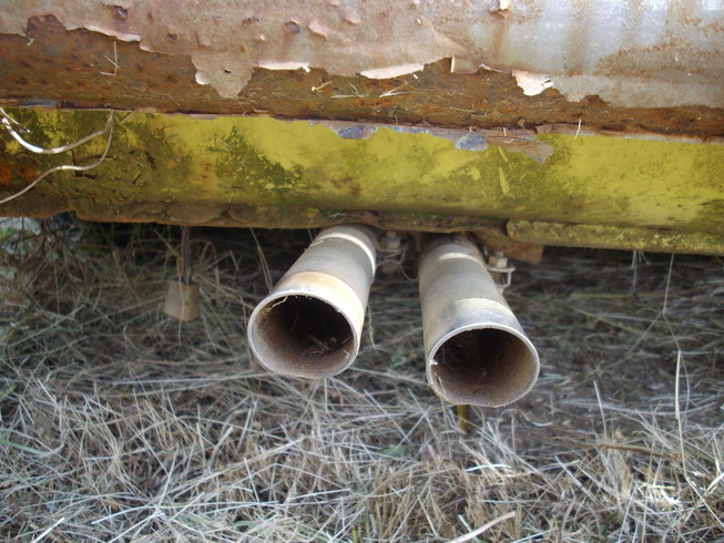

Hi JT, sorry I'm so slow to get to this, hope it's some help.
My parts donor is fitted with an original equipment system (aibeit rusty). When I get to taking it off to copy, I could take more pics.

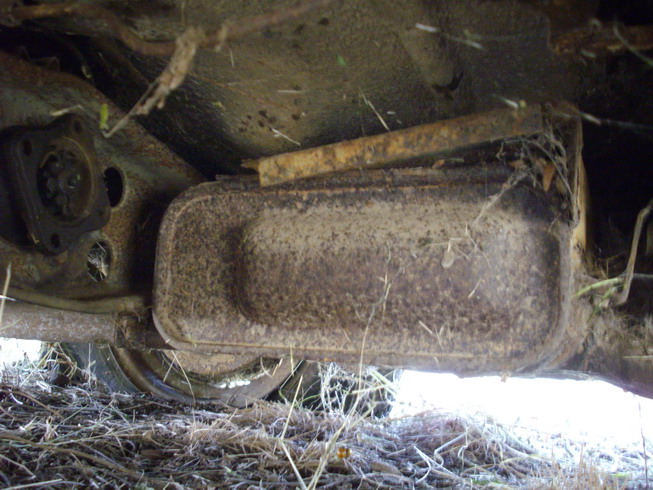

Original muffler with heat shield.

Outlets - 32mm / 1 1/2 inch Dia. (inside)

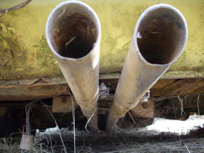

Twin pipes from side outlet of muffler (single pipe from headers to side inlet if muffler)

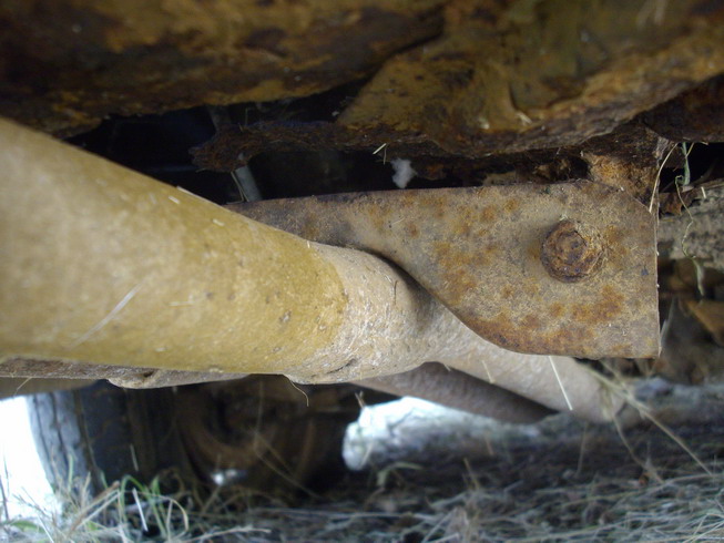

Detail of rear support - shaped bracket, rubber block mounted.

Is it possible that there are two different versions of the GT exhaust? The pictures I have seen show a muffler behind the rear bumper and a resonator under the rear seat. Your picture titled muffler looks like the resonator under the rear seat.
But the tail pipe arrangement picture provides some good details that I can use to double check. The pipes are actually 25% closer together than the pipe width. I will have to reproduce that angle cut with stainless pipe.
