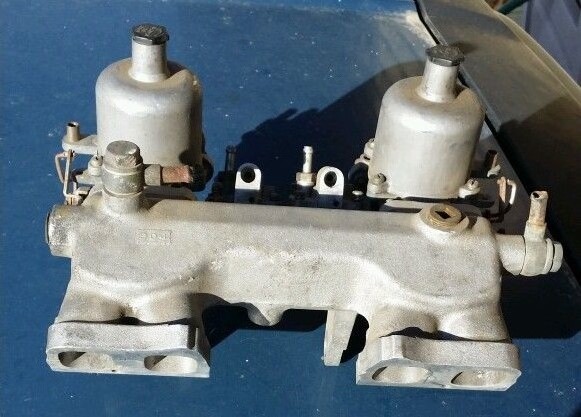

http://www.ebay.co.uk/itm/171574726675
I thought it would be unlikely Chev/Isuzu would fit twin carbs to their pick up, but am I wrong?

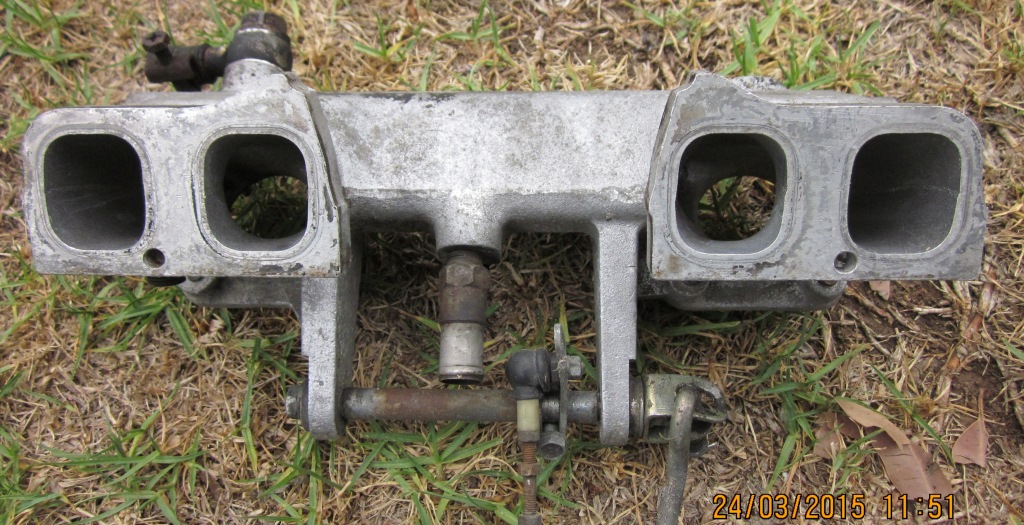

I hooked this pic from an earlier thread....and this is a manifold for an 1800 SOHC engine.
And you can see differences on the manifold to head surfaces compared to the E Bay pair.
Any ideas?

Hi
Yes indeed this is a manifold from 1800SOHC motor fitted to Bellett 1800 GT 1971-72 and early Chevy Luv's in USA
The carbies you require I think are
Hitachi HJE38W - 38mm fitted to ealy Datsun 240Z motors as they are 4 bolt not 2 bolt

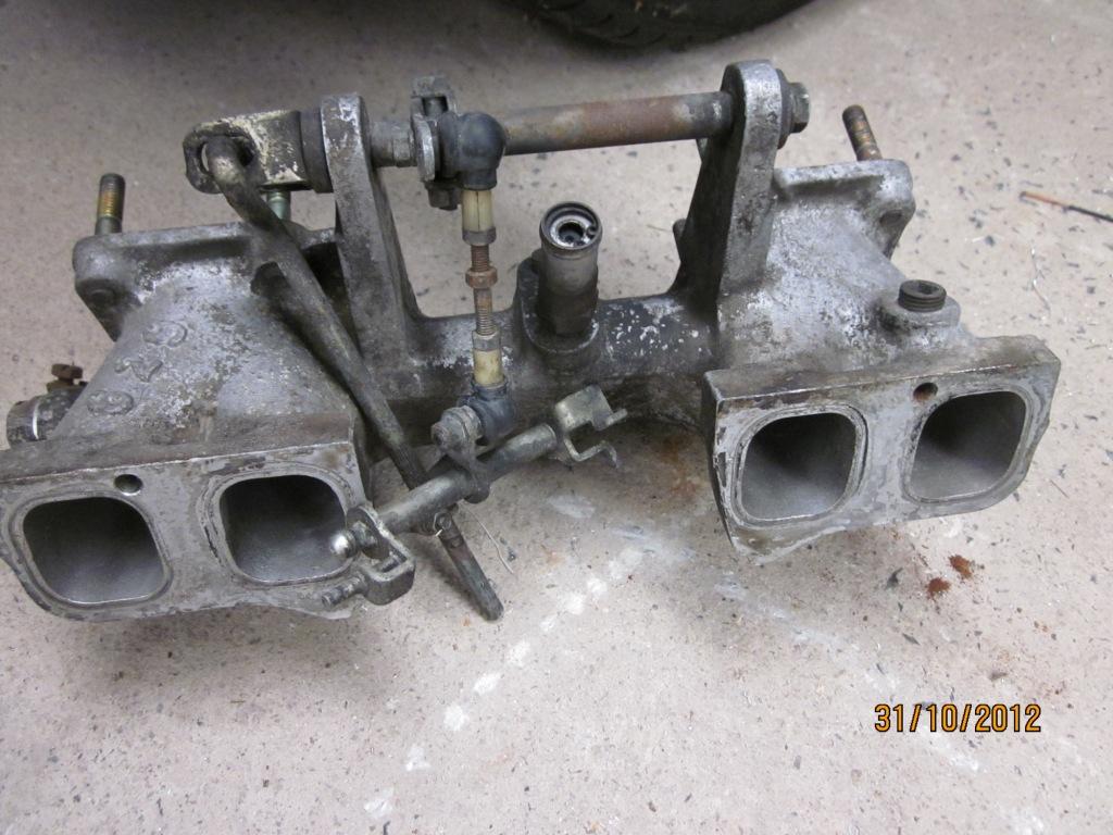

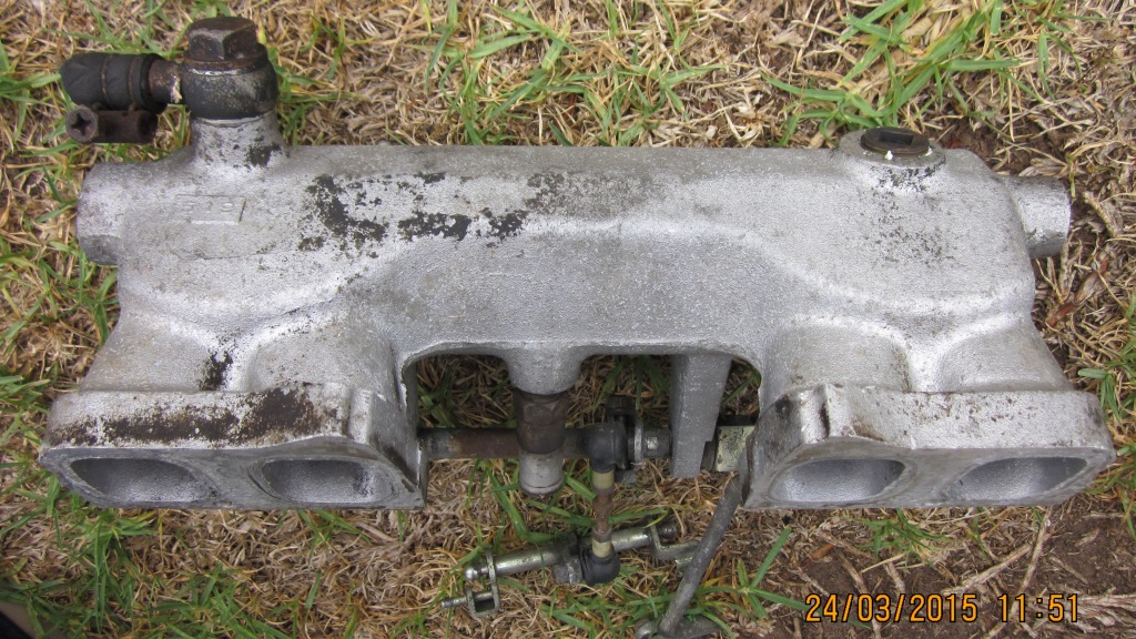

This might help comparisons, (looks pretty much same to me )
....I pulled out the 1800 SOHC manifold to take picture of other side.

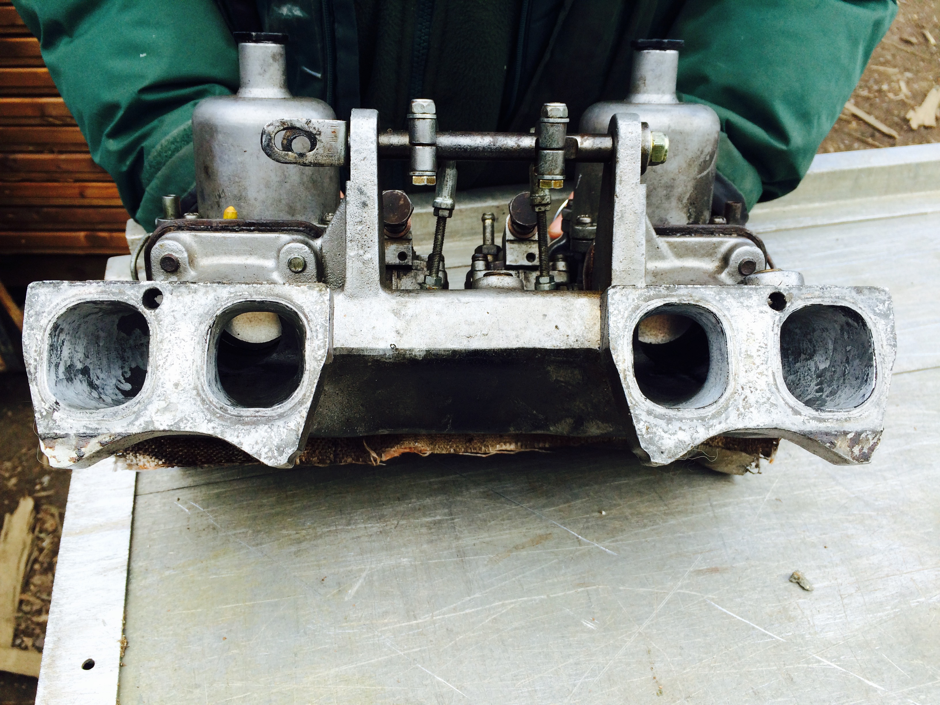

Thanks J and thanks Glen.....that's a big help.....although, now looking at all these pictures and looking more closely at my own carbs from my 1600 SOHC, the manifolds look pretty much the same. This is mine.
The only difference I can see is the lower outside corners have the pointy flanges on mine, but not on the others.
So my question is.....if I were to get hold of an 1800 SOHC engine, will my 1600 manifold and carbs fit it? It's beginning to look feasible is it not?
Incidentally the E Bay carbs/manifold look a bit suspect to me, but I think that's because it looks like they are upside down on the manifold. Here's the pic.....

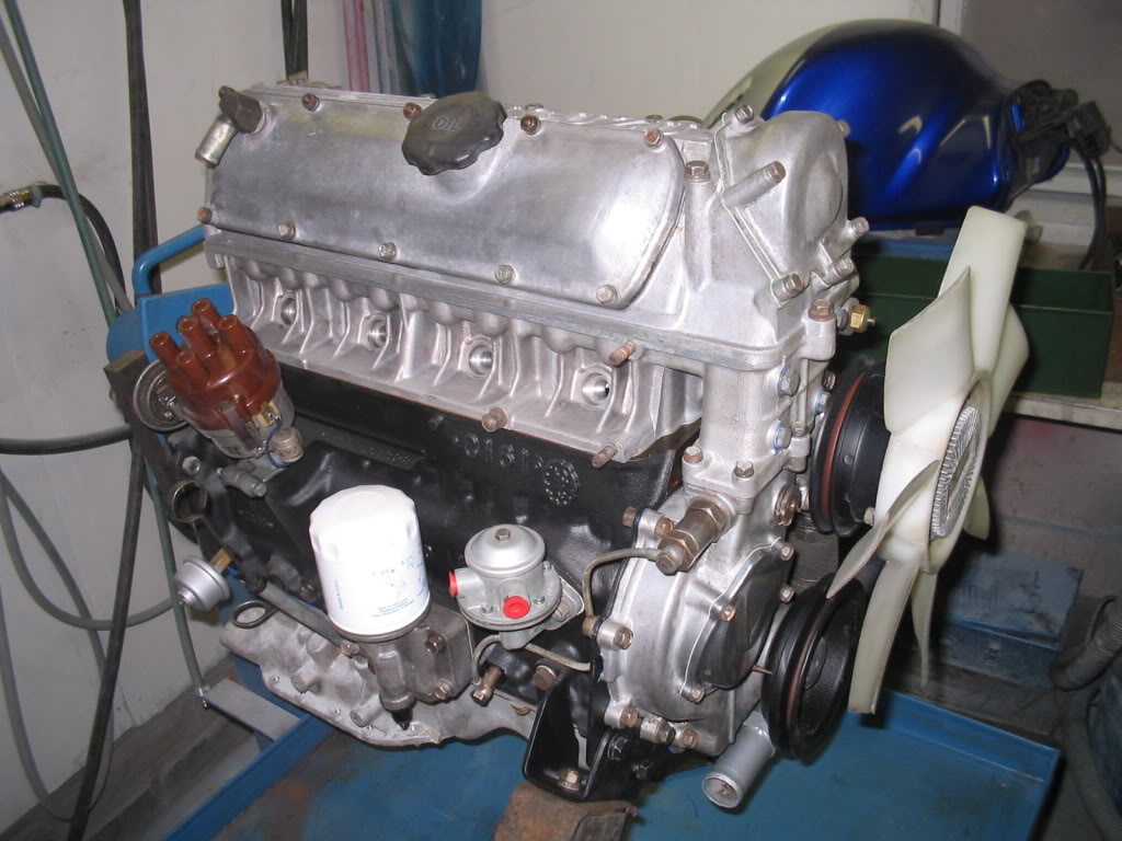

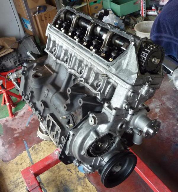

Below is a picture of the G160OHC engine we never got.
The 1600OHC engine looks like it has a different bottom end to the 1800OHC but similar Head (Not totally sure though as have never actually seen a G160ss with my own eyes just the G180ss which has a taller block). If true then the 1600OHC has 75mm rods and 82mm pistons (1584cc) while the 1800OHC should has 82mm rods and 84mm pistons (1817cc). If you can find a 1800OHC engine, forged Conrods and pistons are readily available so why not go all the way, regrind cam while you are about it and hey presto - very nice G180ss.
Anyway, having said all that it is highly likely then that your manifold should fit the G180OHC and yes the carbies in the picture are on upsidedown - marvellous
Hope this help

G1800 OHC engine
Block looks different
Note the orientation of the oil filter + two bolt points at front of block on the 1800OHC.
Head looks a little different also. Note the oil gallery between cylinders 2 & 3! It is a protruberance on the 1800OHC engine vs the 1600OHC.

I agree, i would think the manifolds are interchangeable from 1600 to 1800 SOHC.

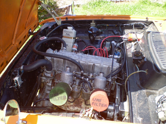

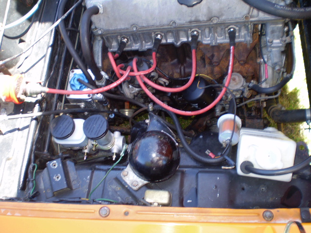

what dual master cylinder are you using there, J.
I see you have an oil leak also in same place as my 1800SOHC..... pretty common I think. And annoying !

Hi Glenn
This was how Asroc arrived from Perth WA with the G180s motor
The leak was due to a pinched 'O-ring'
This engine is now 'refreshed' and bolted to an engine frame under my house waiting for a new home - perhaps a GT one day.
Asroc now has the Turbo G161 hybrid
The dual master cylinder is from a Datsun 120Y

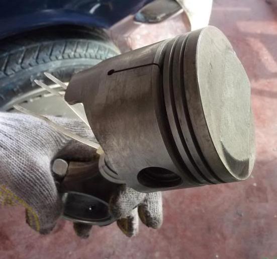

thanks, yes that's the only issue, In have set of LUV pistons. But better to have something rather than nothing i guess.
here's a pic of the original pistons and a better pic of the block also....(borrowed from web)

Standard compression for G180OHC is 9.7:1 which is quite high
If you overbore this will rise so a set of flat tops would be appropriate and are available

I built my GT engine with 9.6:1
I have +30 i think flat top LUV pistons here.
Wed Mar 25, 2015 5:49 am
Rudimentary calculations
Using 0.75mm oversized flat top pistons will give u approx 9.5:1 compression
Which is the butter zone
