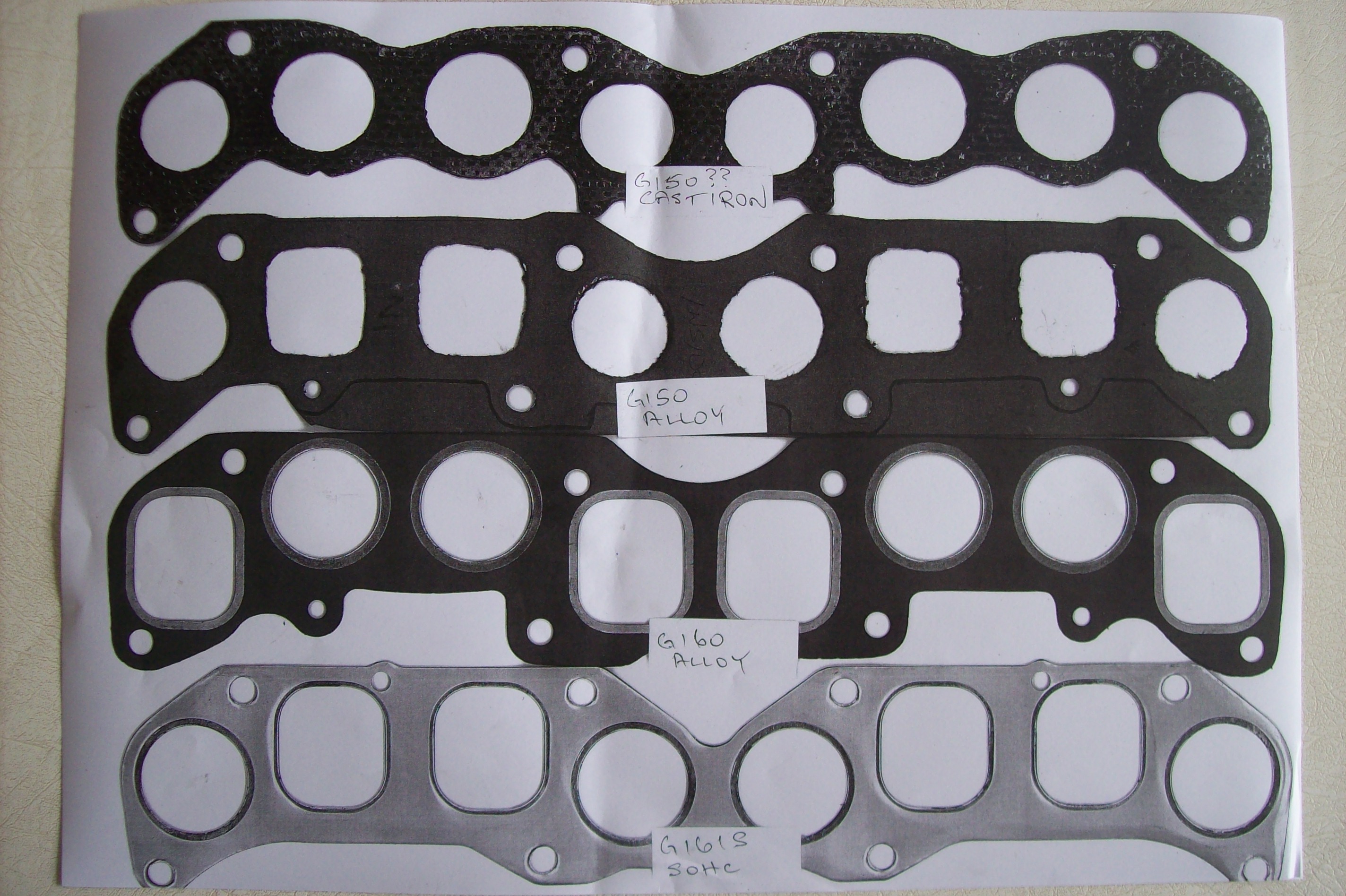

mrflibbels.
Just to give an idea of what I've come across in my possesion over the last 20 years or so.
File comment: Some manifold gaskets.

thanks for putting those up CQGT, pretty sure mine is the second one down from memory, been too cold here to go out and pull the manifold off!

Interesting, it appears that all engines use the same bolt pattern and spacing?
G161 OHV is different.
Very different.

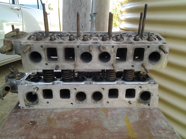

Here are 2 G161 heads. Top is GT, bottom is Florian.
Note on the Flo head is an impression of the Chev Luv G161 gasket that comes with the kit that is still available. It has the square and round holes reversed. (One wonders why??) I tried one once and the gasket leaked through the square corners of the exhaust holes, so no good.
So many variations!

Exactly Matt.
Very different animal.

definitely got a florian head like the one matt showed, braved the cold today and dug through the shed of no return and found my spare florian head. Been way to cold to go outside and pull off the belletts manifolds!
