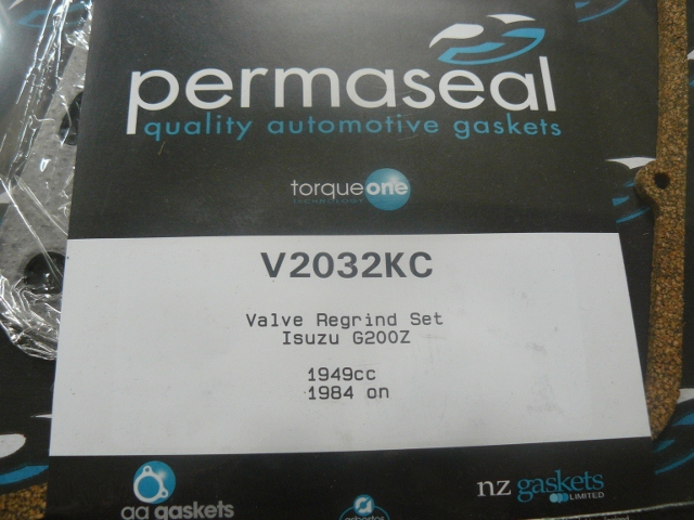

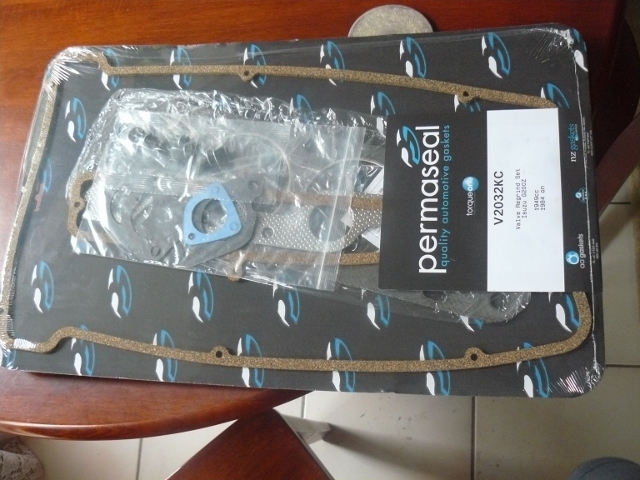

just in case you think i am F.O.S.
I spoke to Adam at morayfield store and he said they are still available if you have drama's he is expecting your call 07 54993533 he said they get them out of vic [that big victorian wharehouse]. :lol:

and there's more, quick phn call here to local Bursons.
V2032KC VRS set for G200Z as above.
They are available at Cost of $204.25 + $12 freight charge.

trust me....
that bursons kit is for a W series DOHC, not a Z series SOHC.
the listing on their system is wrong, and that's why when u go in and ask for an "Isuzu G200W DOHC" anything, it doesn't show up....
