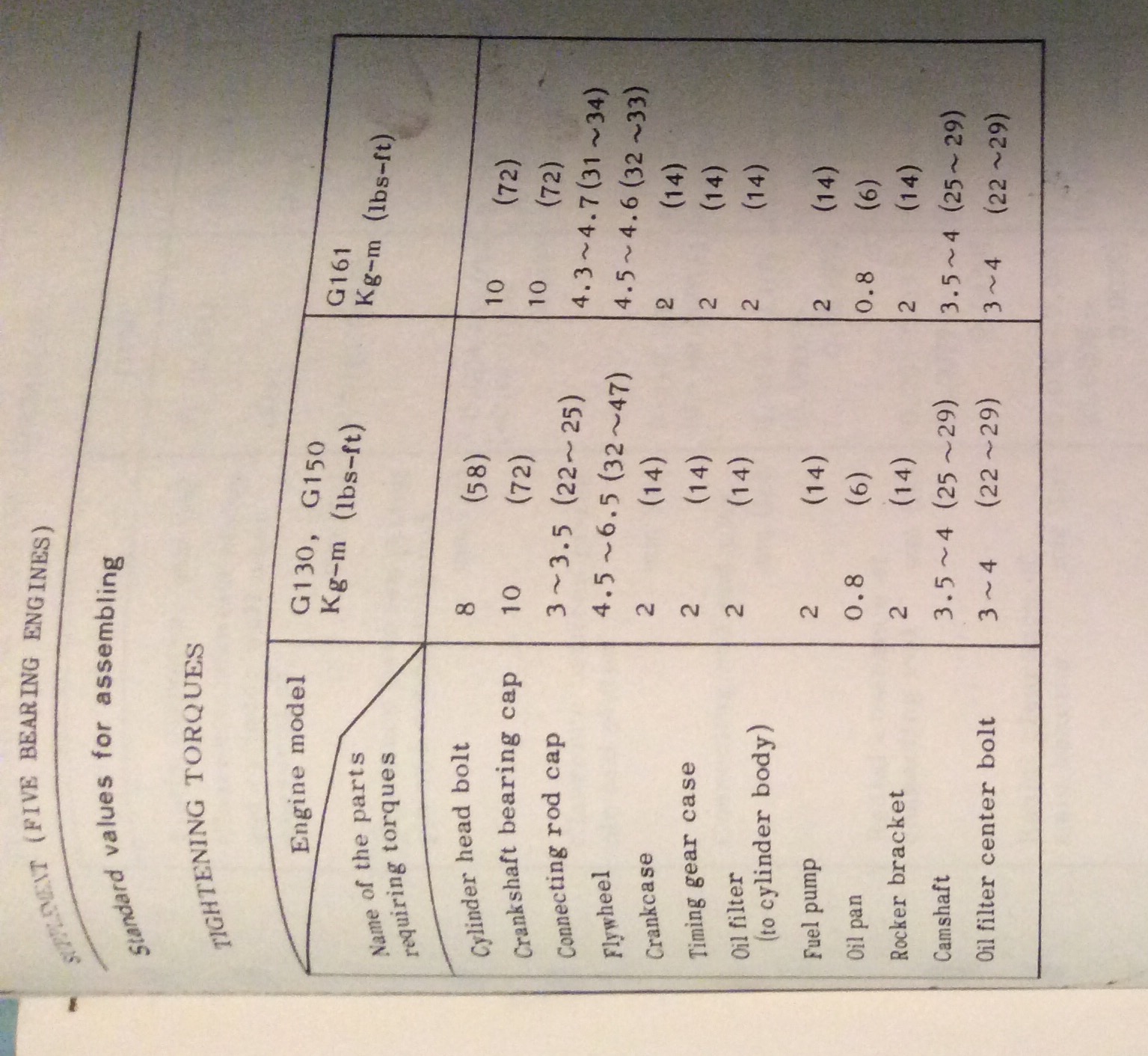

Here is the table of tightening torques for 5 bearing engines,
Lewis.

Yippee.
Thank you so much
:D
Sun Jan 08, 2017 8:53 pm
Lewis beet me to it.
That is the same book I have.
