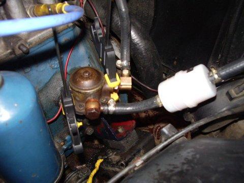

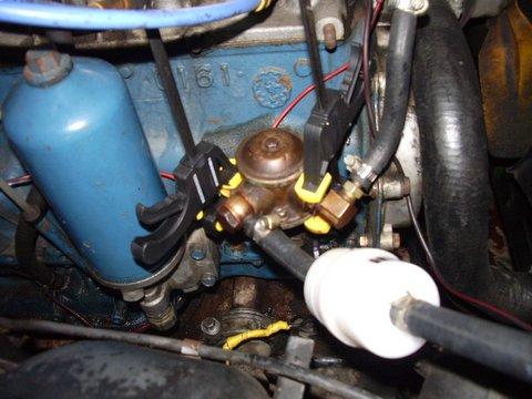

Everyone checking out the grotty bowls of my engine bay ?? :lol: Note my tempory fix RAA style which kept her goin'. Two small adjusable clamps to compress the top and bottom halves of the fuel pump. At least 3 of the 5 screws holding them together had stripped. The inlet housing thread was partially stripped but had enough grip to pinch up tight with some brass washers, but still leaked a few drops after turning engine off.
Thanks Farmer, to the rescue, there is a fuel pump sitting on the kitchen table ready to install. :D

Whatever works I suppose! Hope the replacement is O. K.- It will at least be lighter!
Fri Feb 19, 2010 1:13 pm
Only just seen your reply. I rekon I've pm'd you to say thanks. But again officially,THANKS mate.
All good now and goes like a dream. Was a bit of mix and match with the one you sent and my original.
