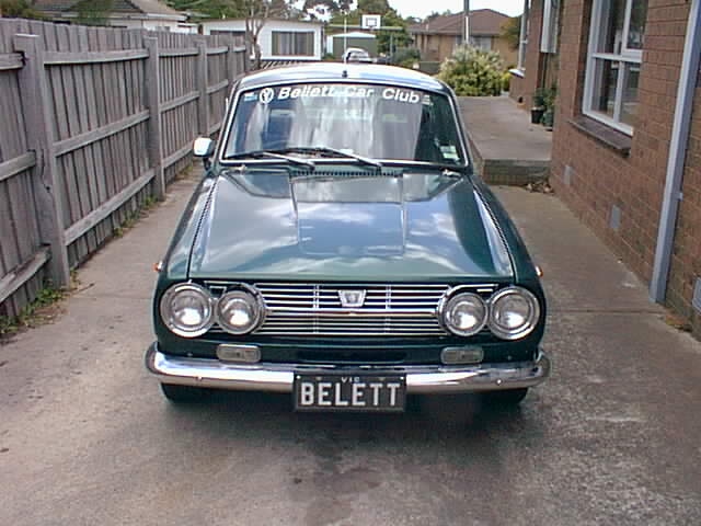

Your right on nearly all the counts. Stainless grille I wish. Maybe on PR90 but PR20 had a dreadfully thin chrome one. Maybe that is why I am putting a late alloy and mesh one back in.

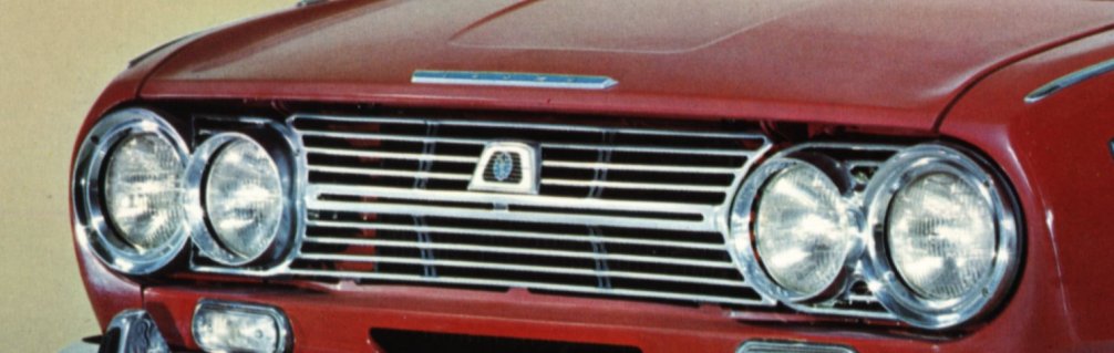

Don't do it Peter! The early chrome grilles are pretty tuff and those headlight surrounds are not going to die any time soon; as you know they weigh a tonne!
No disrespect to the alloy-grille/hex tail light brigade (I have one of these myself) or the mesh-grille/flat light brigade but the early sedan stuff looks pretty cool on the old teardrop light model and is much, much shinier!!!
All the more against your dark green car. I've got (and probably you've got as well) an early sedan brochure with the black Bellett sedan with the chrome grille? IT IS AWESOME. Why did I paint my car white??! Oh yeah, coz it was already white...
Ah it's up to you of course... but I just want MORE CHROME!!!!!
