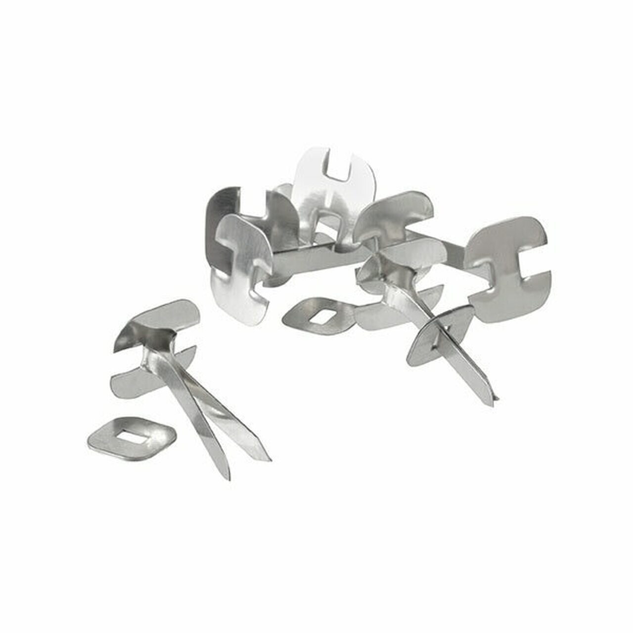

Hi
Try Paper Binders from a stationary store
Mon May 10, 2021 3:13 am
Flying.
Yes. I reckon would do the trick. Bend the tops to fit the slot. The washers would assist with the pressure
to hold onto the backing panel.

Thanks Guys for all your help with this. Paper binders are the way to go and I have found the perfect fit with a little trimming.
Thanks again
Regards
Peter
