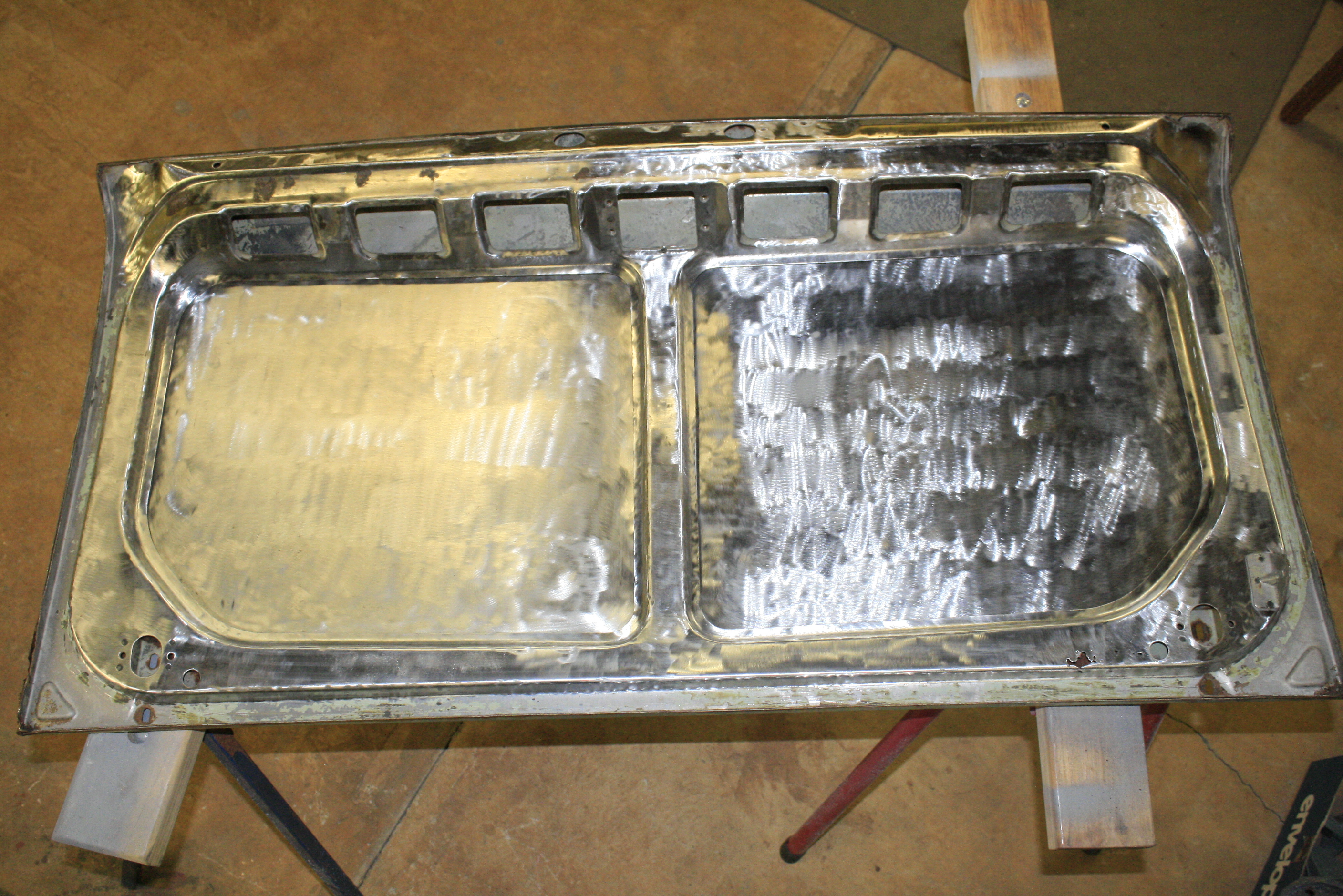

Posts: 368

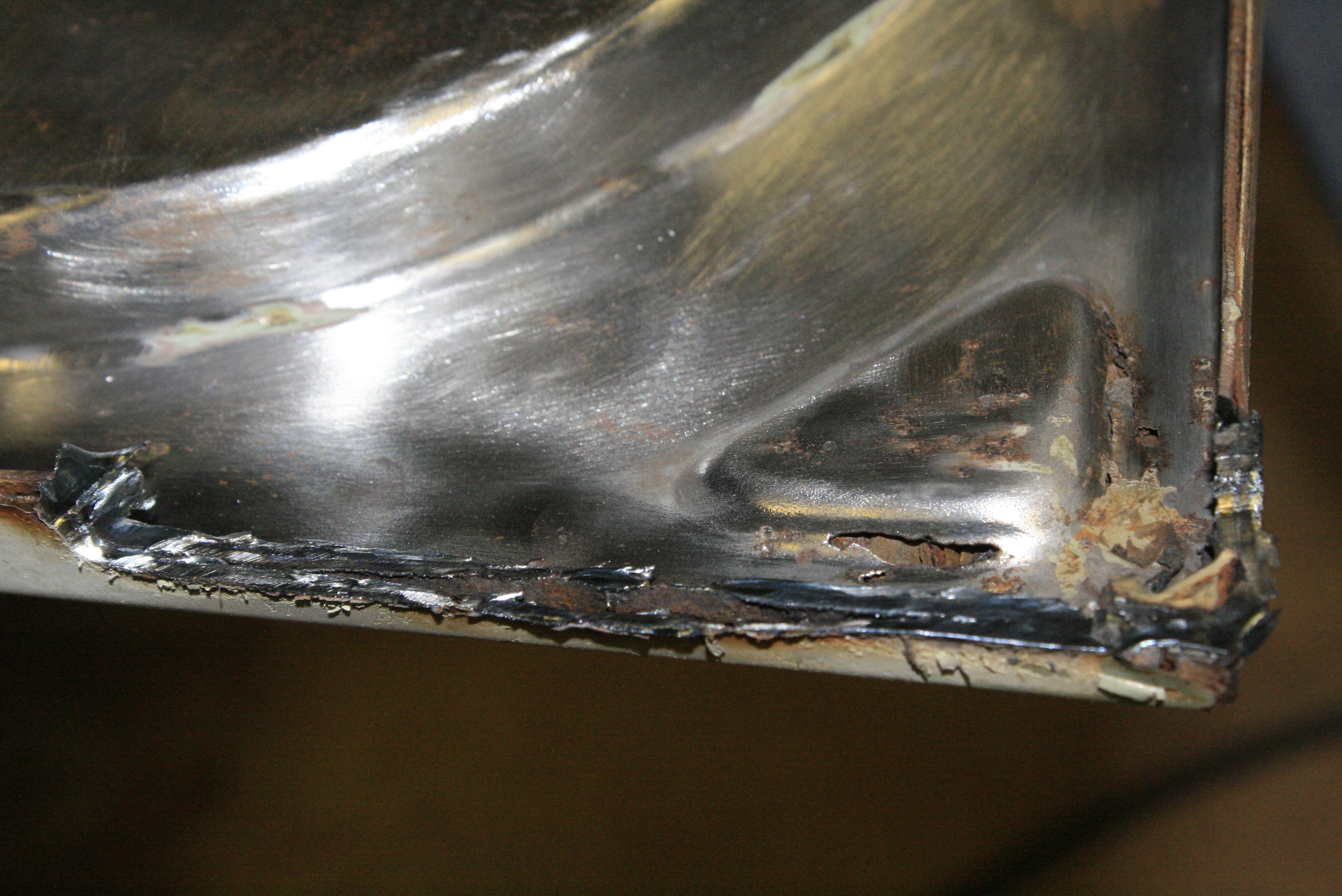

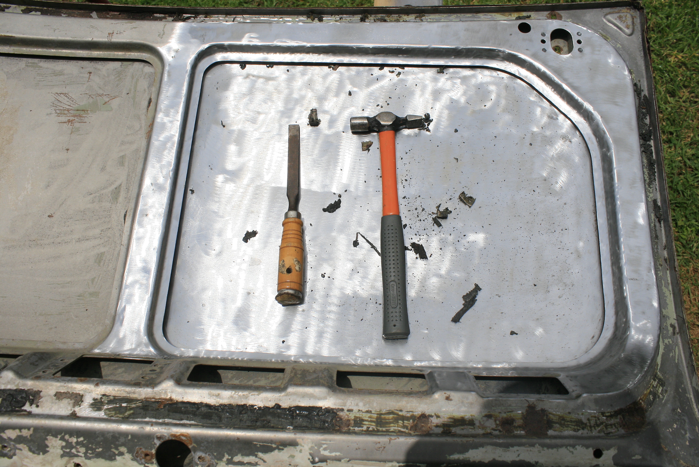

...Using A Light Hammer & Chisel To Get The Boot Rubber Out...
Ted Freeman
Tue Jan 26, 2016 3:07 am

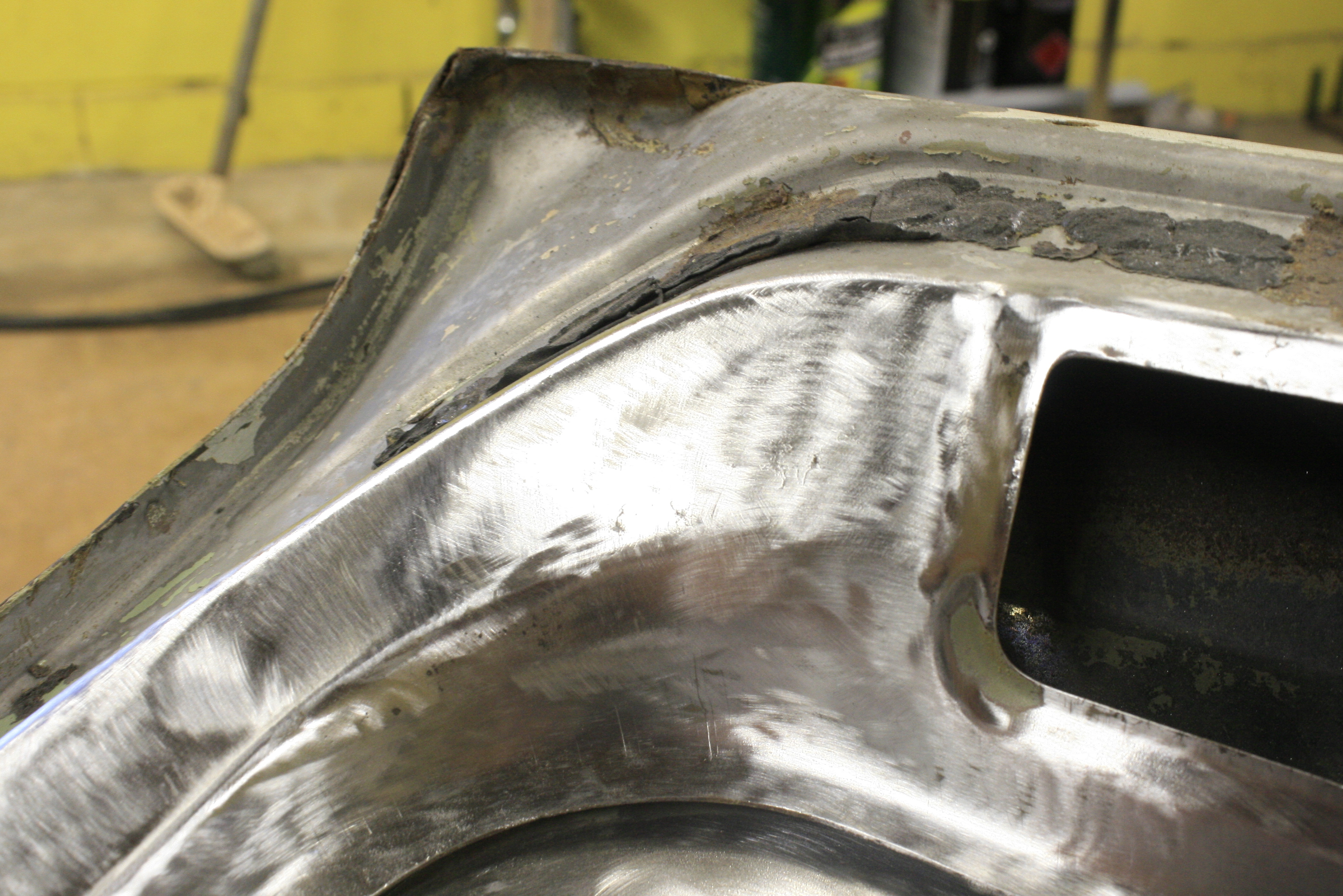

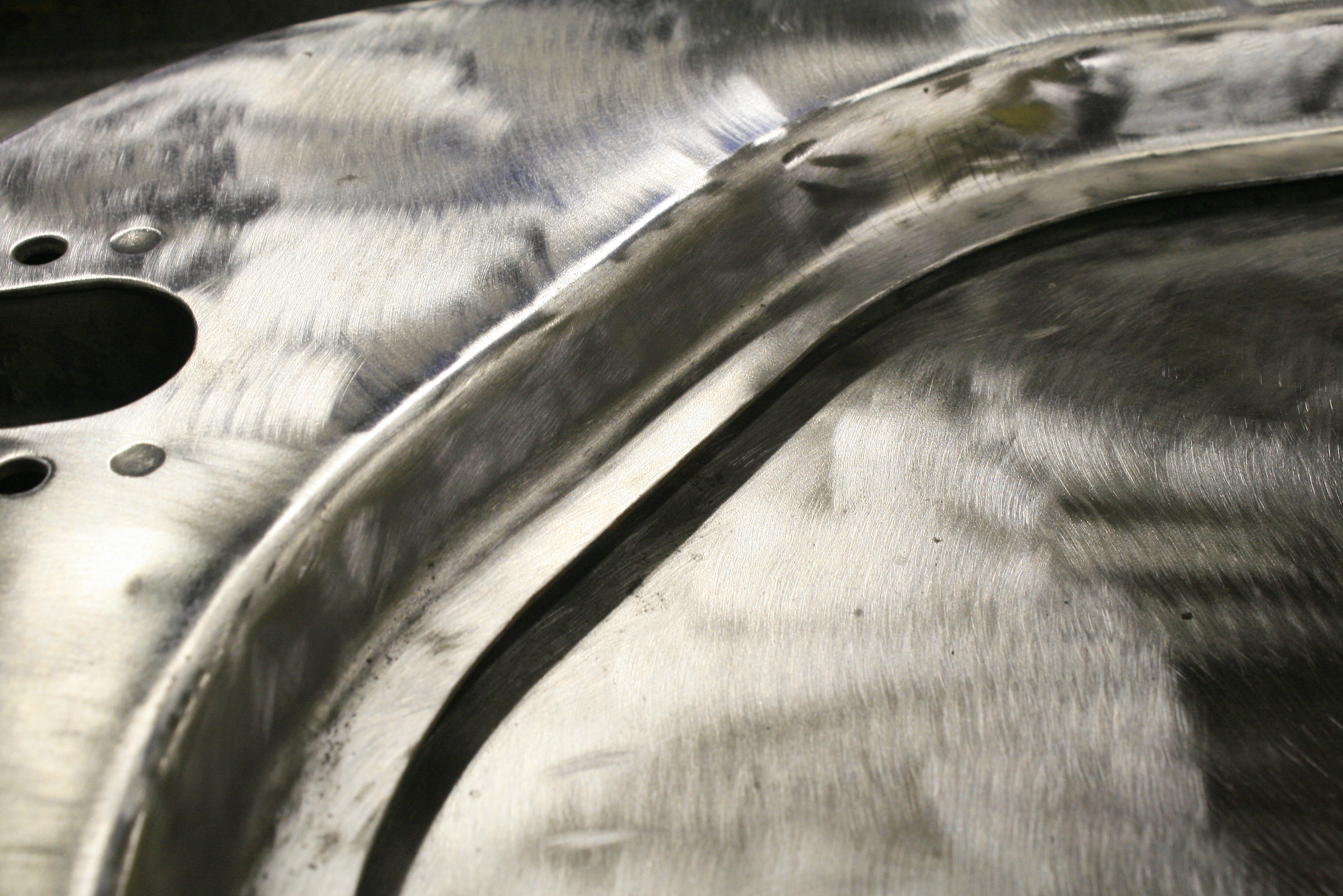

Posts: 368

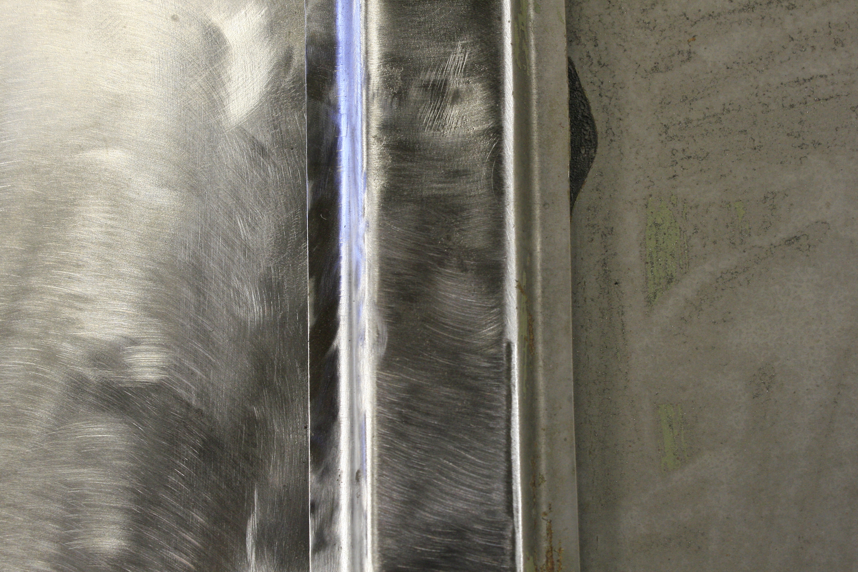

Posts: 368

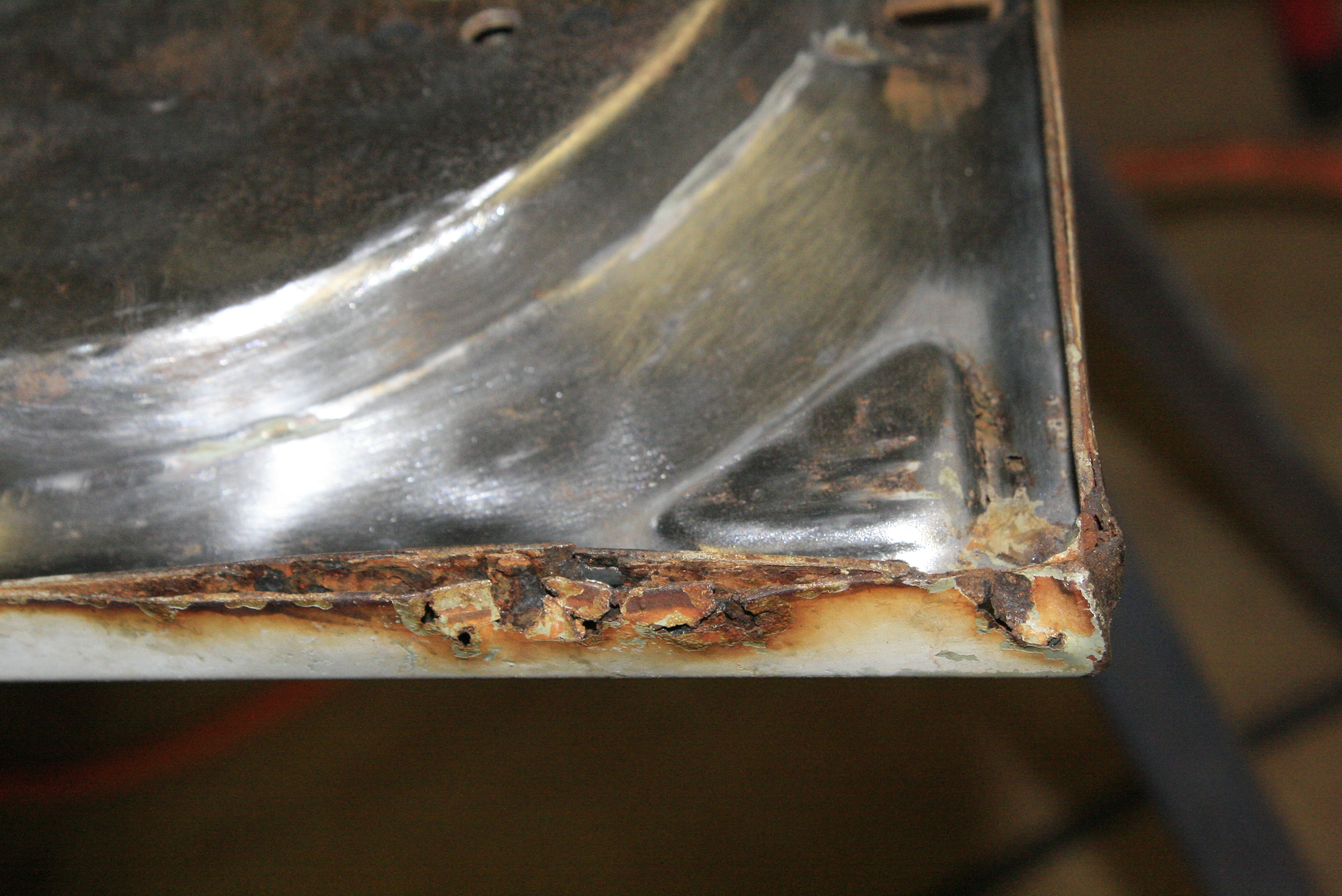

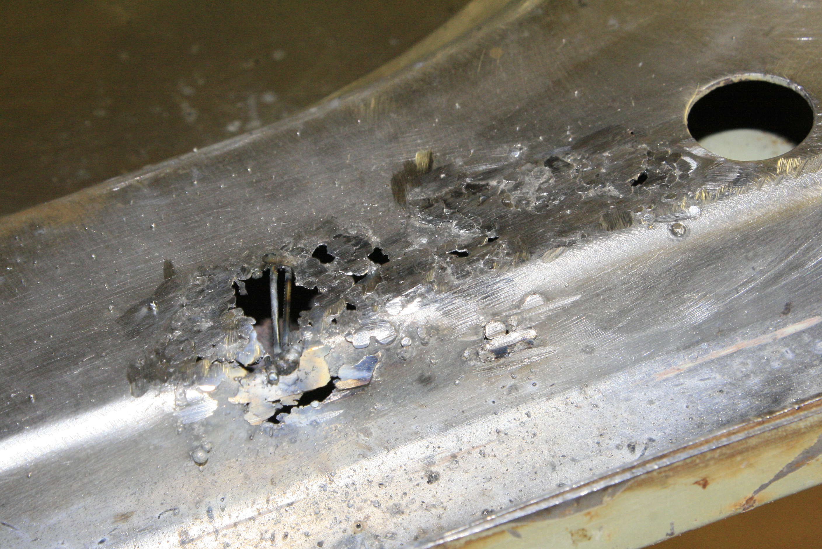

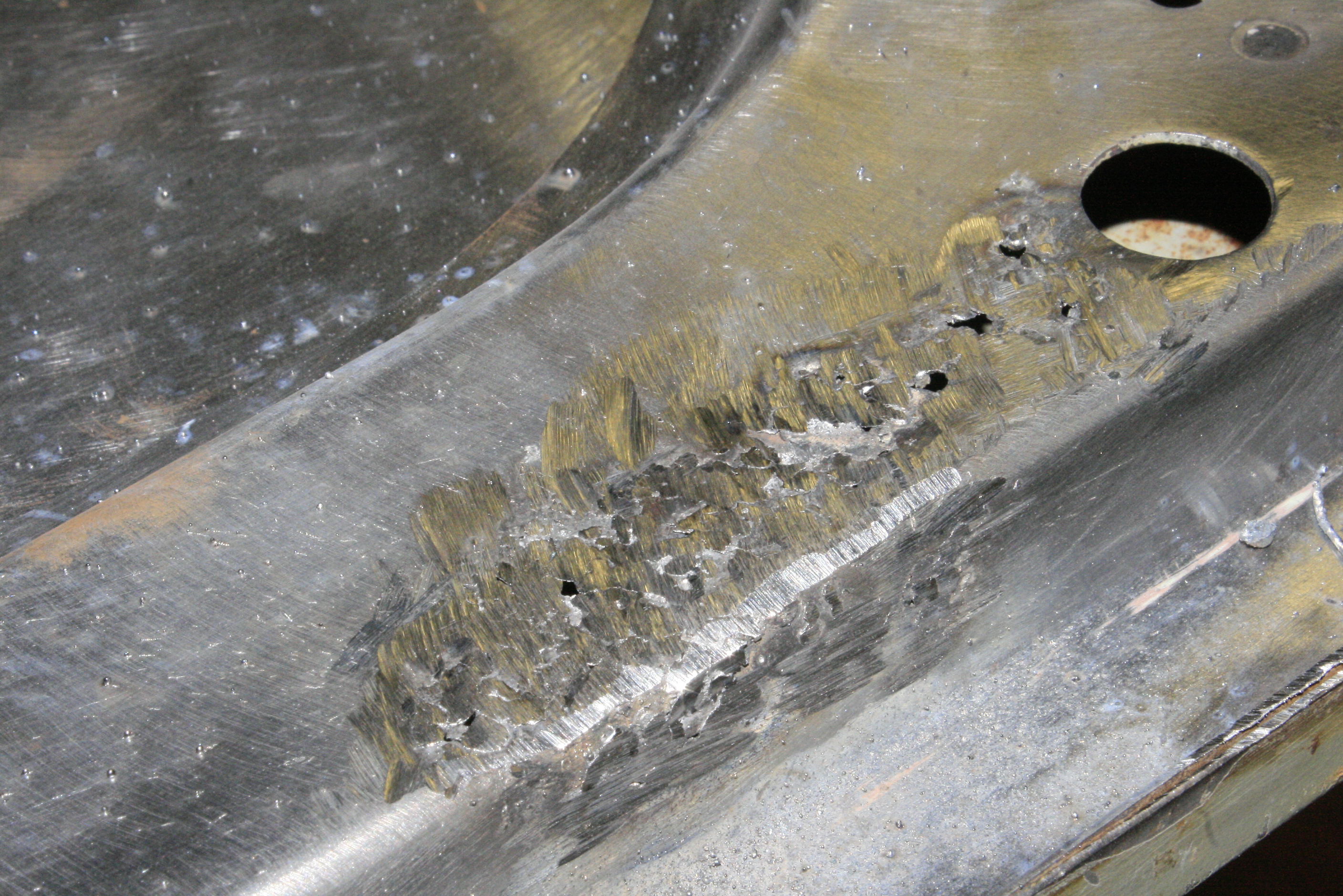

.Some Rust Repair.
Ted Freeman
Thu Feb 04, 2016 5:09 am

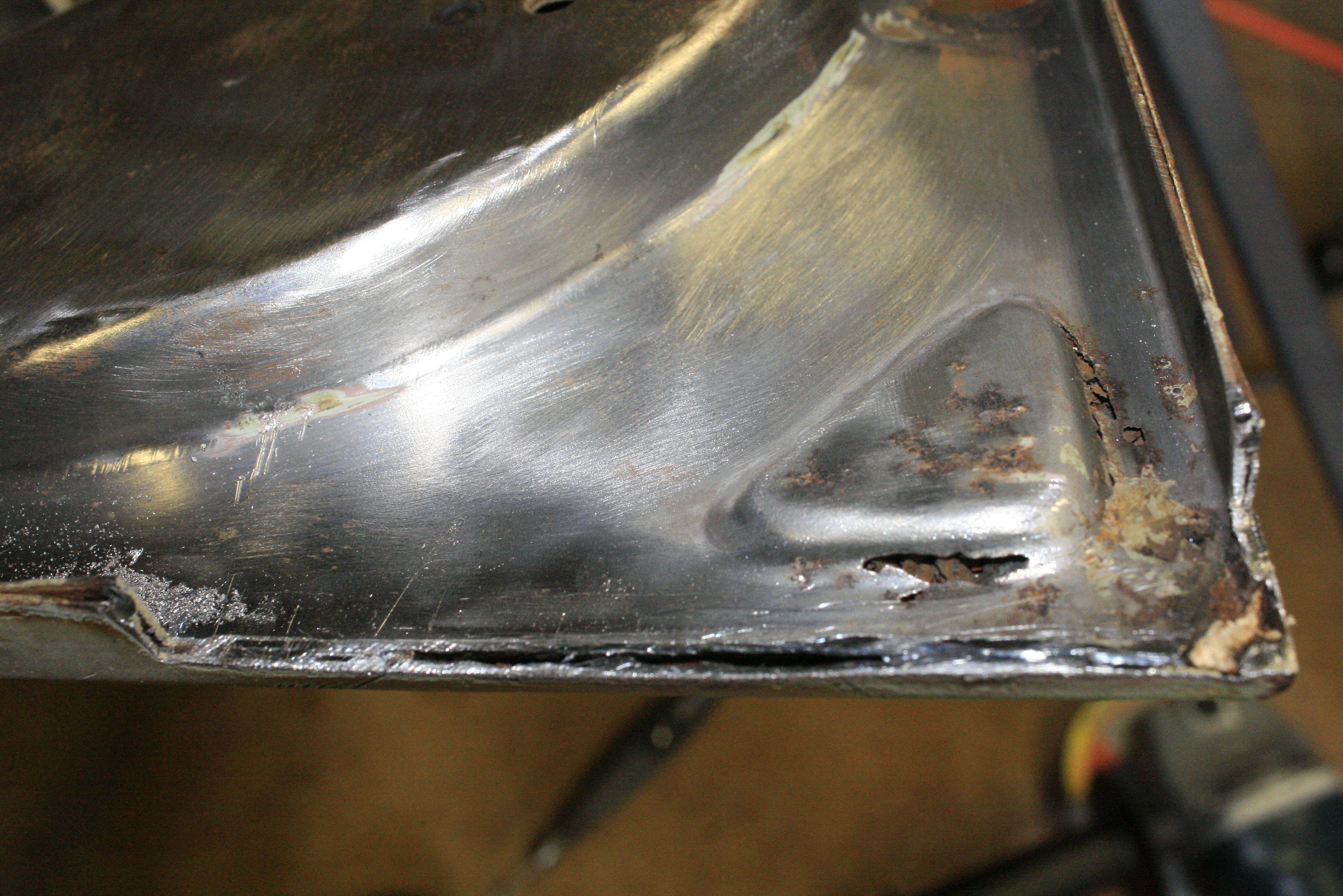

..Not The Best But I'm Getting There..

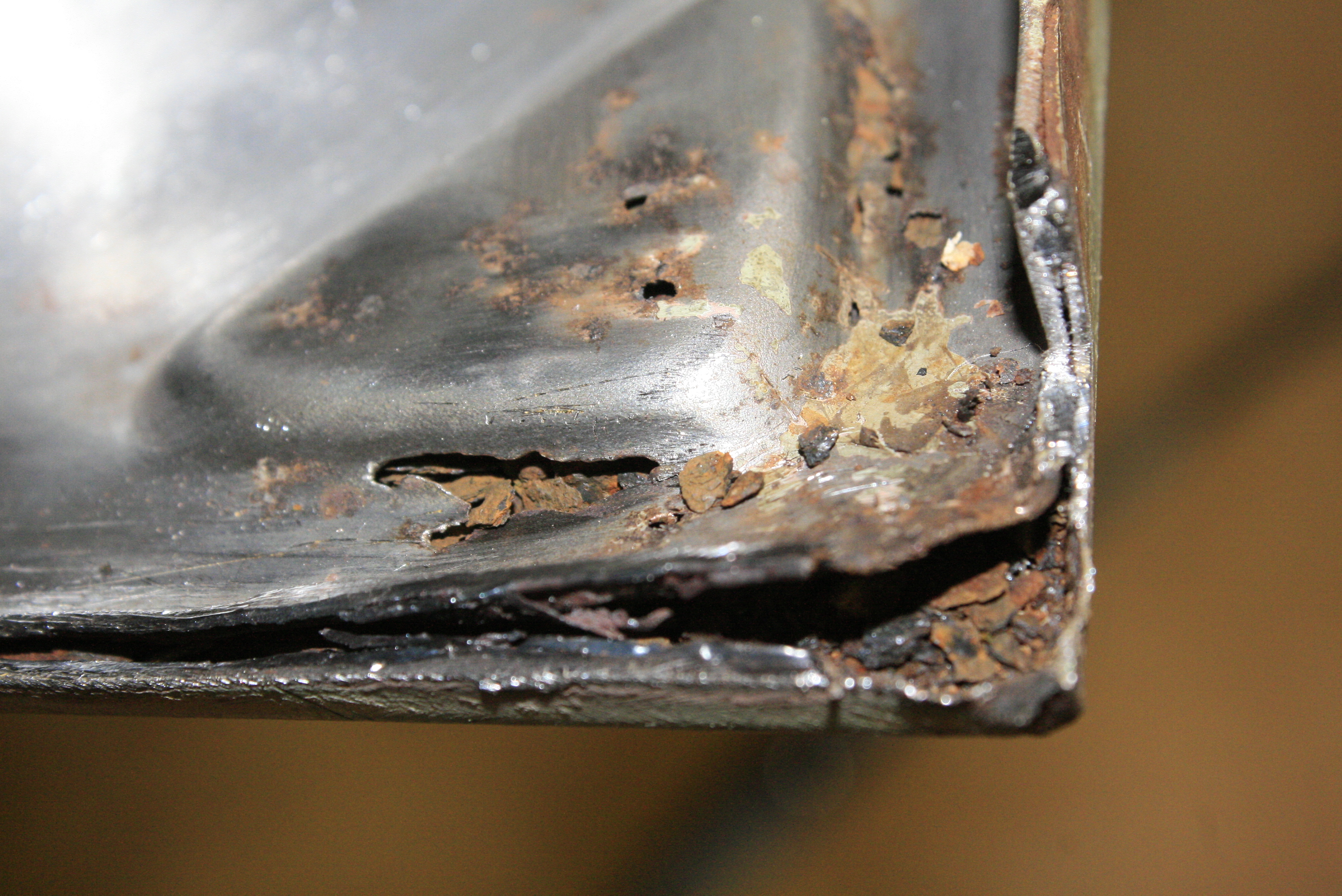

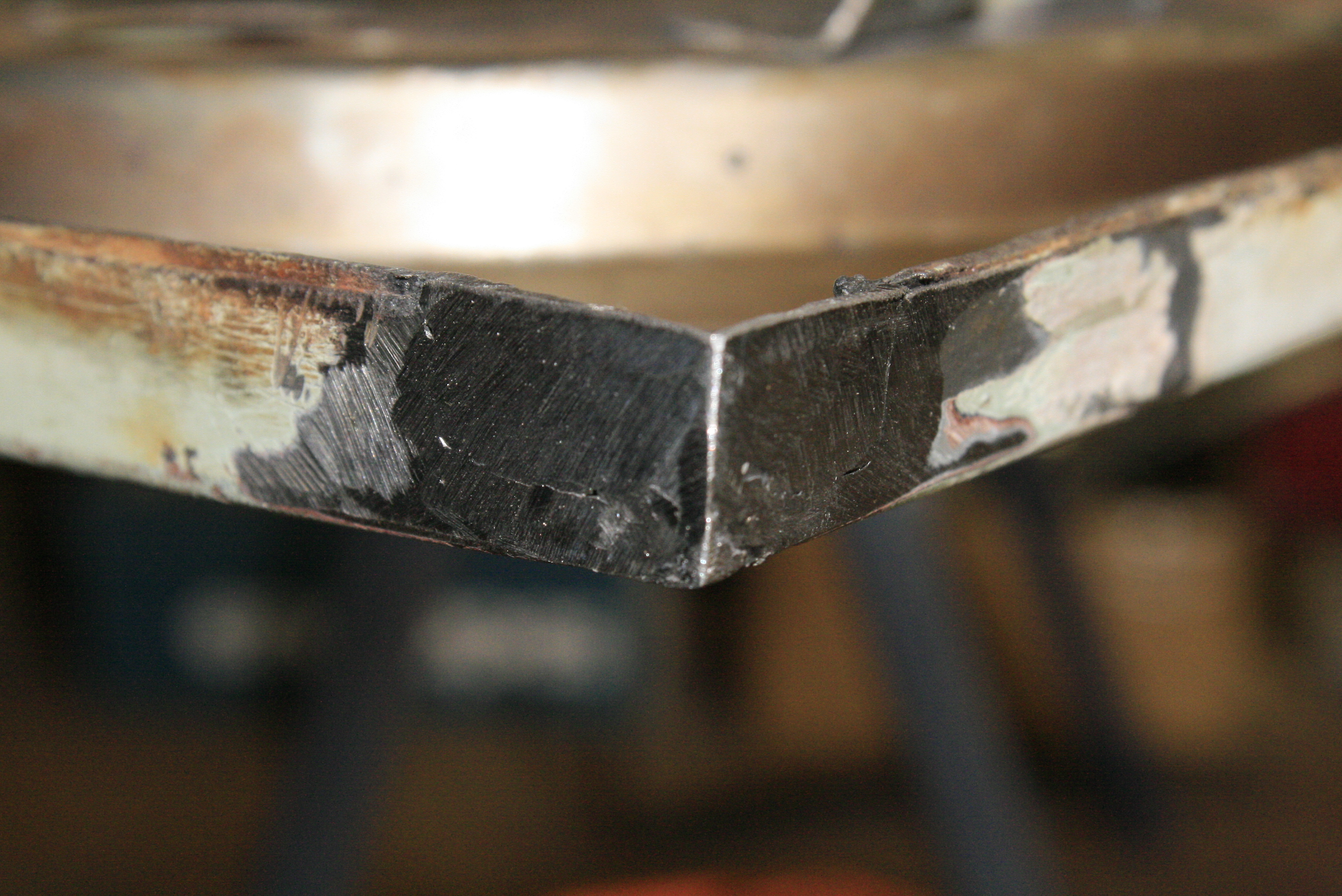

Posts: 368

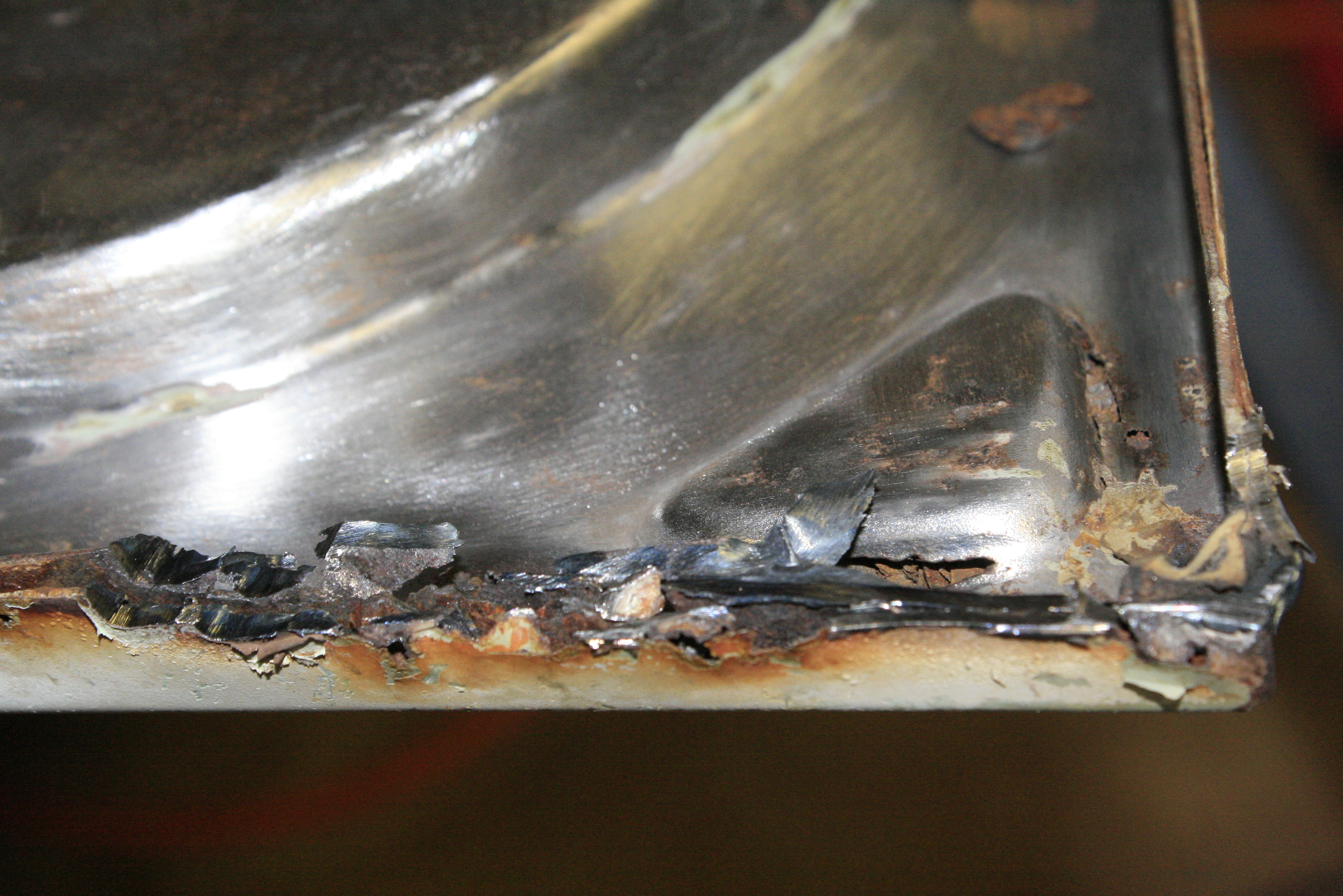

.....Replacement Of The Boot's Corner Was A Must, Still Not The Best Welds But I Will Keep Going Over Until Correct,So This Corner Still Needs Some Welding To Sort Out The Seam's, (Dad & I Picked Up A 2x4-Foot Sheet Of 1mm Cold-Roll Steel) More Then Enough To Do What We Want.....

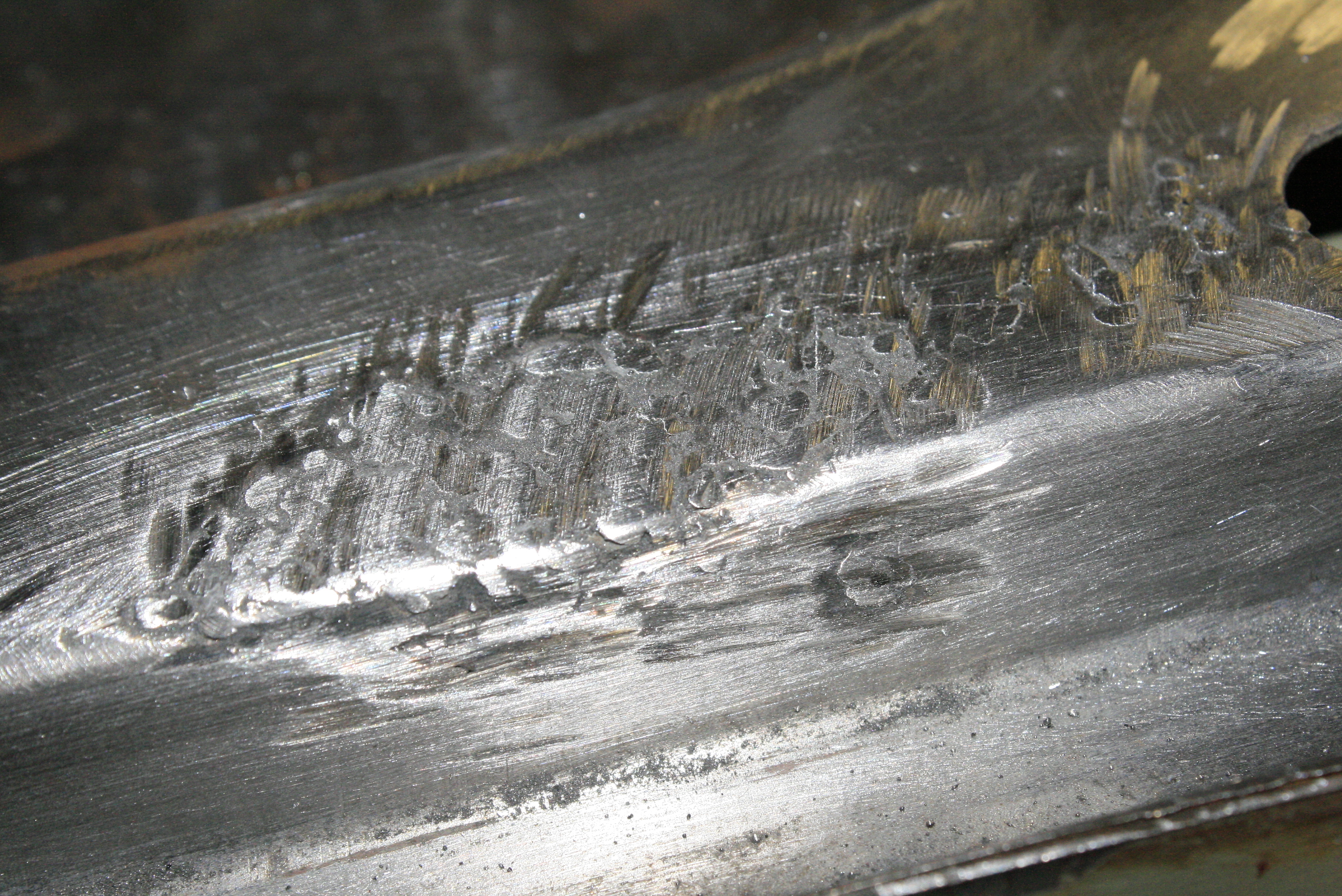

......The Other Corner Has Far More Rust Damage In It......

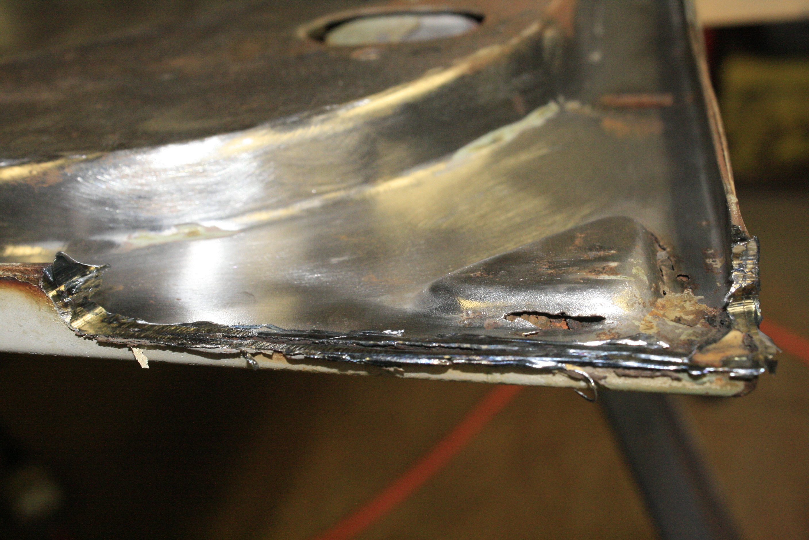

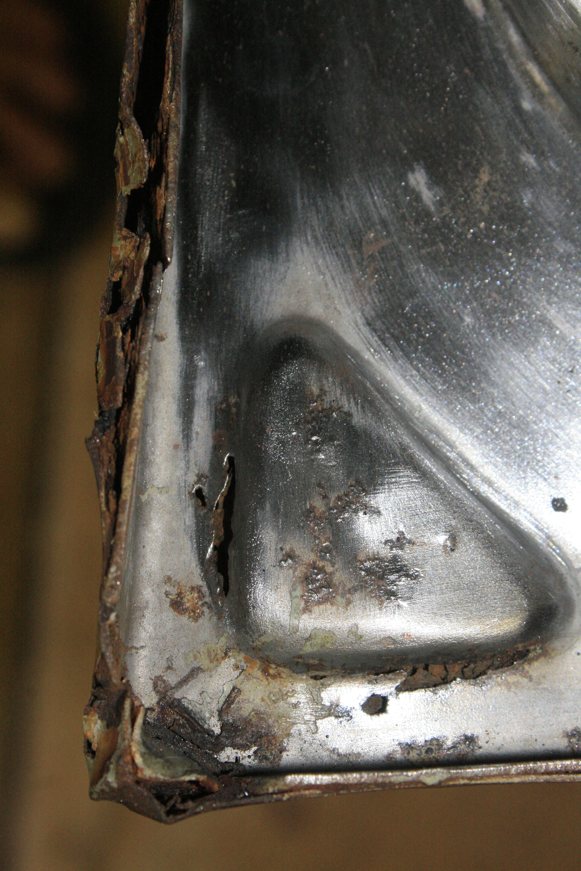

........Grind Her Back A Bit........

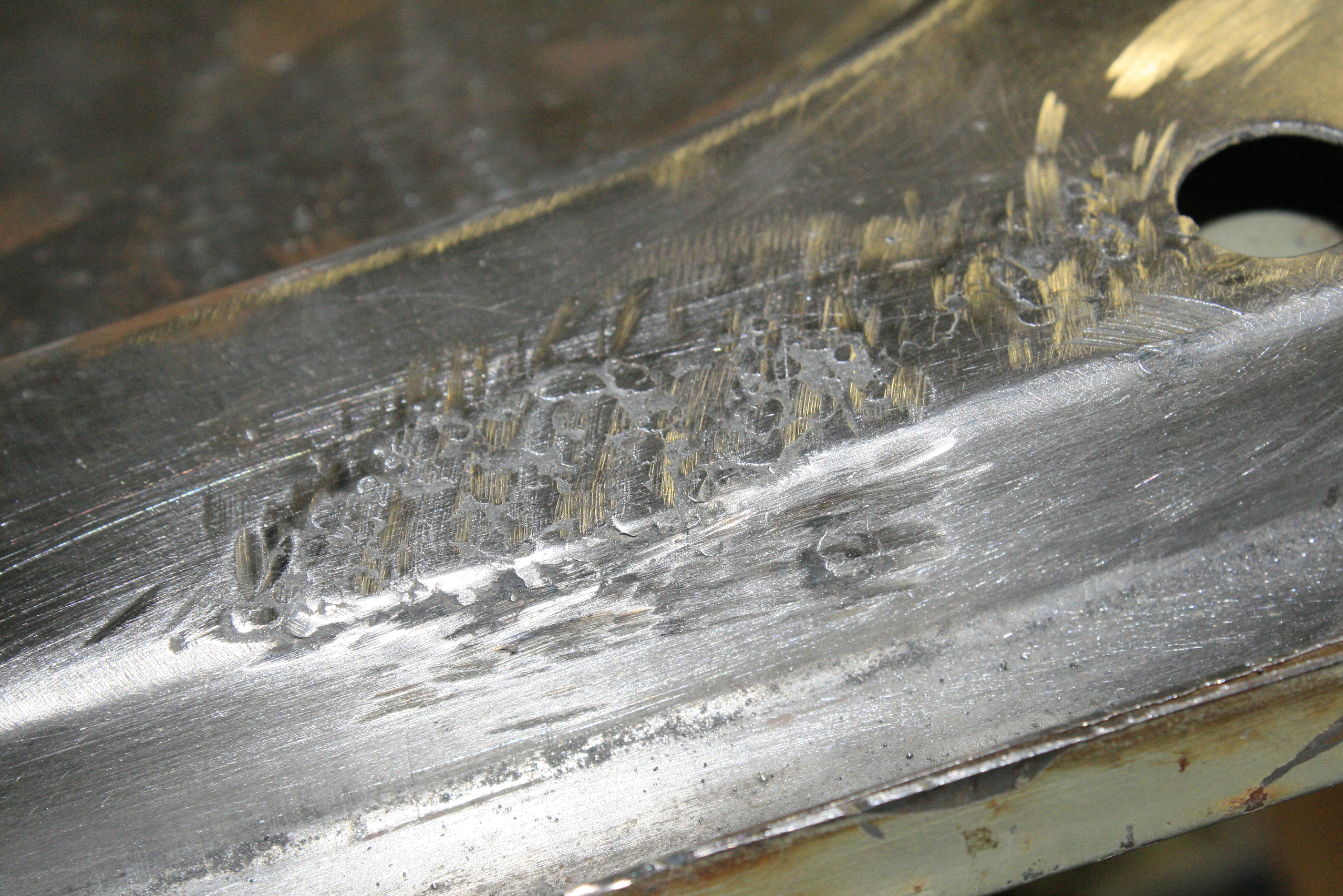

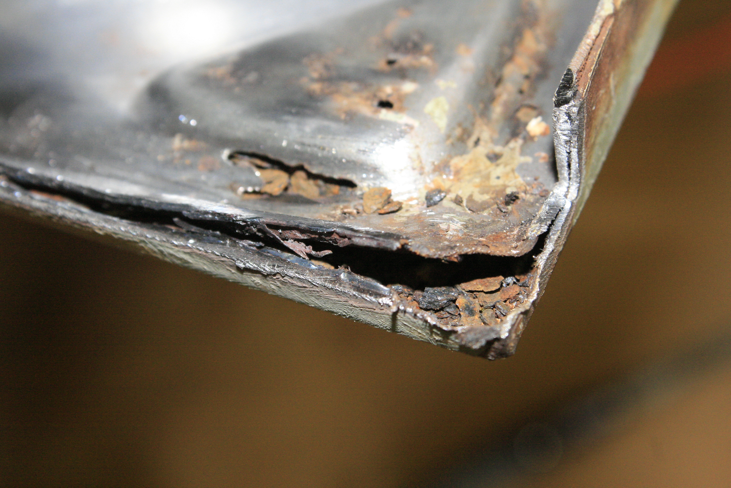

............I Carefully Pulled Back The Inner-Skin So To Tap-Out All The Rust Flakes & Crap Which Can Be Seen Through The Rust Holes, All Up There Was About 4 Heaped Table Spoons Worth Of Rust Flakes & Crap That I Was Able To Get Out............
