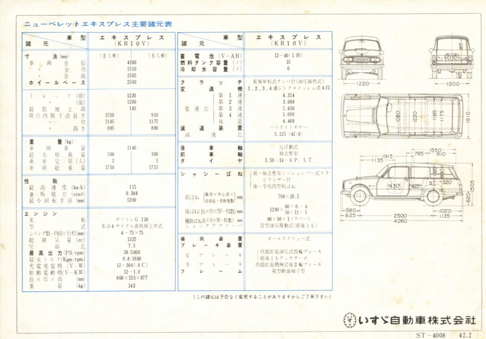

Finally here's Isuzu's all-important specs sheet. While the KR10V Express is shown as being a 1300 only, it's possible that Isuzu offered a KR20V Express 1500 version much like the Wasp (at least in Australia the Wasp KR20 1500 was the only version available), however so far we've not found any verification on that.
Aside from this brochure, the Bellett Express remains an elusive beast with only a small black & white promo photo being the only other sighting we've had so far. If you find any more details or real-world photos of a Bellett Express, call the authorities immediately!
Or perhaps it's already extinct....
