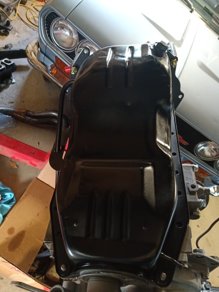

Depends on what sump and dip stick tube you have.... there were 2 or 3 different ones.

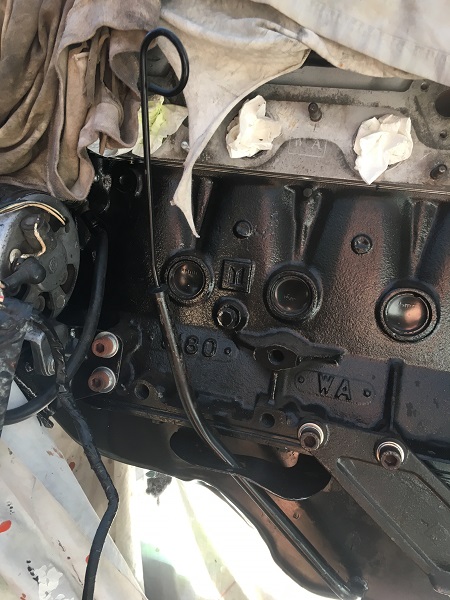

I have this type sump. Or does anyone know what other dipstick would fit this sump? One i could cut down to suit that will just fit the tube

Try a Gemini stick. I think the rubber sleeve is the same size and the length should be close. A tape measure will confirm or deny.
But make sure it's the same style Gemini sump.... because they had a couple of different ones as well.

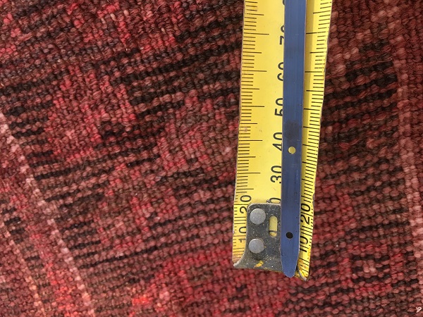

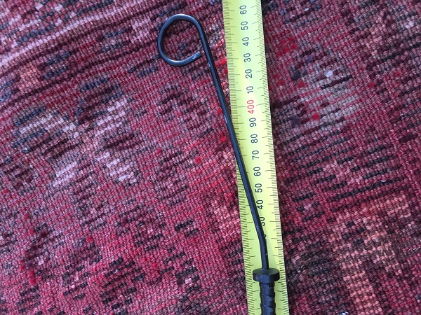

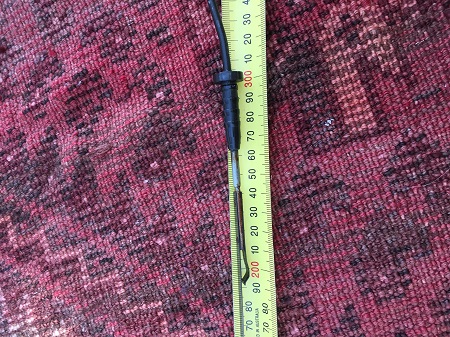

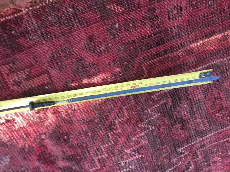

Waldo
The Dipstick is 300 mm long from the tip of the stick to the inside base. The high and low marks are 15 mm and 40 mm from the tip.
The blade looks about 5 mm wide and the stopper is about 8mm in diameter.
Hope this Helps
