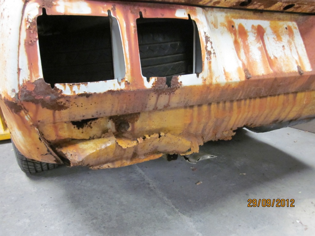

you can make one at home, tedious maybe, but can be done. I did one on my GT (now Daves) I replaced about 2/3rds of it from the bottom where the main rust is, upwards.
Any decent bodywork place though should be able to do it also. Time is money though.
Heres a good one :( :(

most Belletts i have seen get water down in that area and of course they rust. Same with the bottom of rear quarter panels as you know.
What i always do when replacing these sections or evn those that are OK, is to open up the crappy (tiny) weep holes in the bottom and i also add more to let the water out hopefully.
I open them up with a largish screwdriver, push it in and twisting a bit also trying to keep the 'expansion' on the inside so not visible.
To add more, do the same thing, push a screwdriver in selected spots between spot welds to make additional slots. Once all repairs done, add copious amounts of fish oil and let the excess drain out of the new holes !

That beaver panel certainly looks a hell of a lot worse than mine, but I have the feeling there may not be much of mine left after wire brush or sandblasting. I guess I'll find out next week when it goes in for a quote. :|

this one is pretty bad but most seem to rust only in the lower 1/3rd or so making a replacment simpler generally

Duane even if you found a good panel on the outside it would not be so pretty on the inside and probably to thin to weld anyway. new would be worth the xtra $

be careful he doesn't just plan to 'bog' it though...... it would usually need to be remade up to the bumper brackets at least buts not a complex shape anyway.

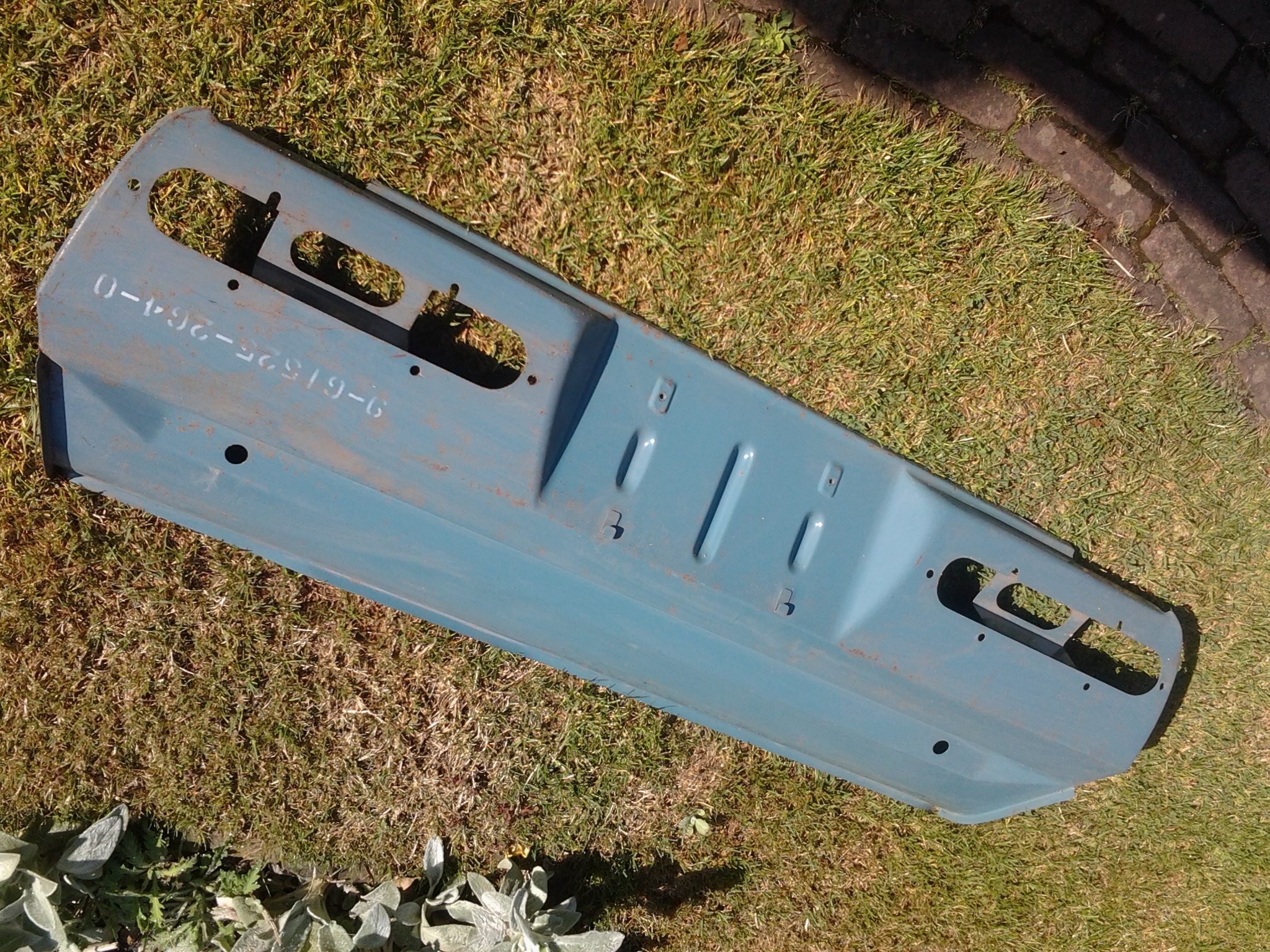

Found one .....

how much ...dick ....

Wow! Too new for me, unfortunately...or I could buy it and weld the strip light holes up. :P
Thanks anyway Dick! :mrgreen:

Posts: 95
Got them also with 1968 lights, sorry no teardrops.

How much are they, Dick?
thanks
Tue Aug 05, 2014 11:57 am
Posts: 95
I will ask the owner, will depend on how much of these panels he has in stock. Will get back ...

Dick wrote:
Found one .....
Dick, could you take a picture of the inside also please? I am curious as to how the panel is made. Especially around the bumper bolt area.
