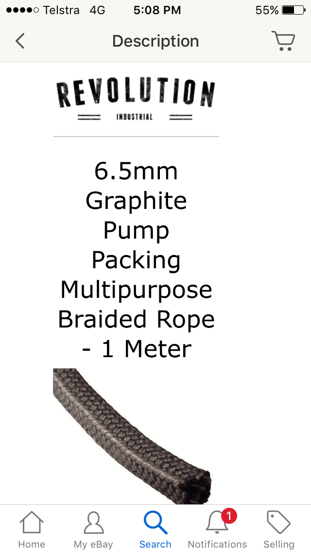

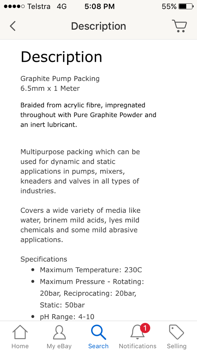

Hi All
For those looking for mains rope seals this may be of interest

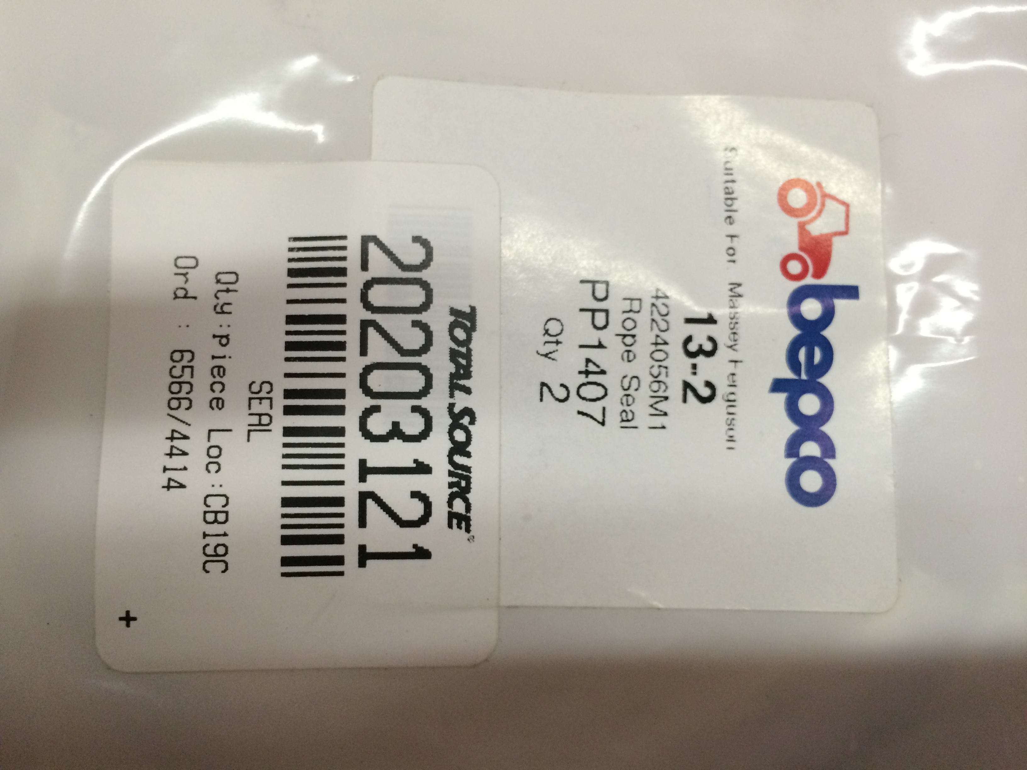

Or
Rope seal for Massey Ferguson tractor
PP1407
4224056M1

Asroc66 wrote:
Or
PP1407
4224056M1
did you buy the massey one? [ i think they are basically an english Vanguard engine]
Wed Sep 28, 2016 1:11 am
Yep, bought both
- graphite $28
- tractor $6
Haven't installed but both look good
I used. Graphite one when I rebuilt my most recent G161......
Only time will tell
