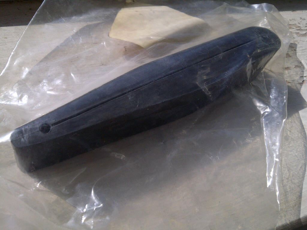

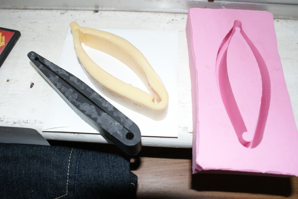

here are some pics of the first effort. Not quite warm enough for Urethane to go off as per the supplier but i am going to fit this to my auto engine that needs a lower engine re-fit.
It looks a lot different out of the plastic bag. So the side rides against the chain, not the top face.
It might be closer with a metal center wall with straight sides and the circle at the end. The curved walls to keep the mold stronger might not pull flat when the piece is installed.
This is one where measuring from the piece it fits onto is important for the inside dimensions.

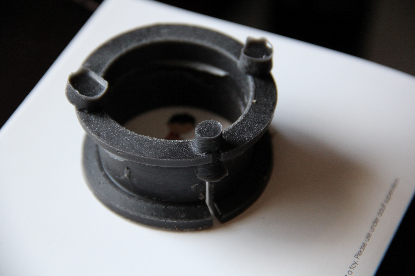

Have not had quite the time to get the new Timing chain, Damper and bottom end of my Auto going as yet, but i have been slowly progressing on creating other rubber components.
These often require a 2 or 3 part Mold to be created and thats usually the hardest part of the process. Once the Mold is complete, then pouring tests can be done. This then shows any problems with the Mold and, in the case of steering rack isolators, issues with air bubbles and the pour material not reaching all the internal areas !@#$%^&*(*&^%$#@#$%^&*
But i have now managed to get my first successful pour from the rack rubbers and here is a photo.
Will be fitting a set to the Grey Ghost as she has bump steer due to worn rubbers!!
the two protrusions on the left and right are fill holes and air holes. The center protrusion was made later to allow the pour to reach all the way around the shape of the rubber (another air hole effectively). These will trim off with a good sharp knife.
After a few more test pours i should have this down pat. And soon have a set fitted on 67 sedan.
