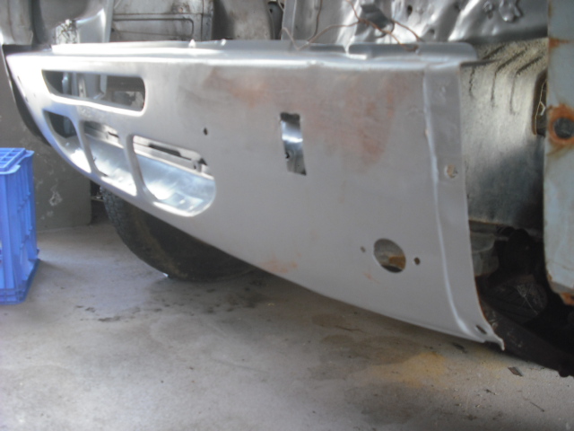

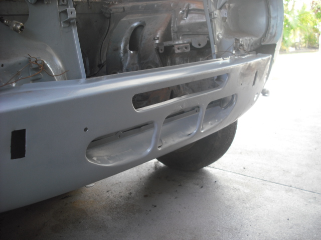

sorry matt im not clear I don't mean the little bumper stops on the gt I mean the rubber plugs that go into the front valance and the rear beaver and the bumper bar brackets slip through them ....I cant get a photo on here ...do you know what I mean about 65mm long cheers davo
Mon Nov 09, 2015 12:17 pm
back again just looked theres none on rear just 2 on the front valance sorry guys
Mon Nov 09, 2015 12:41 pm
the square holes

There's supposed to be a rubber in there??
None of my cars do......... I'll have 12 then please :P

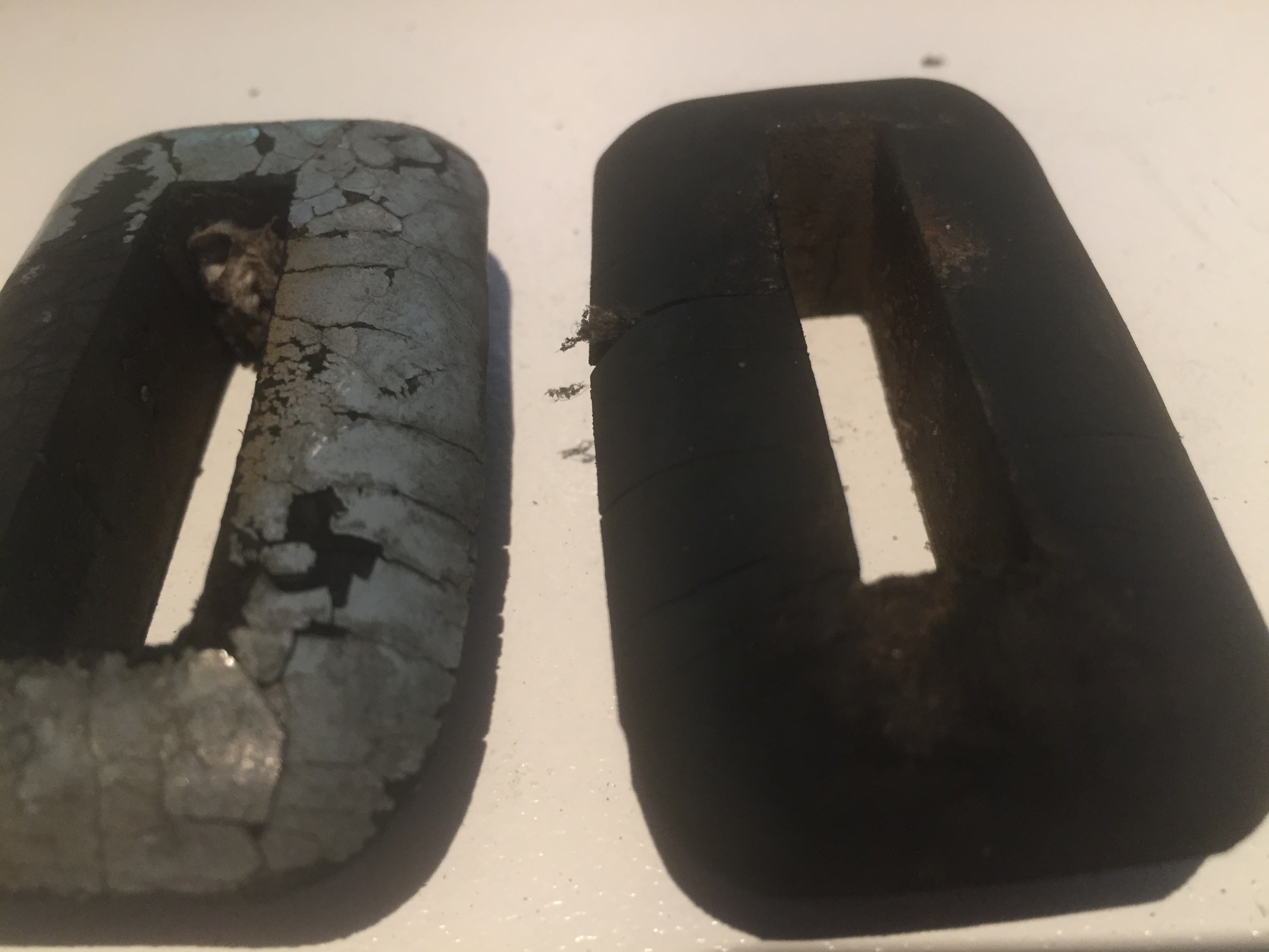

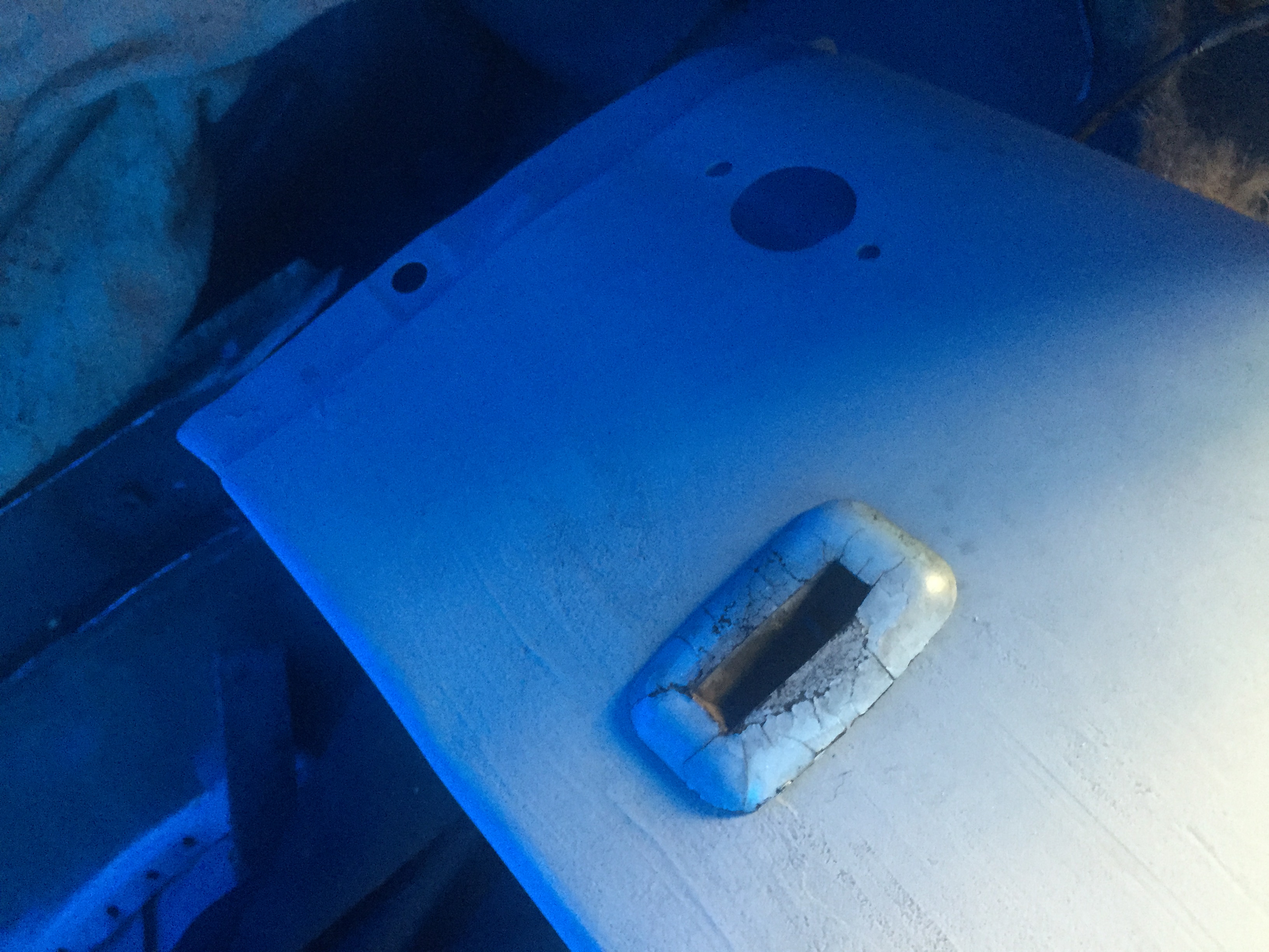

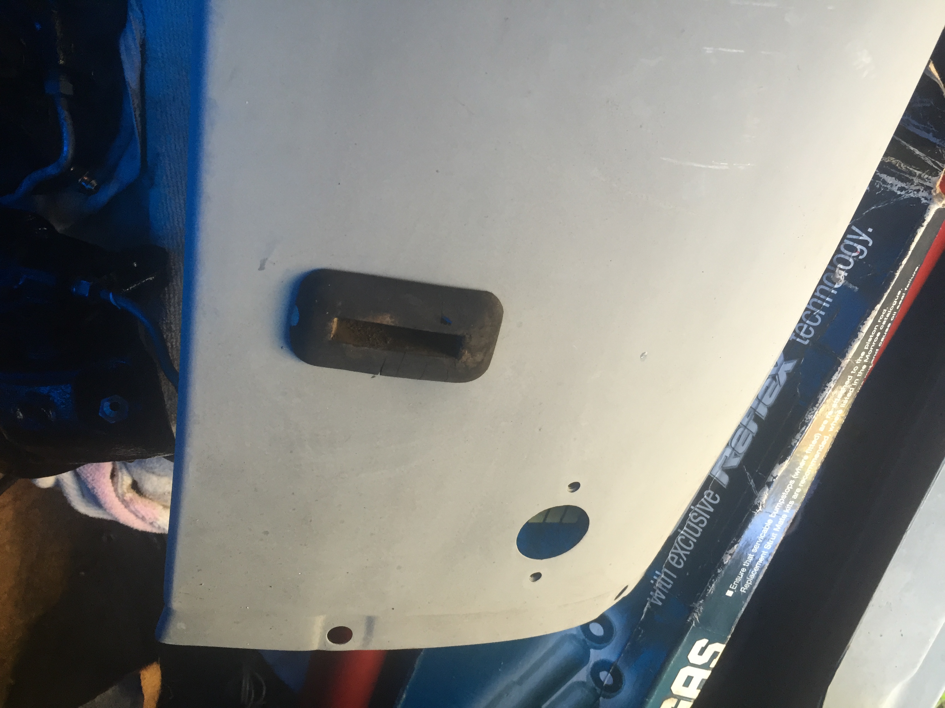

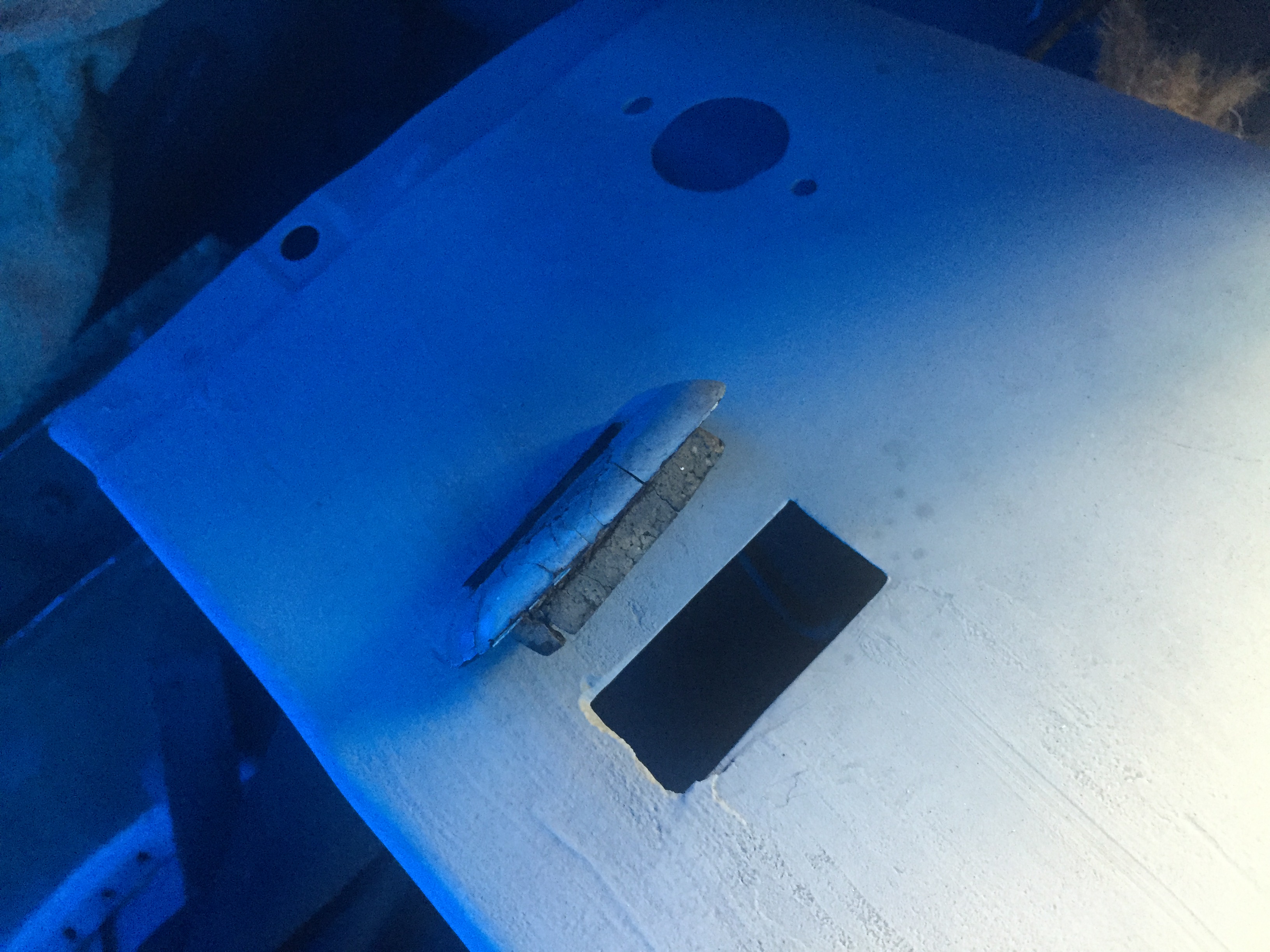

maybe someone can make these for the front pan they originally would have squeezed in now they are old and brittle bit like me :lol:

I get mine from the rubber shop they are a tail gate check strap rubber. I think valiant or holden ute? I cant remember. If you send a photo they will know.

The slot is angled in the rubbers that he has but they square up when fitted.
Tue Nov 10, 2015 11:31 am
thanks greg wondered why the angle .... were they holden I looked on scotts site you told me once one thing at a time ...im taking heed cheers davo
