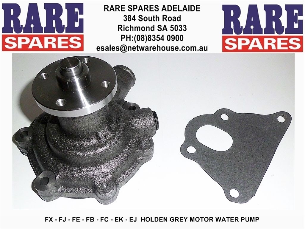

every time this comes up, i think of the water pumps used on a zillion Holdens with the Grey or maybe the red motor (or black) and think those simple pumps might just be adaptable to a Bellett. Mind you I don't have either of them to compare and see if that's feasible.
Depending on the height of the Holden pump, an aluminium adapter plate might work ? eg a plate 10mm thick, drilled to Bellett holes and countersunk bolts used to screw to Bellett block, then tap the plate to take the Holden pump. All assuming the water passage would line up or close enough.

File comment: FX to EJ Holden water pump

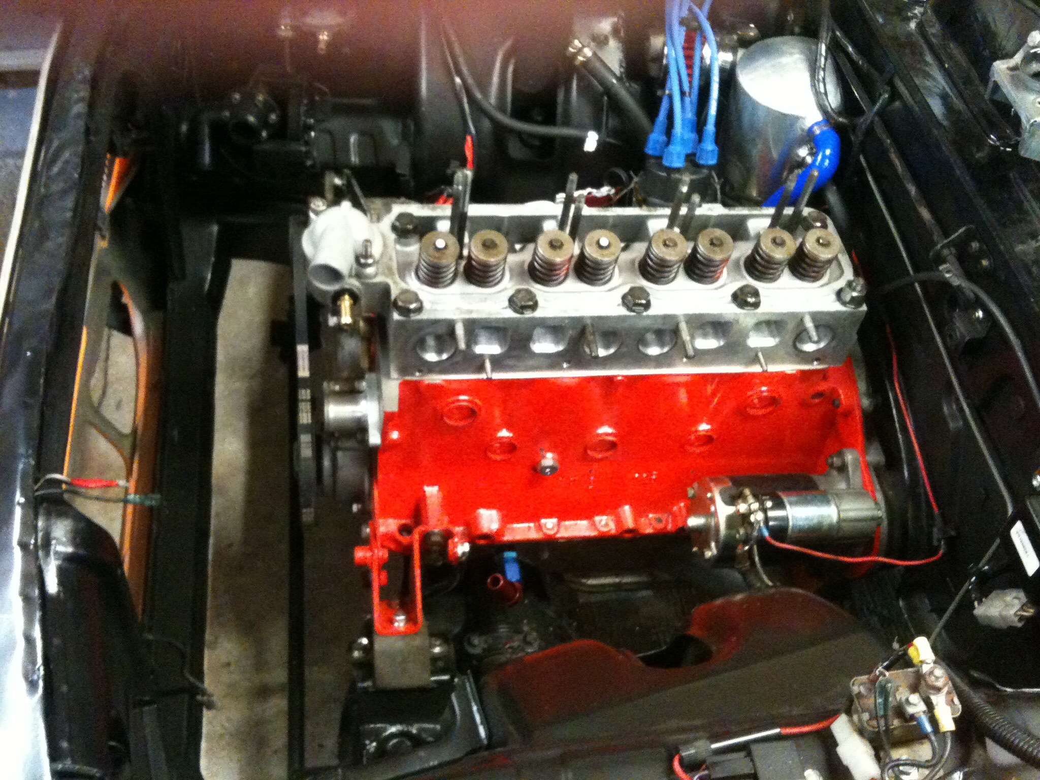

hi Josh
Here is one I prepared earlier
8mm aluminium adaptor plate with 35mm water hose fitting replacing mechanical water pump
In top of picture, driver's side engine bay is Davies Craig electric water pump
I ran an inline water temp switch in the upper radiator hose.
13 inch electric fan (take note the fan suck a lot of amps)

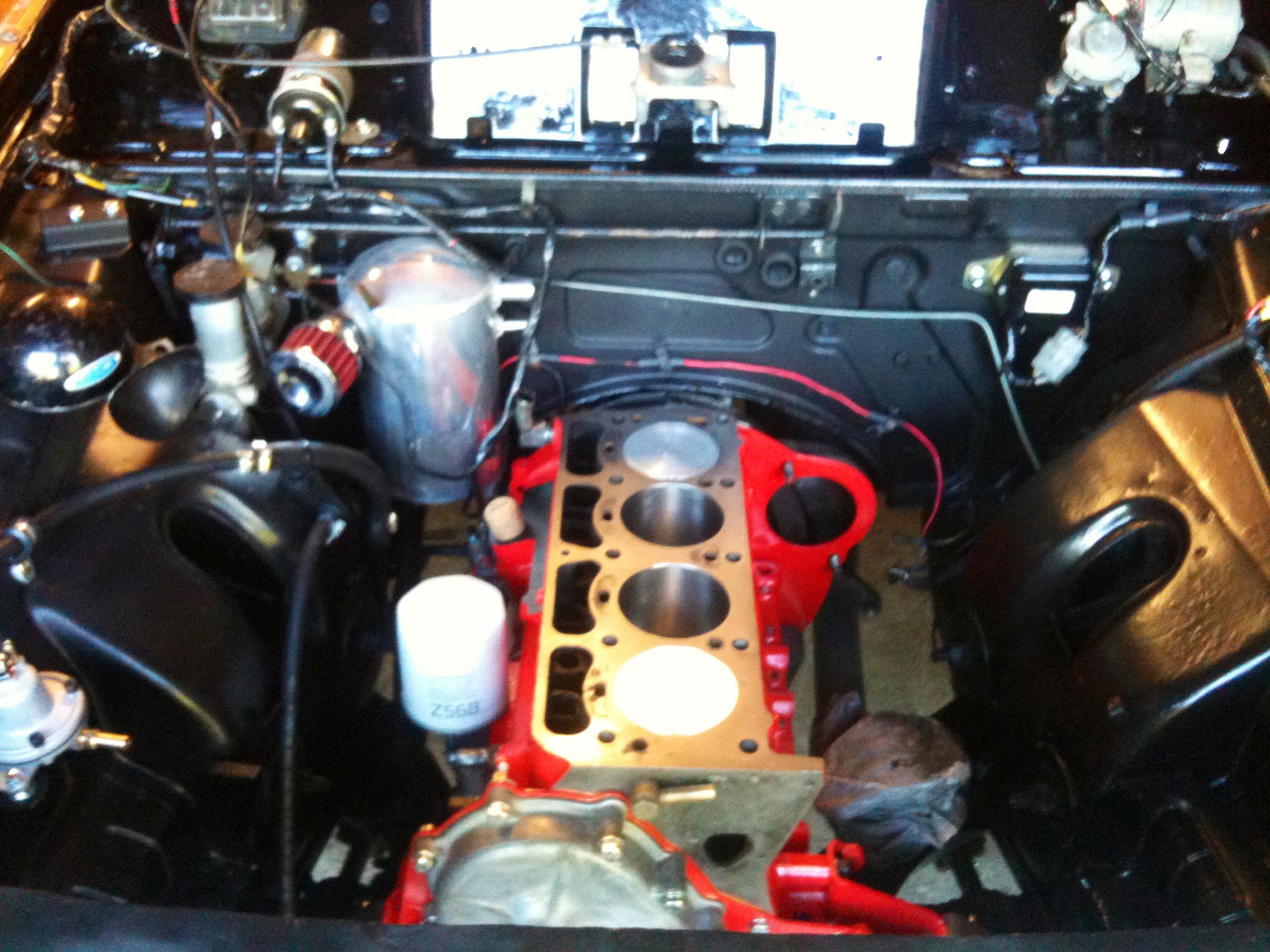

Three words
Custom, custom & custom
You don't need to run a bigger generator/alternator
Just a dedicated circuit with relay much like with spot lights
Trick to be aware of, there is a 10mm hole from the front of the block...
Do not blank this off as will lead to a vapour lock / hot spot and then gasket problems ie blown head gasket
If you look closely at the origional pump backing plate you can see it.
This needs to be plumbed in somehow when you change to electric pump
I tapped the hole and
Mocked-up a banjo bolt, however I settled on a AN fitting for quick release
