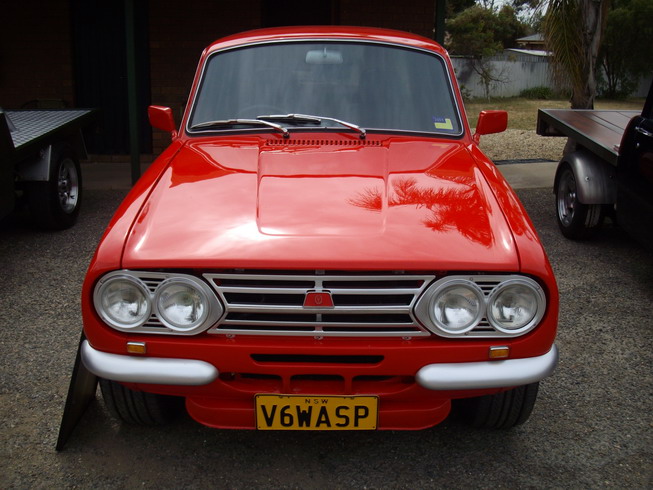

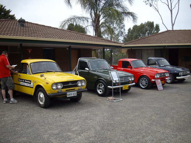

FRONT.

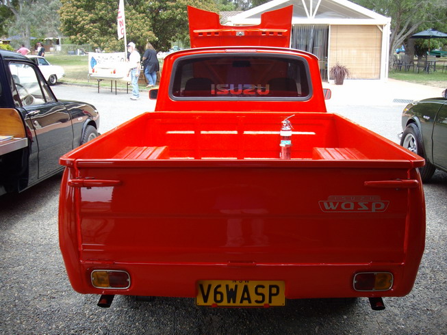

BACK- All holes closed up. Badges replaced with screen printed transfers.

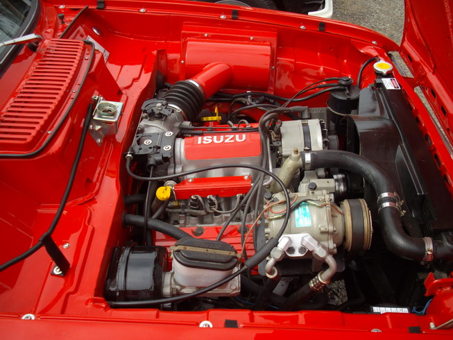

ENGINE BAY.- 3.8 lt VP Commodore V6. Airbox plumbed into leftside vent tube for cool air intake.

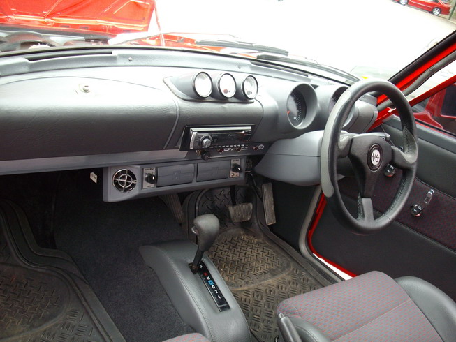

DASH. Instant fridge Aircon. Collapsible steering column.

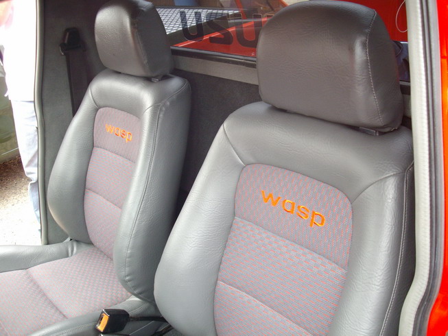

HONDA INTEGRA SEATS. Covers removed,"WASP" embroidered, then refitted!

Only side-on pic
