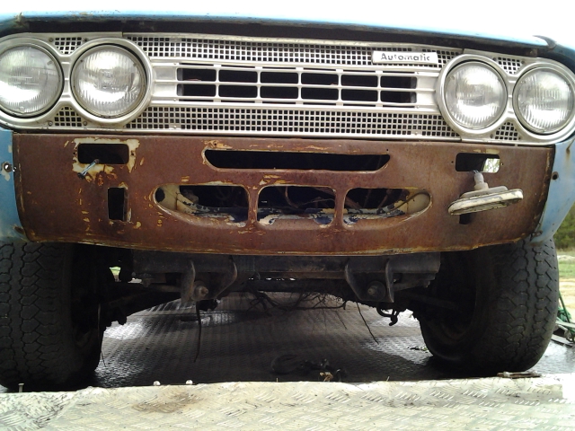

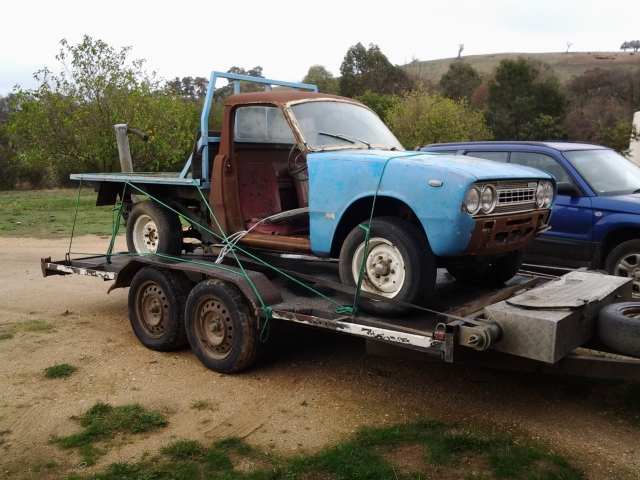

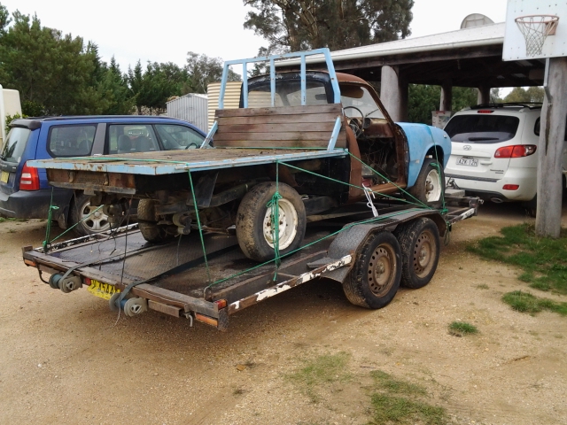

Home!
Check out the straight skirt/valance! Gotta go unload him and get a better look!
Excitement!

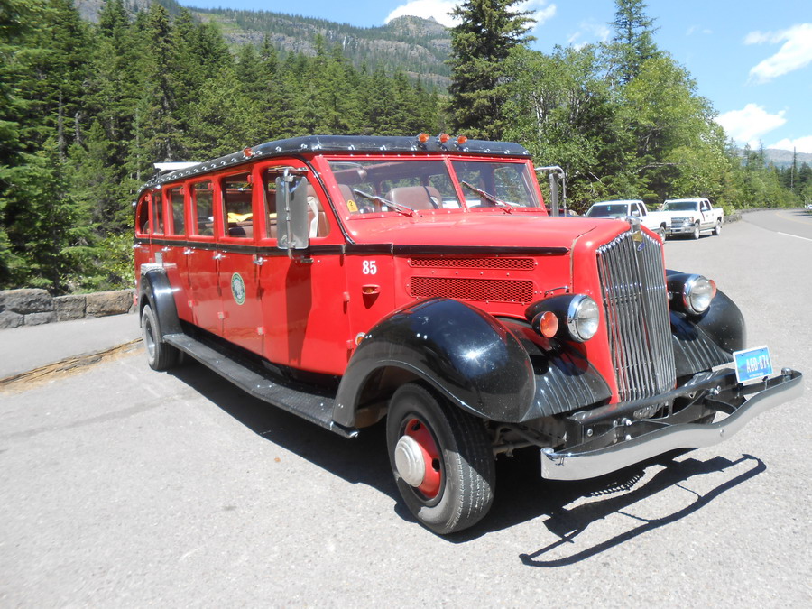

I realise that the LUV chassis is wider . . If the cab is lifted a couple of inches it gives you room to fabricate some offset mounts and also generally makes it easier rather harder to modify and make other bits fit. Fixed size cabs onto different width chassis' has been used by truck manufacturers for many years. Locally Bedford, International, Dodge in the past and Isuzu and others still do it today . It is a cheap easy way to utilise existing parts. Just recently I saw a 1935? White multi door bus body fitted to a current model Ford (F350?) chassis and running gear. A Wasp with a lifted cab and wider track as well as 4WD would look pretty tough.

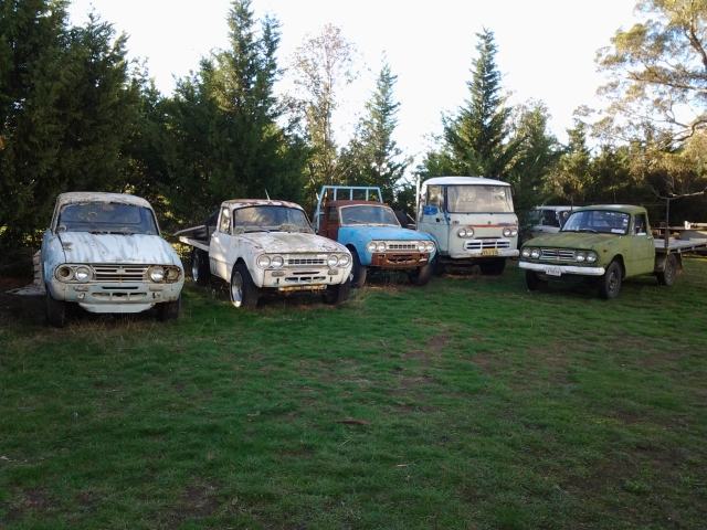

Hanging with his mates, catching up, and no doubt bragging about the huge loads they dragged "back when I was a young fella!"

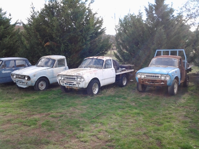

Ironic that he should have an automatic Bellett grille, and is just 22 units older that the white one on the chassis number.

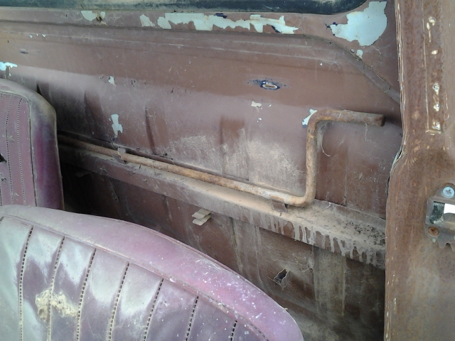

Will you look at that...
Original crank handle, still in place!!
None of the others have theirs. Its longer than a Bellett one to reach the spare wheel carrier.
Having a closer look, the floor is 100% solid. There is a tiny hole in the right sill, and a 7cm hole in the left one, but thats all. None in the roof or screen bed etc. I reckon someone was starting a tidy up, with the Bellett bits, but stopped after rubbing the paint off the cab. Looks bad, but its all just surface.

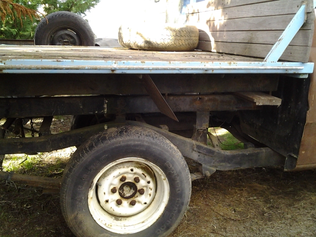

Its sitting up because its not attached. The mudguards are in the wrong place, so its up on wood blocks. After a clean up, it will go on Shrek, as his is cactus.

Speaking of Bellett Crank handles - does anyone have a spare one I could purchase please and info on where it was stored in the car at all please??
Would be willing to pay for shipping and handling too.
Fri Apr 24, 2015 9:23 pm
hi neal it is stored in the boot on the rhs there is a pic on here somewhere there are 2 clip holes the ones as you see in farmers wasp it runs in conjunction with the car towards the driver (hard to explain) also as you know you will need the dog on the motor should you wish to crank it ...the ''dog''i think its called screws into the crank pulley I have a spare one of those as my 90 has the dog if you need one ..got mine of farmer time back ..also you will need the swinging number plate ...I will look on here for pics cheers davo
